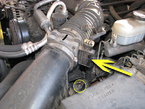

The yellow arrow is pointing at your MAF sensor.
Step 1:
Loosen the 4 Phillips head screws holding the air filter housing cover until you can lift the cover away from the housing (one of them is circled in the picture above). Loosen the band clamps on both sides of the MAF sensor.

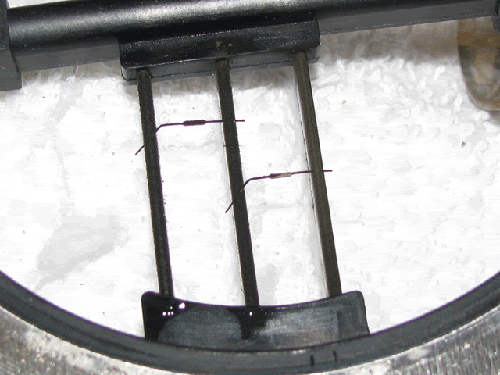

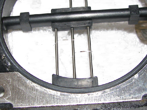

Use the plastic tube that comes with the cleaner; it gives you better accuracy and concentrates the pressure of the cleaner where you want it. Spray the MAF cleaner on the bars and wires in the sensor until you don't see any more debris coming off. This is just a rough cleaning. Now you will want to spray some cleaner on the end of a Q-tip and VERY GENTLY rub along the bars. Continue doing this with as many Q-tips as it takes until you don't see any more dirt on the end of the Q-tip.
NOTE!!!!! The little electronic parts you see connecting between the bars (pictured below) are extremely fragile so I chose to leave them alone & I suggest you do too. If you break one of the leads on these parts, stop cleaning and go buy yourself a new sensor.
This is what it looked like before I started:
This is what it should look like when you're done.
