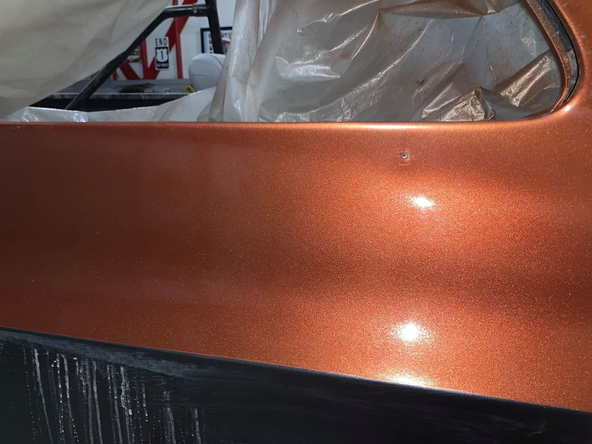

OK ... not too many glitches, should buff out nicely.
Now we can get the rest of it back together.

I probably will never piecemeal the paint job again ..... got into some noticeable color variations and will have to reshoot the copper color on the passenger door.

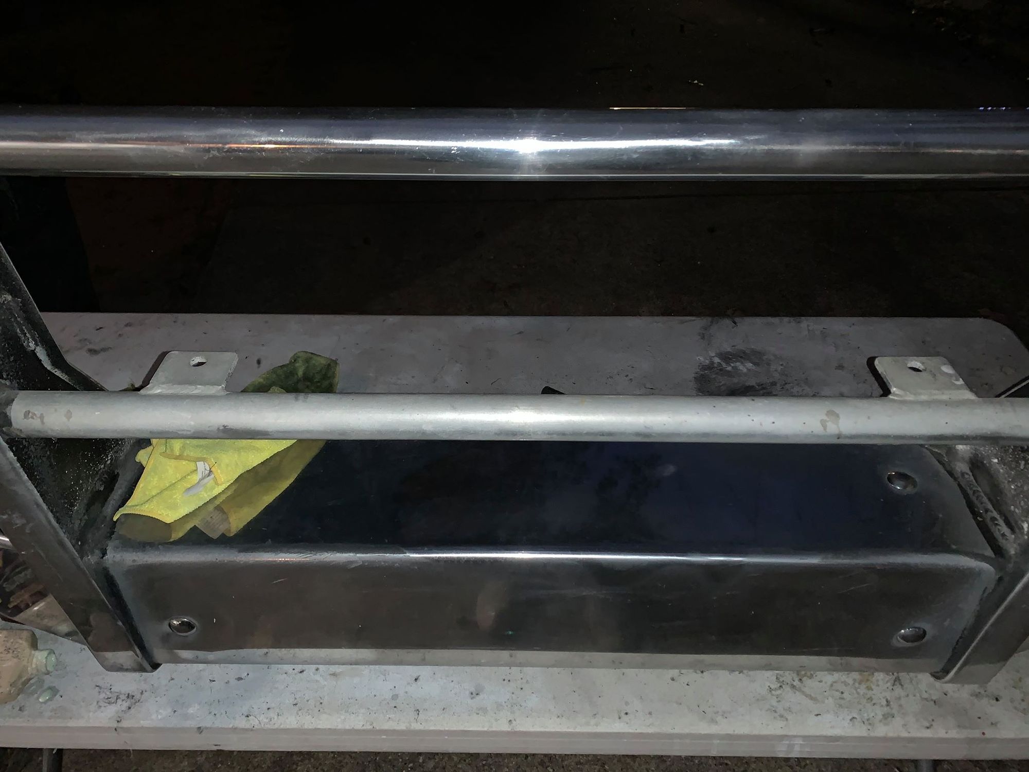

Aussie Bull Bar ... bought it back in the 80's.
Looks like I'll be able to bring it back to life with some serious polishing.
Its taken a lot of hits but it can be filed and polished up.

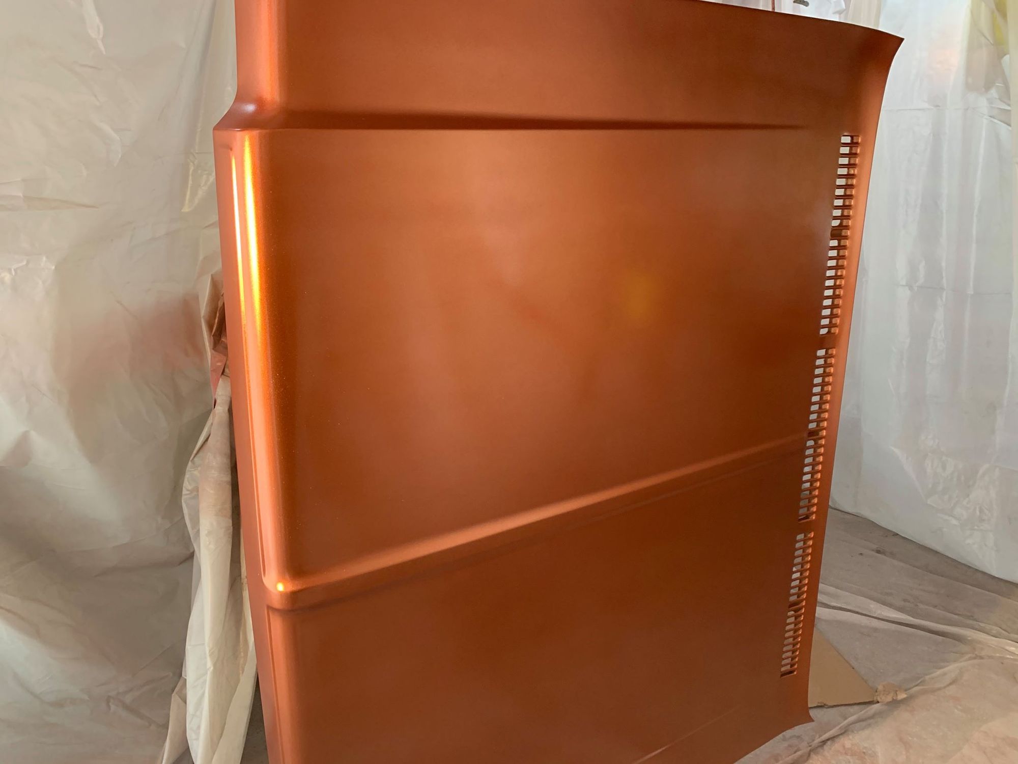

Finally got the hood painted, and started some buffing.
There will be lots of buffing of the DIY paint job. :-)

Buffing the new paint .... it ain't going well ... going have to add some clear coats.
On the bigass hood spraying all that flake is challenging.
Just enough inconsistency to need another color coat. And more clear.
And more color sanding. At $400 a gallon that's painful. But you know you gotta pay to play.
