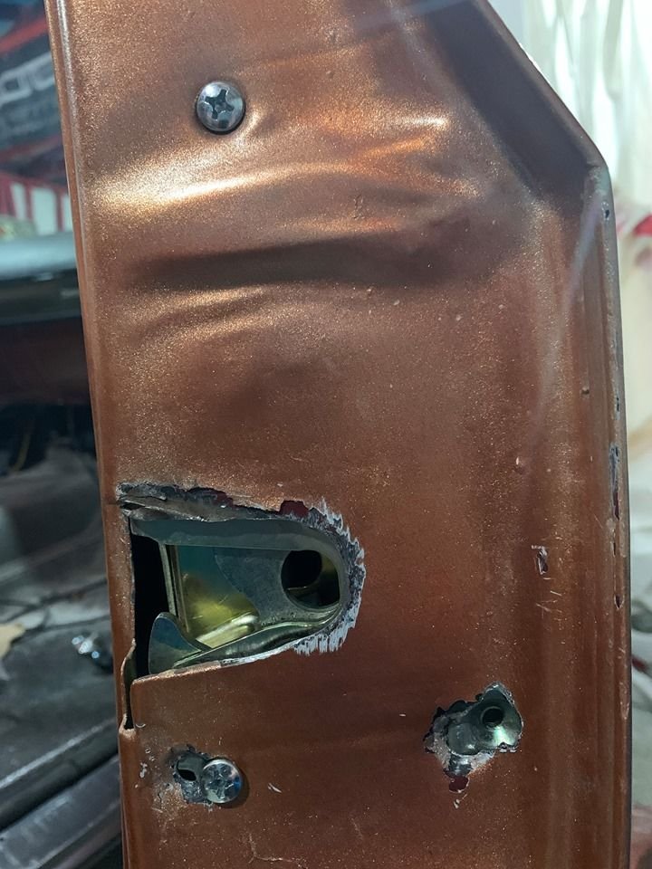

Well that was a strange afternoon spent on hacking up the passenger door.
I bought the dang thing back in the 90's ... no telling where it came from .. aftermarket of course.
I could not get the sucker lined back up after messing with it several times over the last few weeks.
After installing new hinge pins and removing the slop, it just got worse.
Out of desperation I started measuring the latch opening and bolt hole locations and comparing to the driver door .... it wasn't even close.
Holes for the hinge bolts were off just enough that it just couldn't be hung high enough.
(I guess with the old sloppy hinge pins I was able to just slam it shut ....)
So I bored out the bolt holes on the hinges so I could slide 'em up higher, and expanded the latch opening and drilled out some new holes for the latch.
I have to clean it up but it sure works well now.
F&@%$$*!)&**#^@*#

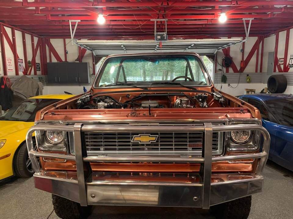

Well after a lot of stupidness like letting the metal flake plug up my paint gun and grabbing some mineral spirits instead of laquer thinner I think I finally have a good enough coat on this thing to buff it out and call done.
I ended up just shooting the whole thing to get the color consistent. Man.

30 years of dents, bends, gauges, and scratches filed, sanded and buffed out of the Aussie Bull Bar .... well a lot of them anyway.
Now that I'm trying to get everything perfect I may have to drill out the bolt holes on the mounting brackets because I'm drooping about 1/4" on the right side.
Just enought to drive me crazy. Dang.
