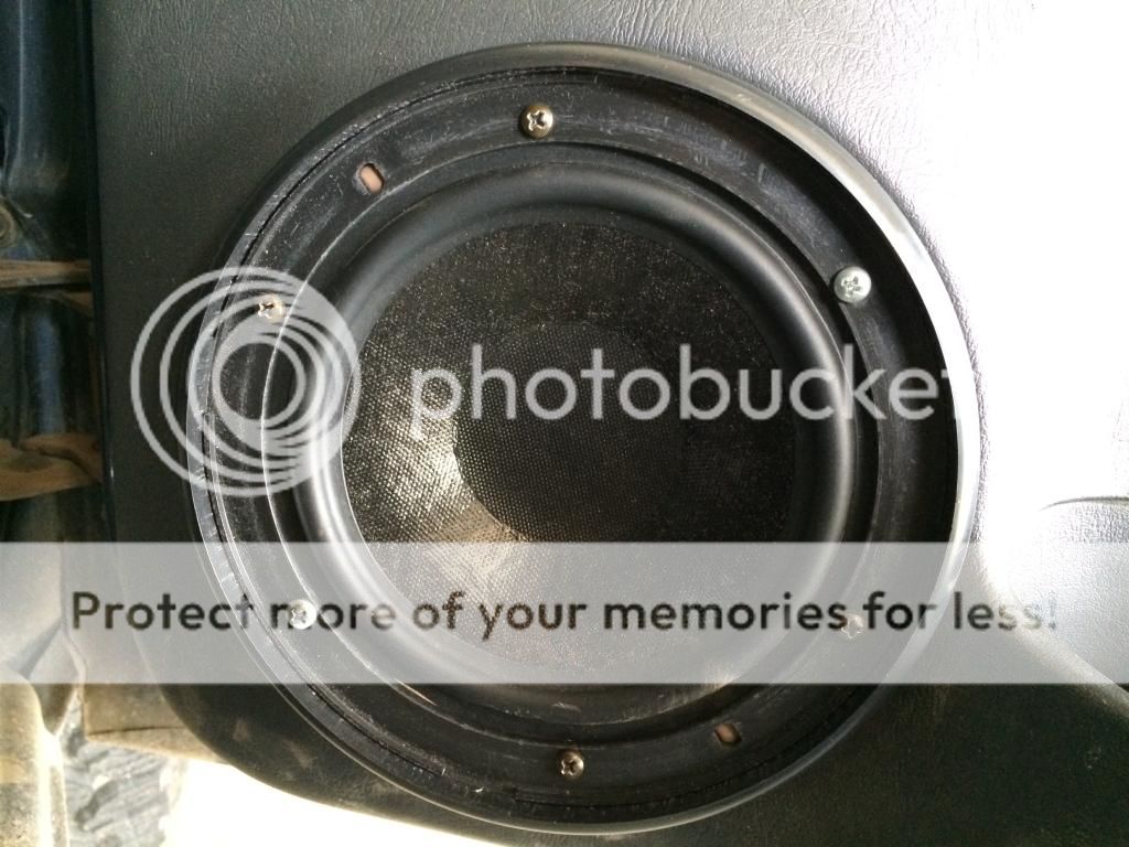

Little update. The Mach5 MLI's are absolutely unreal for 6.5" drivers. I'm about 100% sure I'm right about the harmonic distortion in the Bravox's making them seem louder. After installing the MLI's and getting them broke in they absolutely decimate the reproduction quality of the Bravox's without any noticeable difference in output besides the fact they definitely have stronger output on the lower frequencies than the Bravox mids did. When playing Alice in Chains - Would for example, the bass guitar can not just be heard but felt throughout it's range, even in the upper registers. At full tilt you can just about feel everything which has impressed many more than just me, lol. I have a buddy who's a big heavy metal nut that's always asking to hear one song or another to hear the difference in it. I've played The Zack Brown Band's Chicken Fried for a couple of different people and it scared them when they felt the string plucks of the guitar at the very beginning of the song, let alone the rest of it.

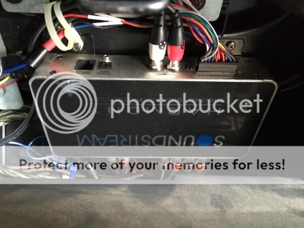

Today I also got the opportunity to drop the Soundstream Harmony in the Jimmy to start using it for processing instead of the capabilities of the CZ702. I don't know how there's not more of units something like this more widely available than there is. Sure, the laptop is a little gangly and cumbersome to have in your lap the entire time you're making adjustments but damn is it ever worth it. I had only a couple of little problem areas that I couldn't quite adjust enough on the Clarion due to the restraints of the built-in DSP but they're about gone now. The biggest issue I had was with the crossover for the midbass only being adjustable down to 630hz. I had to use the LP crossover on the 125.2 to get it the rest of the way down to the 250hz region to blend properly with the FR's. I still had some issues with some frequencies being a little "bloomy" near the crossover points on the top and bottom. I couldn't get the crossover points and EQ to find a happy medium with it. Thanks to the independent EQ's and the infinitely variable crossover frequencies the Harmony everything I've played on it so far is so much smoother than before. It's really hard to tell where the beginnings and ends of everything lies now. It's all blending better, sounding so much smoother, and that's only after a couple of hours of tuning. I can't wait to spend more and more time with it dialing in every little thing until it's about perfect!

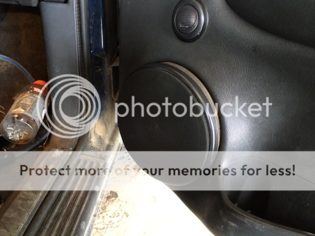

Here's a few pics of the Mach 5 in the passenger door and the Harmony installed.
I gotta say, I don't really care for the look of the grilles that came with the Mach5's on my doors but I gotta have them protected and the grilles to the Bravox's wouldn't fit so I'm stuck with this for now.
I was able to tuck the Harmony in behind the glove box. It's a tight fit and takes a little push to get the glove box to close but at this point I don't really have any place else it can go very easily.
