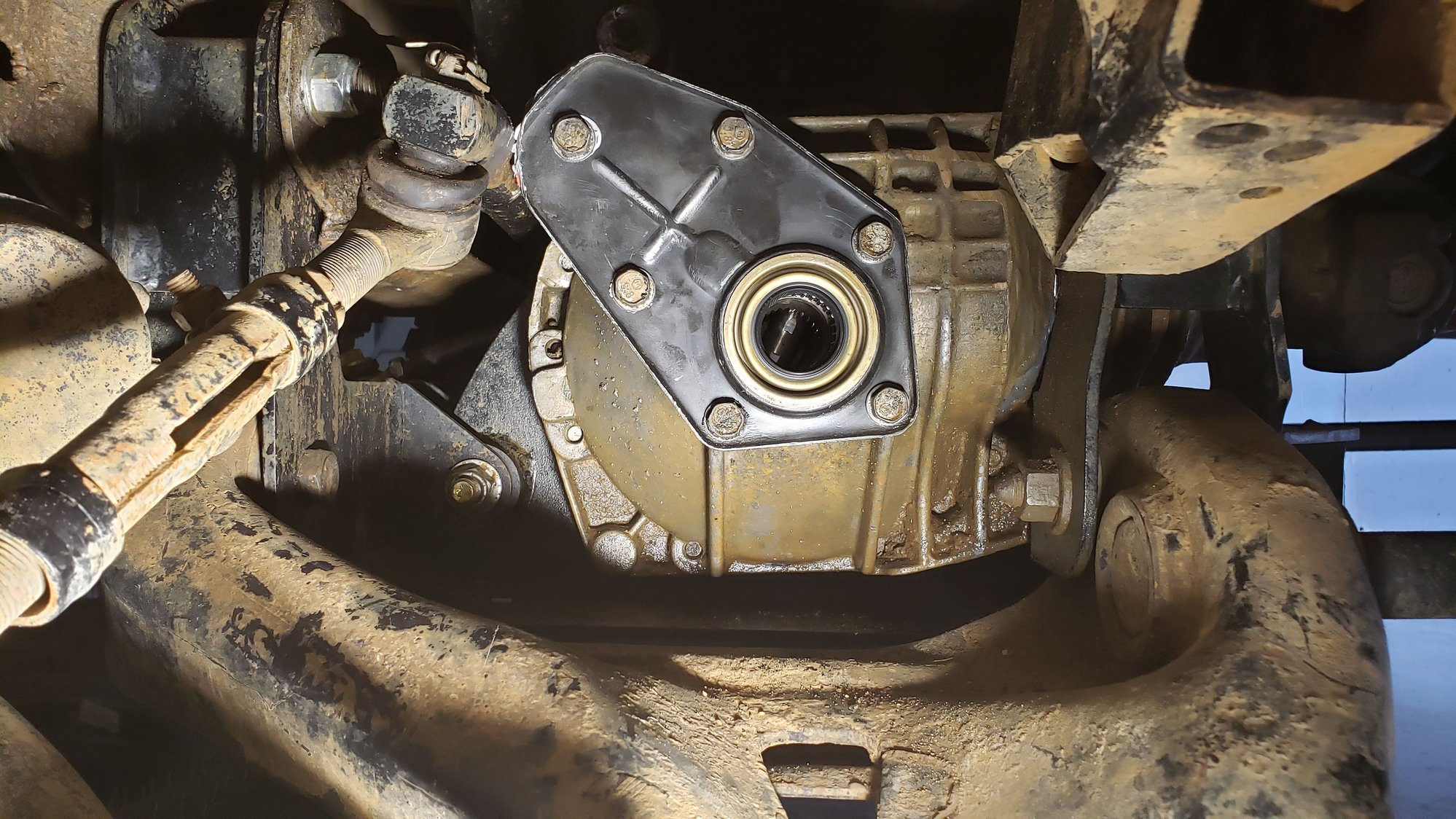

@eshaw so, the old style flange driver side stub shaft measures about 1 3/8" at the bearing contact point. 26 spline on the shaft.
I finally managed to get the correct seal. Advance sold me one that was way too big, returned it, and got the right one from a dealership. $20, but it's ac delco, and fits properly. Got it pressed in, and the cover sealed up and back on.
I'm letting the sealant cure up overnight, and I'll finish putting it back together in the morning. Then take it for its last ever emissions testing! After this year it's safety only, and $7 vs $35.

Well, the axle seal isn't leaking anymore, if it ever was in the first place. Unfortunately, I still have a nasty oil leak from the front diff. Doesn't leak when it's parked, but after a drive it does.
Pretty sure my jb weld patch isn't holding. I'm thinking the aluminum diff housing getting hot and expanding at a different rate than the jb weld has made it not stick. So, I get to drop the front diff (again) figure out how to get the carrier out, and sweet talk my buddy into welding up the hole.
Worst case, the welds don't work, and I get the fun of dropping a diff in the junkyard and having to buy a case half
