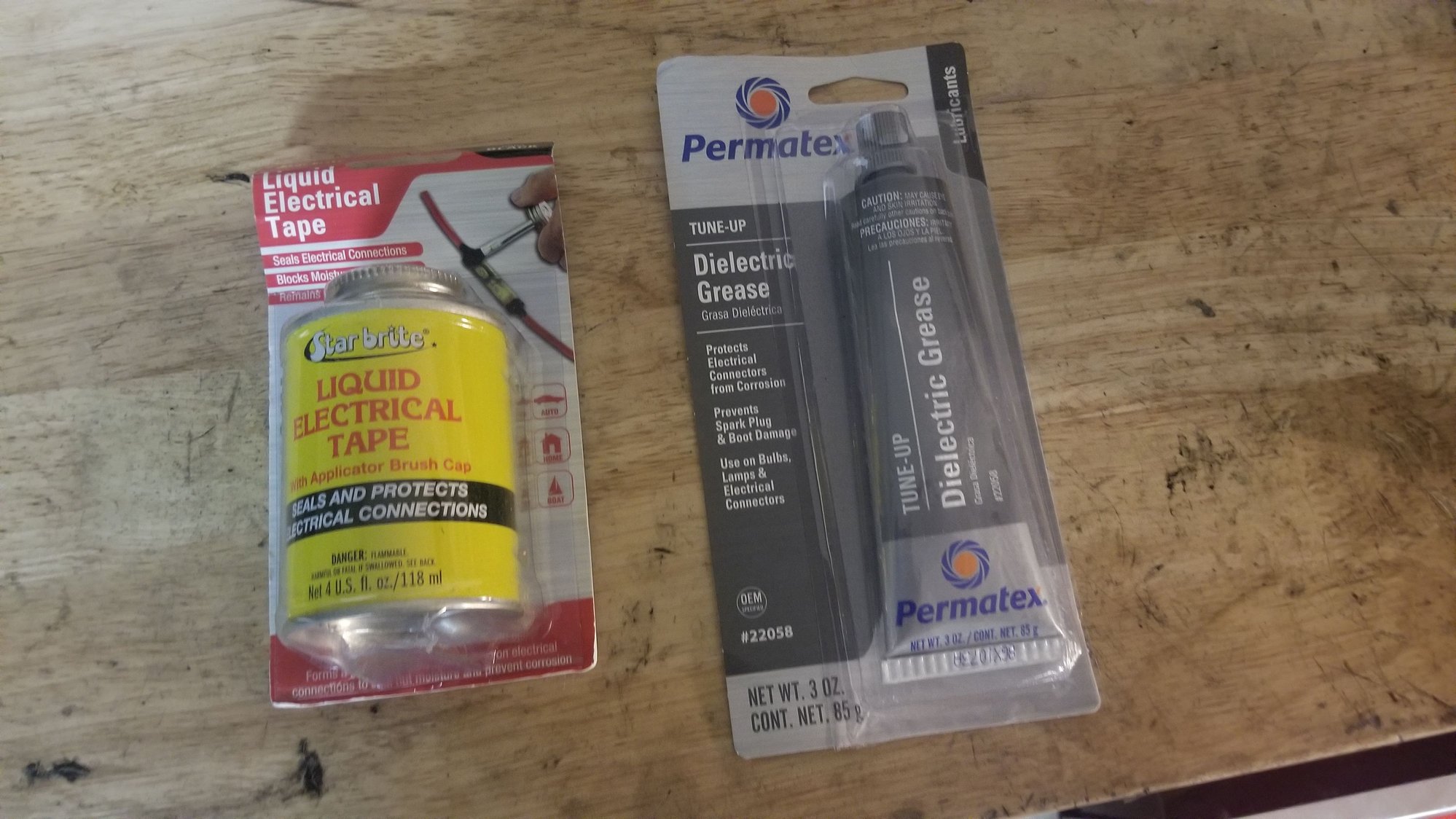

Originally Posted by cleburne red
Let the underhood waterproofing begin!
I know it's not gonna be a 100% waterproof solution, but it should definitely help seal up the electrical connections
That liquid electrical tape looks like a neat product. I've also had really good luck with self-fusing silicone tape for sealing electrical splices.
