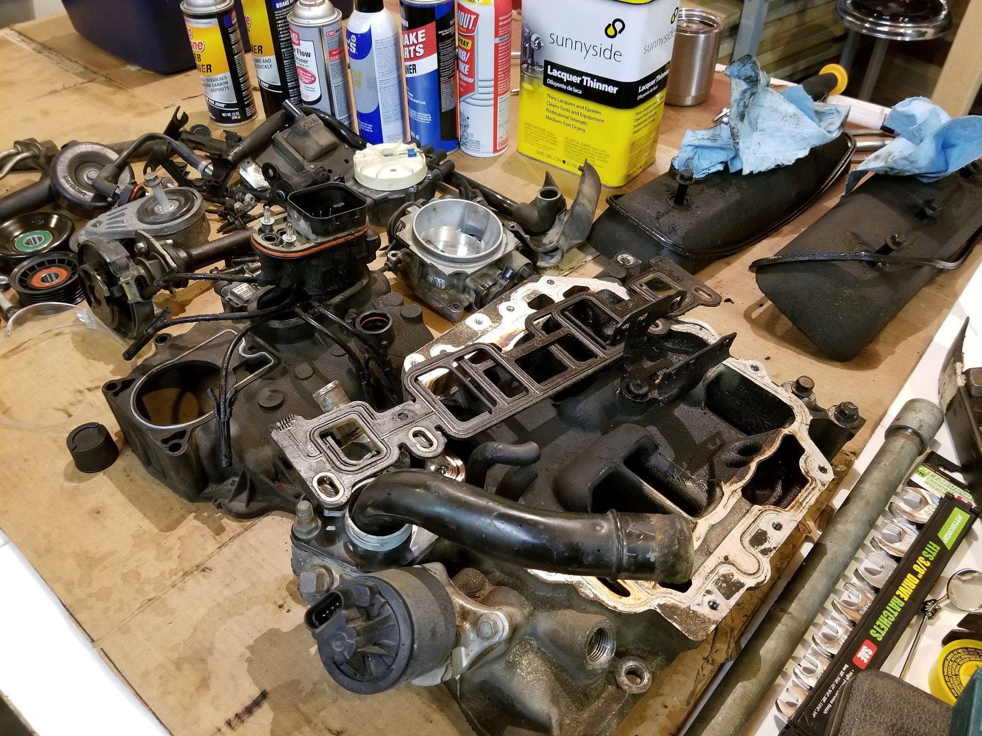

Tonight was a big night of parts cleaning. My Rockauto order comes in tomorrow with gaskets, new spider, and a few other things. Tons of scrubbing, the manifold and valve covers were caked. Tried to use laquer thinner and go to town, but it was barely making a dent. Same with carb cleaner. So I ran and got a bunch of brake cleaner, luckily it was on super sale at Menards, only $1.79 a can! I ended up using 6+ cans, but I'm glad I took the time, they look like new, well, almost.

Hahaha, yeah, you couldn't see mine at all either. Was crazy thick on top of the valve covers for sure. I ended up soaking pretty good in brake cleaner and using a soft brass brush.

Yeah, mine are still brownish on the inside. The brass brush and repetitive spraying with brake clean is really what helped with the gunk
