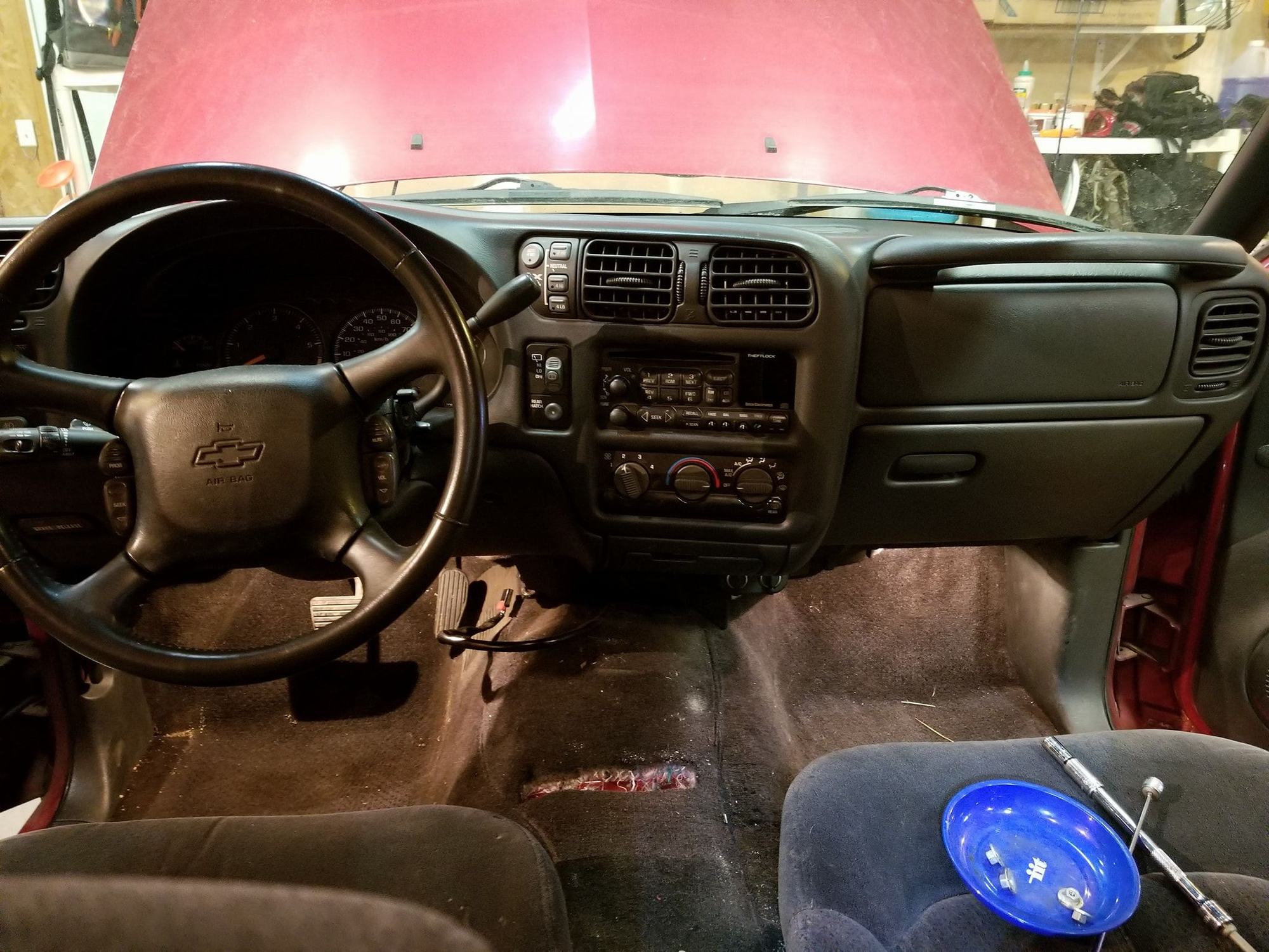

Heater core replacement.
This last weekend I finally tackled the leaky heater core. I think it went fairly well. I kept all the different screws in labeled sections in a box on the table so I would know exactly where everything went back in. I did not take out the inner wheel well to get at the bolts. After the top ones were out, I leaned the heater box forward just enough to get the core out. 1 of the bottom mounts did break, but it's right by the dash mounting bolt and will hold tight nonetheless. I used some 3/4" foam weatherstripping to cushion and seal up around the new core. Had to clean up quite a bit of antifreeze in there that had leaked. Had one issue when I put it back together, I missed the power connector for the fuse panel. Even with my mistake, I spent about 10 hours on the project, but I also work a little slow.
Side note: The passenger door sensor is not hooked up. In fact, there was no wire to be found to connect to it. Weird.
Console out.
Main components almost out.
Stack of dash parts
No wire?
Dash out
Heater Box area
Pulled out from firewall to get at the heater core.
