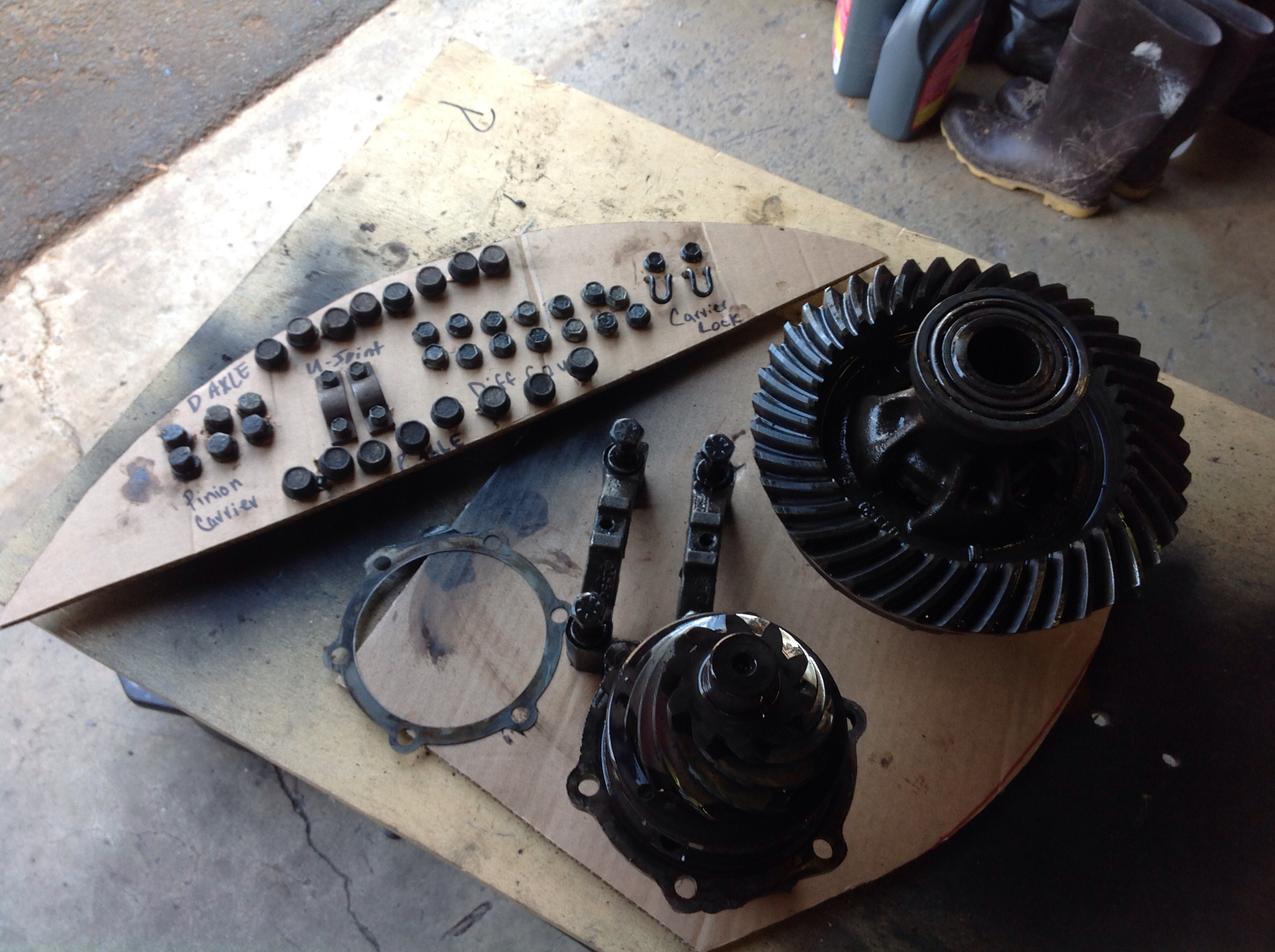

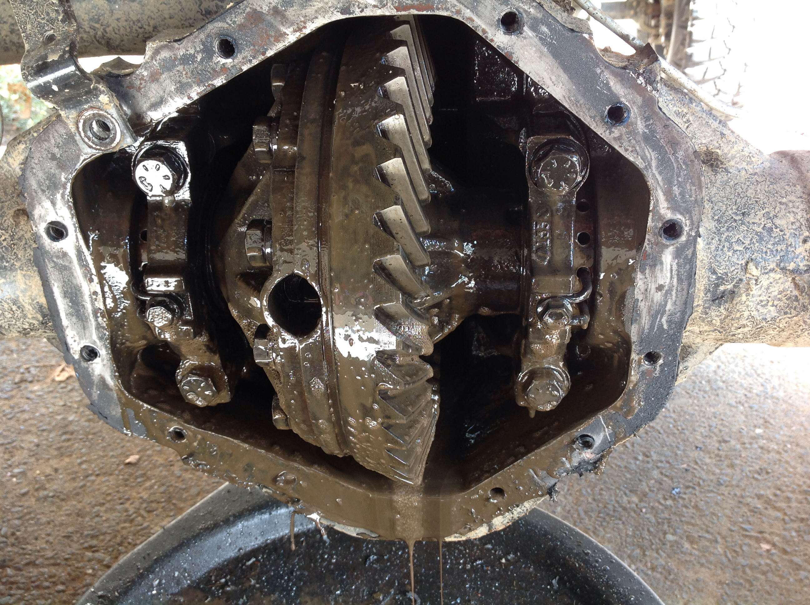

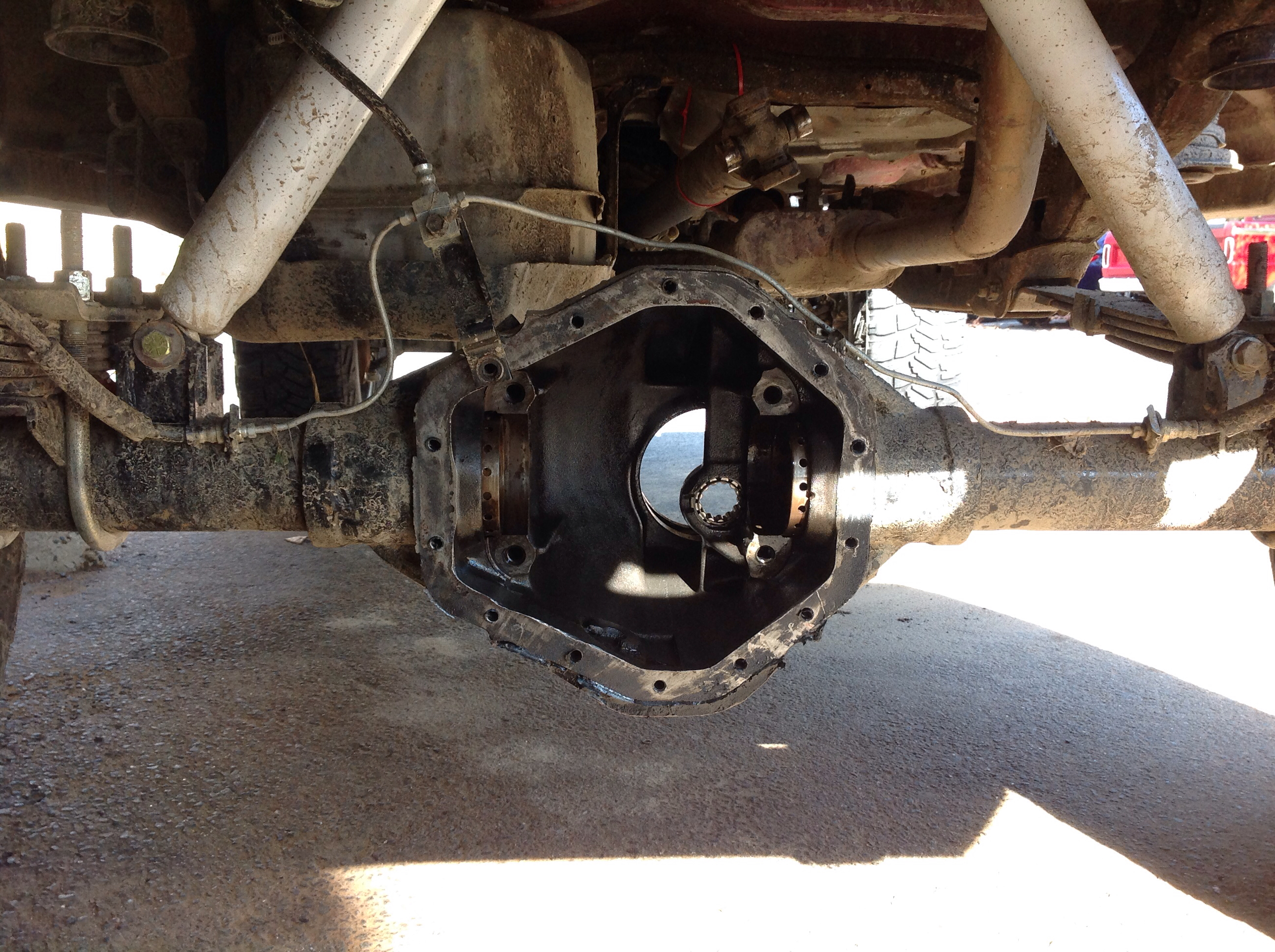

Got the rear tore apart and cleaned up today.

All of the bearings seem to be in really good shape on the carrier so I won't have to replace those. I stopped at a buddy's shop on my way home to have him zip the pinion nut off for me so tomorrow I'll finish pulling that apart and see if I can reuse the outer bearing. I think I'll replace the inner just because for $25 it seems like less hassle to me! If my crush sleeve eliminator comes tomorrow I should be able to put this thing back together if not then it will be Wednesday.

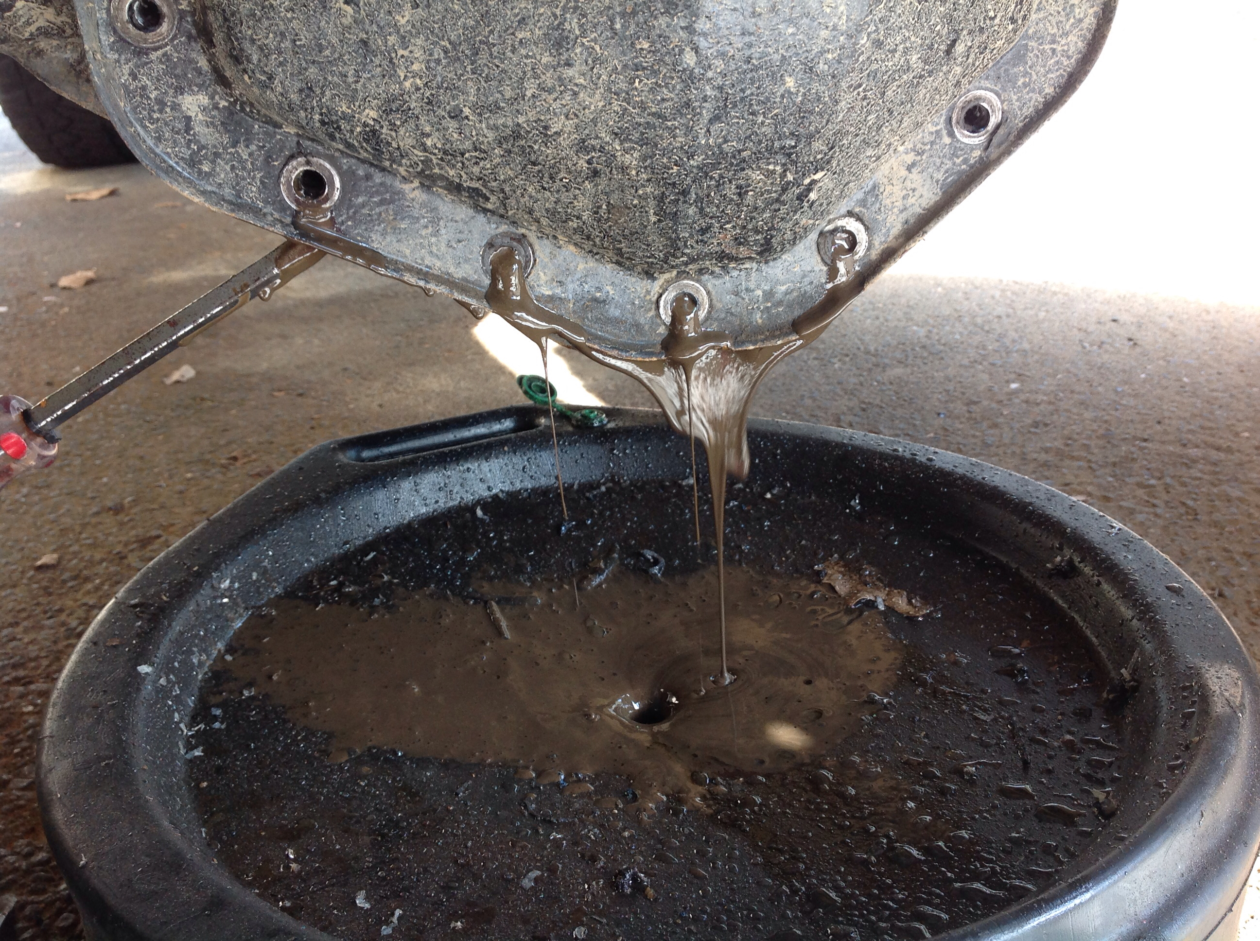

It's a damn good thing I didn't try to drive this thing anywhere tho after sitting in the river! Had about a half gallon if water come out when I cracked the cover open and then this lol

Guess I'll take the time to run a good long vent tube now

Soupy. I need to change my rear diff fluid after seeing that...

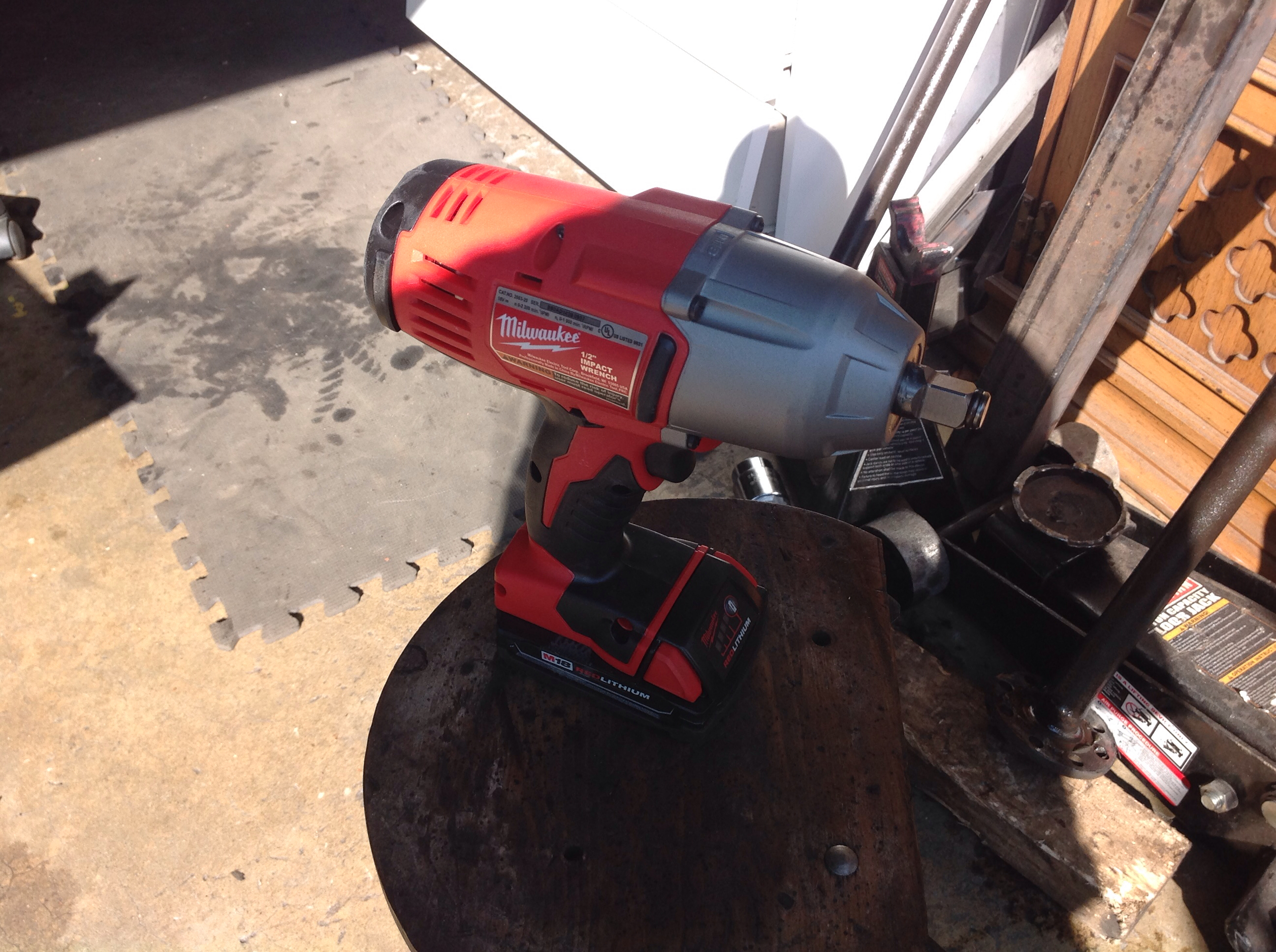

I also decided to treat myself to this today while I was at Home Depot lol!
It's 450ft/lbs and I already have 4 batteries and two chargers for it so for $170 what the hell right...

It's nice to have for sure! It will make trips to the junk yard much more pleasurable that's for sure not to mention just general maintenance that requires removal of wheels and things. I've been wanting one for a lonnnngggg time but haven't because of cost but when I saw this one was just the impact and it would work with my batteries I couldn't pass it up.
