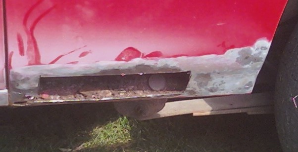

Well over the weekend I got finished painting the front bumper and got it mounted. I also got the rear bumper painted and I started to work on the lower sides of the body to prep to paint. So i started grinding away where I knew that there was some rust and guess what it was pretty bad. So I cut out a 4x11 hole on the lower driver side quarter panel to get to good medal, and on the passenger side there's ones a 3x4 area that I had to cut out. So tomorrow im going to weld new metal into the bad areas and to start to bondo it. Well as I said before I could not get the 4 high to work well I also fixed that today. I went down to the same garage from where I got the transmission and got the TCCM transfer case control mod. Well I put that in and it works like a champ.

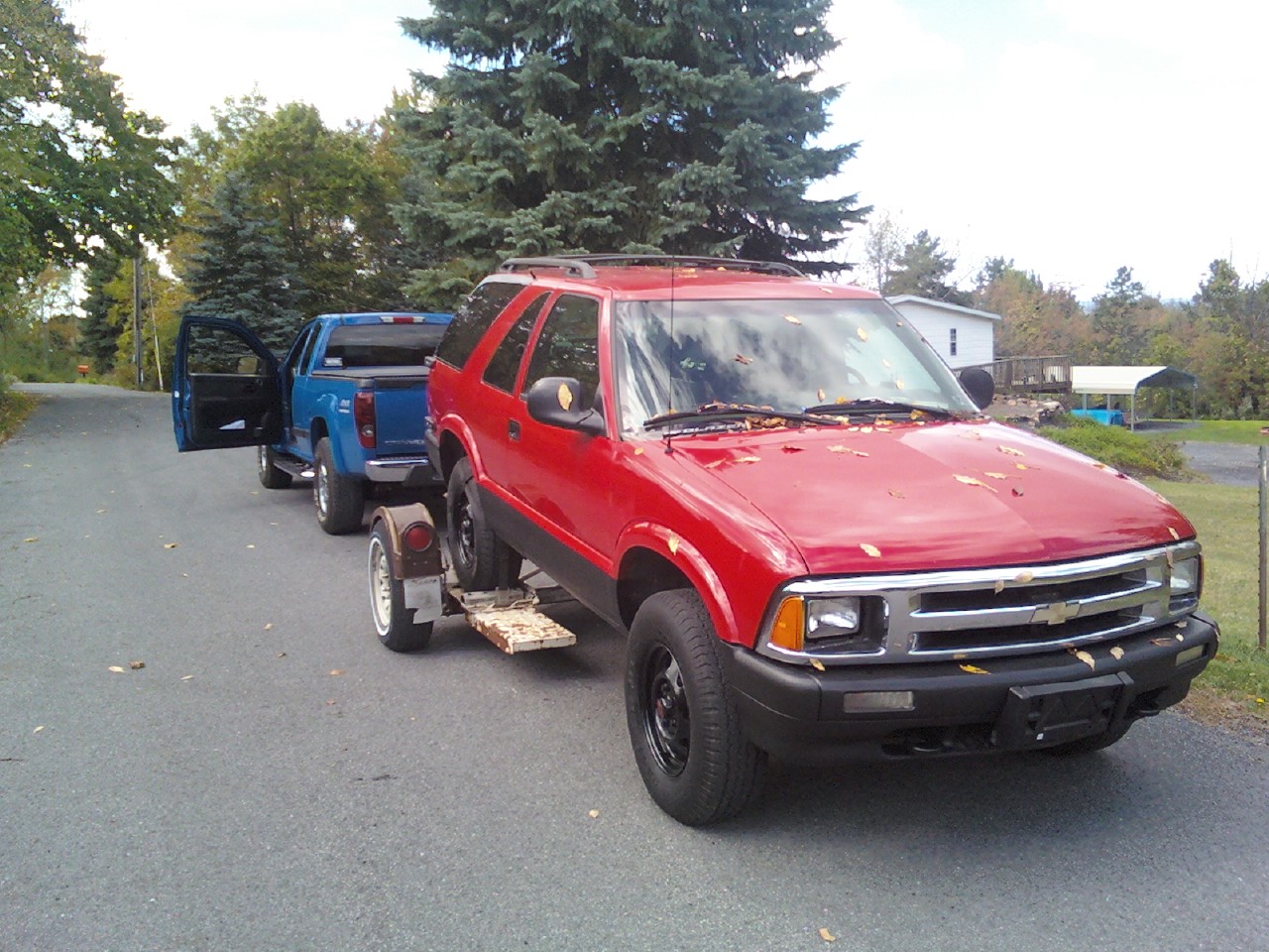

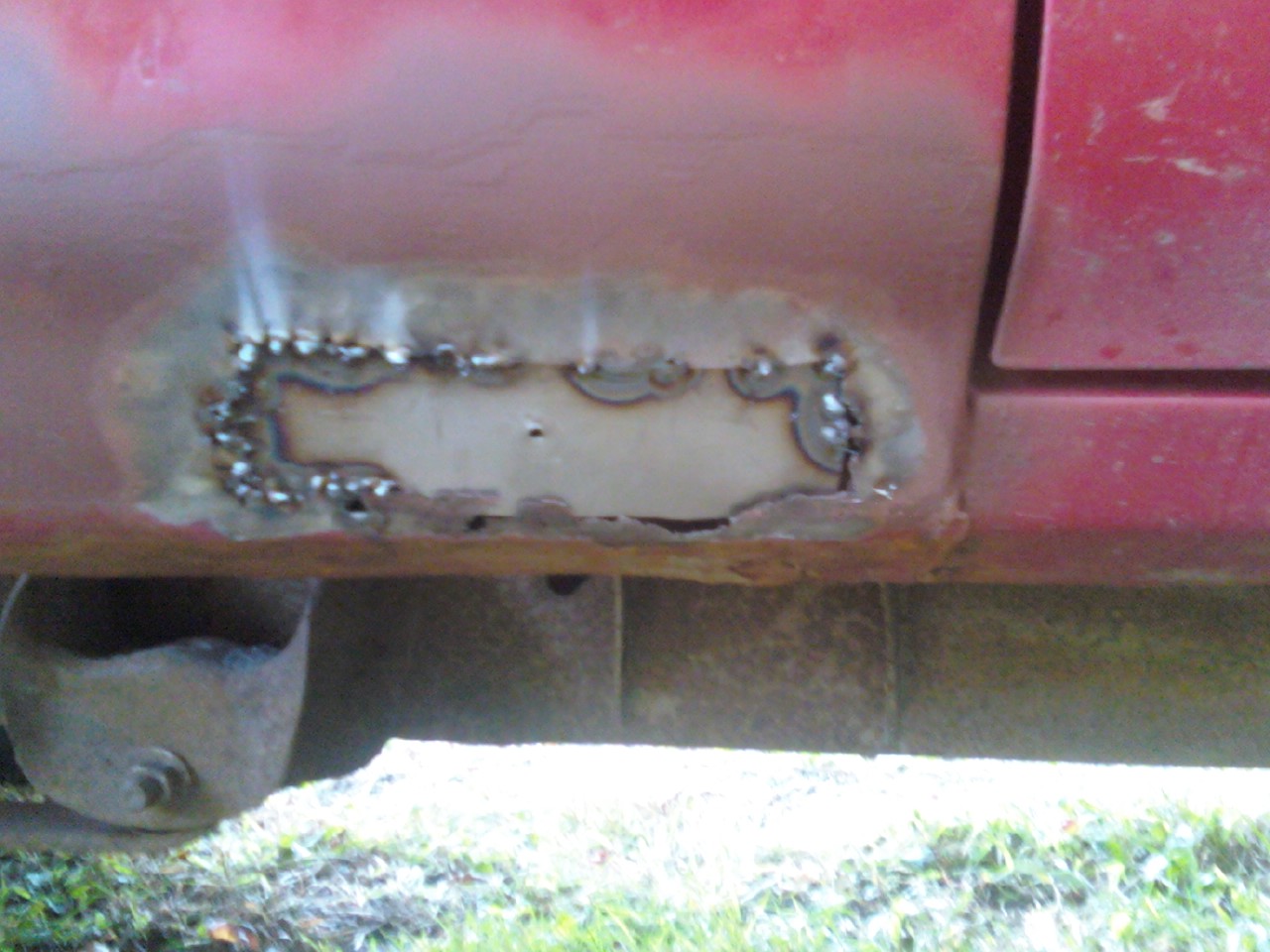

sorry about not posting in the last couple weeks so here is that I did. I got the new metal welded in where I have to cut out the junk metal. I put bondo where I put the new metal in. I also got the whole bottom of the blazer painted with the bed liner spray. I also pick up 4 235 75 15 tires for 50 bucks they are used but that's the only thing i could afforded right now. I also painted my old steel rims do to money issues so I will be holding off on new rims for now. I also towed her into the high school yesterday so they could take the old transmission out and put the new one in. they are also replacing the passenger side CV boot and seeing why my fuel gauge does not work most of the time. I hope they get it all done is 2 weeks so i can get it inspected and start to drive it. Here is some pics of what I did hope you enjoy. Also I have around 500 bucks into the old girl so I think I got a good deal.
