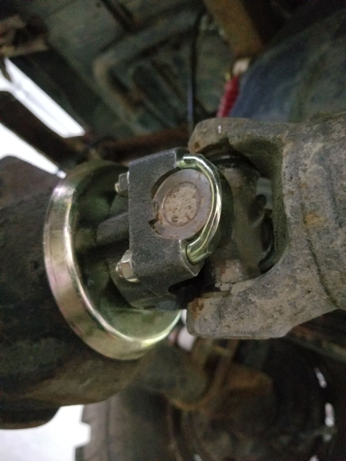

Got my ubolt style rear pinion yoke on today. Changing it was a breeze, I was surprised it went so smooth. The thing seems way beefier than stock, and the u bolts are much easier to install than the strap style clamps.

Won' take long for it to get all muddy lol... I like the looks of the u bolts

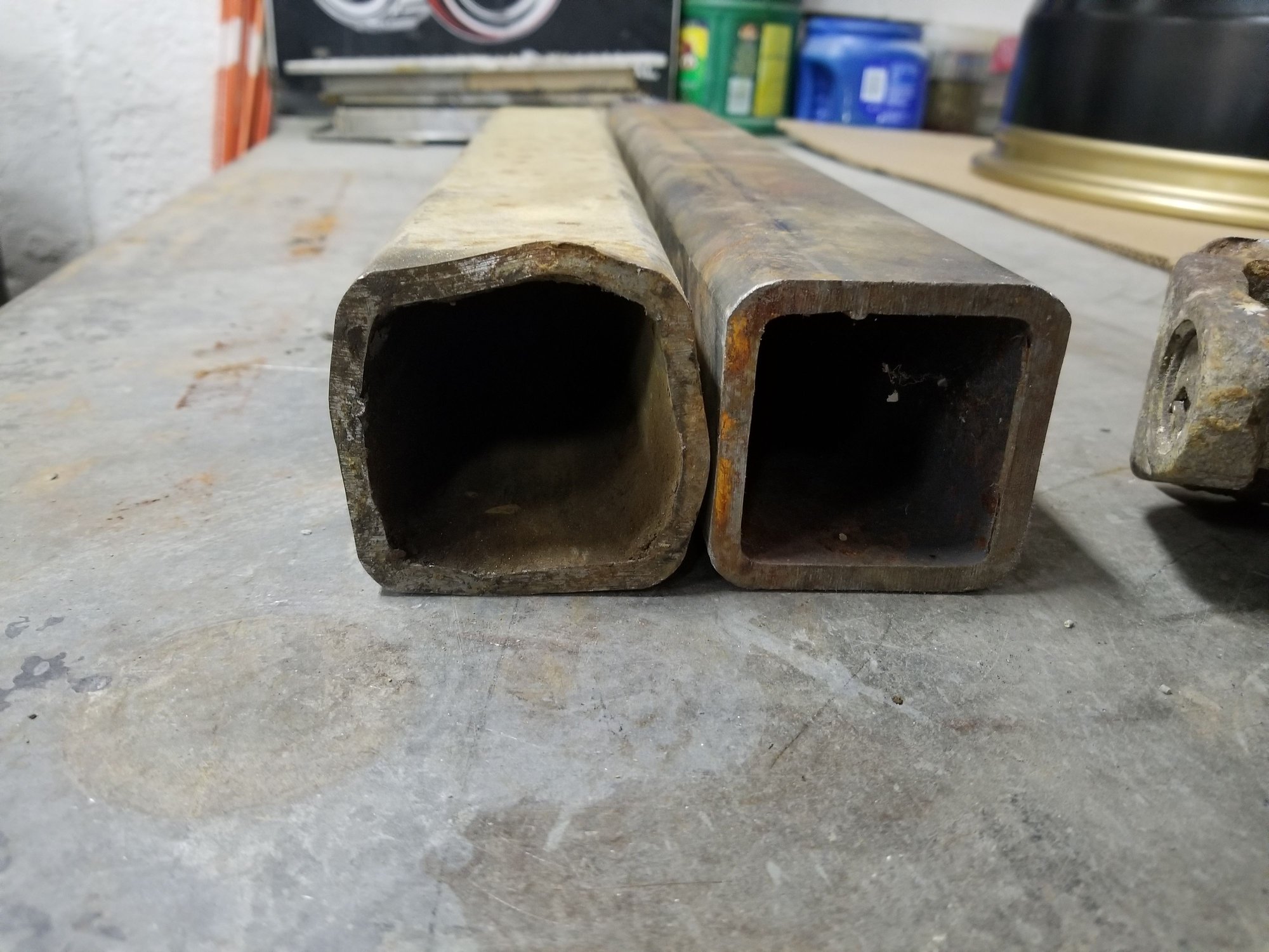

Aside from that, my alternator is at the shop being rebuilt. I've also started rebuilding the one section of my front driveshaft so it doesn't pop apart on me again.
I'm making the outer sleeve 3.5" longer so it doesn't blow apart on me if my front end starts hopping again(I'm staying the hell off the tugg pad though so that shouldn't be an issue lol)
You can see how bent up the old shaft is from blowing apart while spinning. Crazy it twisted up the 1/4 inch steel like that.
