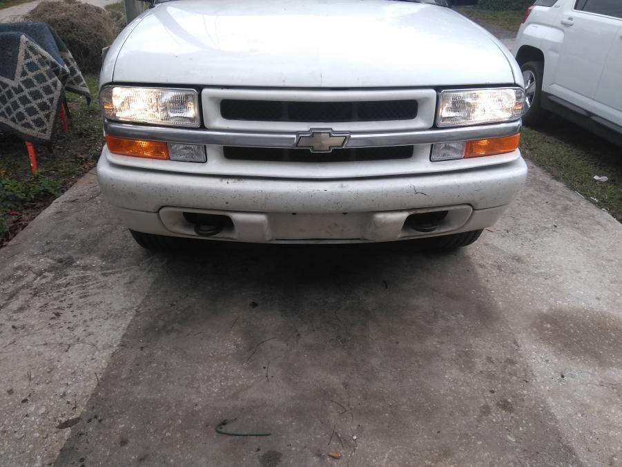

Also in that big *** box were new headlight housings, TYC Branded and got the set for 60 dollars flat. not bad i'd say.
