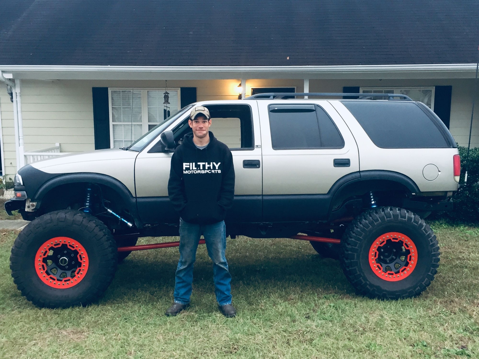

Shes looking ****ing awesome! Love the stance on her.

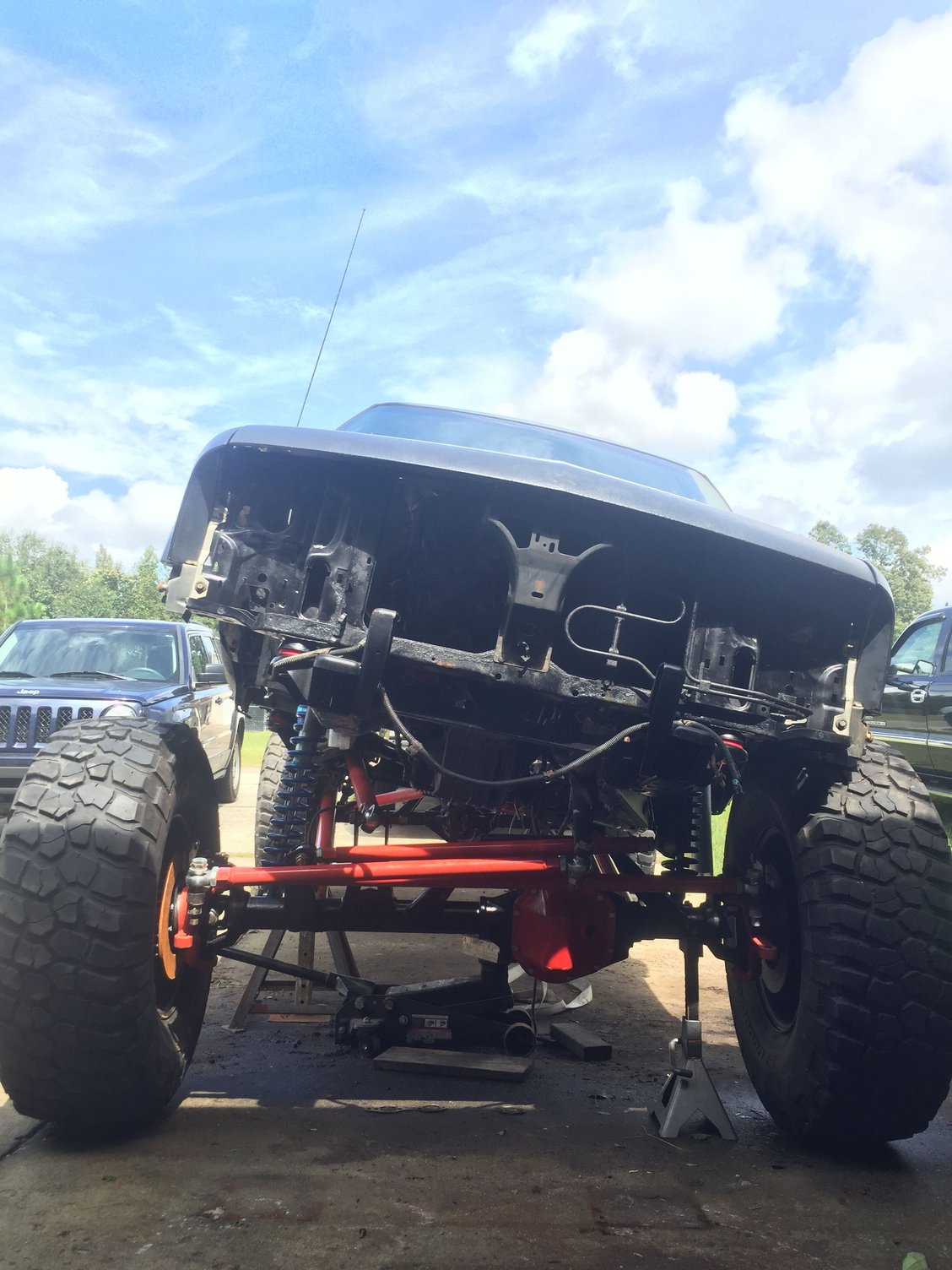

Well the good ole blazer survived Hurricane Florence in the driveway with no damage to it
Got back out there today while it was clear and put the transfer case in so I could measure for some driveshafts. Oliver's Driveshafts in Winson Salem, NC I think is where I'm going to order them from. Called them on the phone today and were great compared to Tom Woods. And way cheaper. Ended up dropping the dang thing (transfer case) right on my head and bled a little. But then again who hasn't bled a little on their rig. The nice thing about the blazer now is that I can literally just sit under it and work on it. I think in the future to be a little safer and more efficient, I need to fab up a tranny holder for my garage jack and maybe give it a lift kit. Tired of stacking sketchy pieces of wood to only fall off last minute. Also, the high-lift I have in the garage is clearly not tall enough right now to max out my suspension so may need to buy a longer one in the future.
Flexy Flex Flex Pics
Up up and away!
Still had 3 inches of shock travel to go at this point. And the engine bay is at my chest (I'm 5'11").

Shes going to be a great sand dunes ripper when shes done... let alone the rock trails she'll conquer lol... I'm really liking the suspension you came up with... I'm interested to see how you modify the front fenders...
