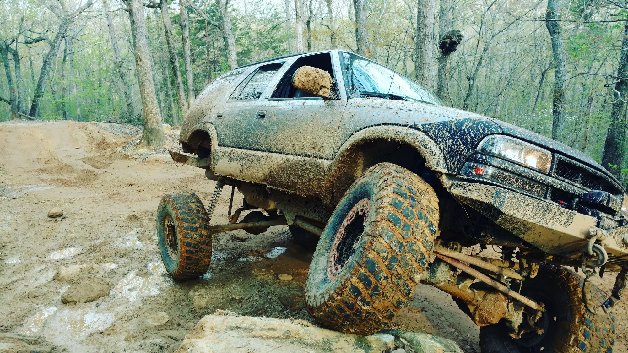

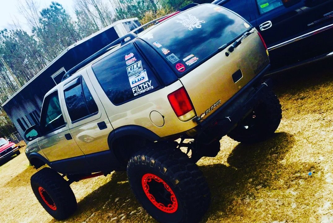

I've finally gotten around to a little testing now that I'm partially settled out here. Blew all 4 tires on the trailer towing it out here. Might have been a bit over weight So far the blazer has done literally everything I've thrown at her and have some minor tweeking to do. Next up I'd like to do Chinaman's Gultch/Carnage Canyon here in CO. Need to build a fuel tank skid before then.
Race stickers because custom built :P
Rock lights
Rear flex at Uwharrie
Ram Offroad Park, Colorado Springs, CO; felt like I was going to roll for sure but was perfectly fine.
Front flex
Rear flex on the mountain
Snowed last night
