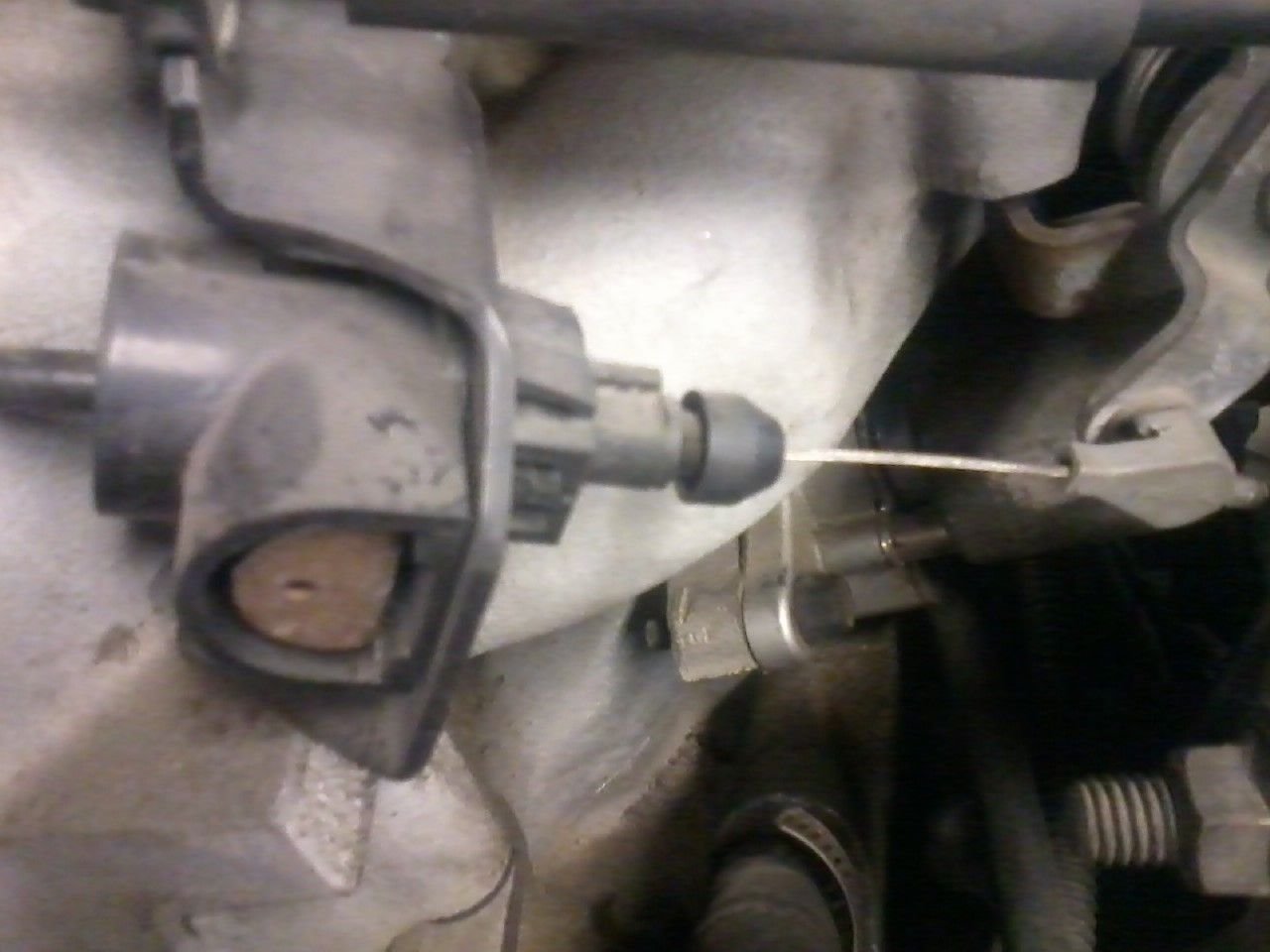

5 to 40 mph before it shifts to second sounds more like shift points are too high not lack of power - THM350 is a detent cable, THM400 is a TV cable both reset the same way - push the center metal pad in, slide inner shaft in then do wide open throttle and it will set shift points - picture of cable .....

Edit ... I stand corrected A standard TH400 uses a electric kick down switch on the throttle linkage that powers a electric detent solenoid on the valve body - The TH200R4 has a TV cable and is pressure control as with the TH700R4
If the electric switch on the throttle linkage is way out of adjustment it can be the same as a TV on the TH200R4 / 700R4 or a detent on a TH350 if way out of adjustment it will hold the shift points off and too high .....
