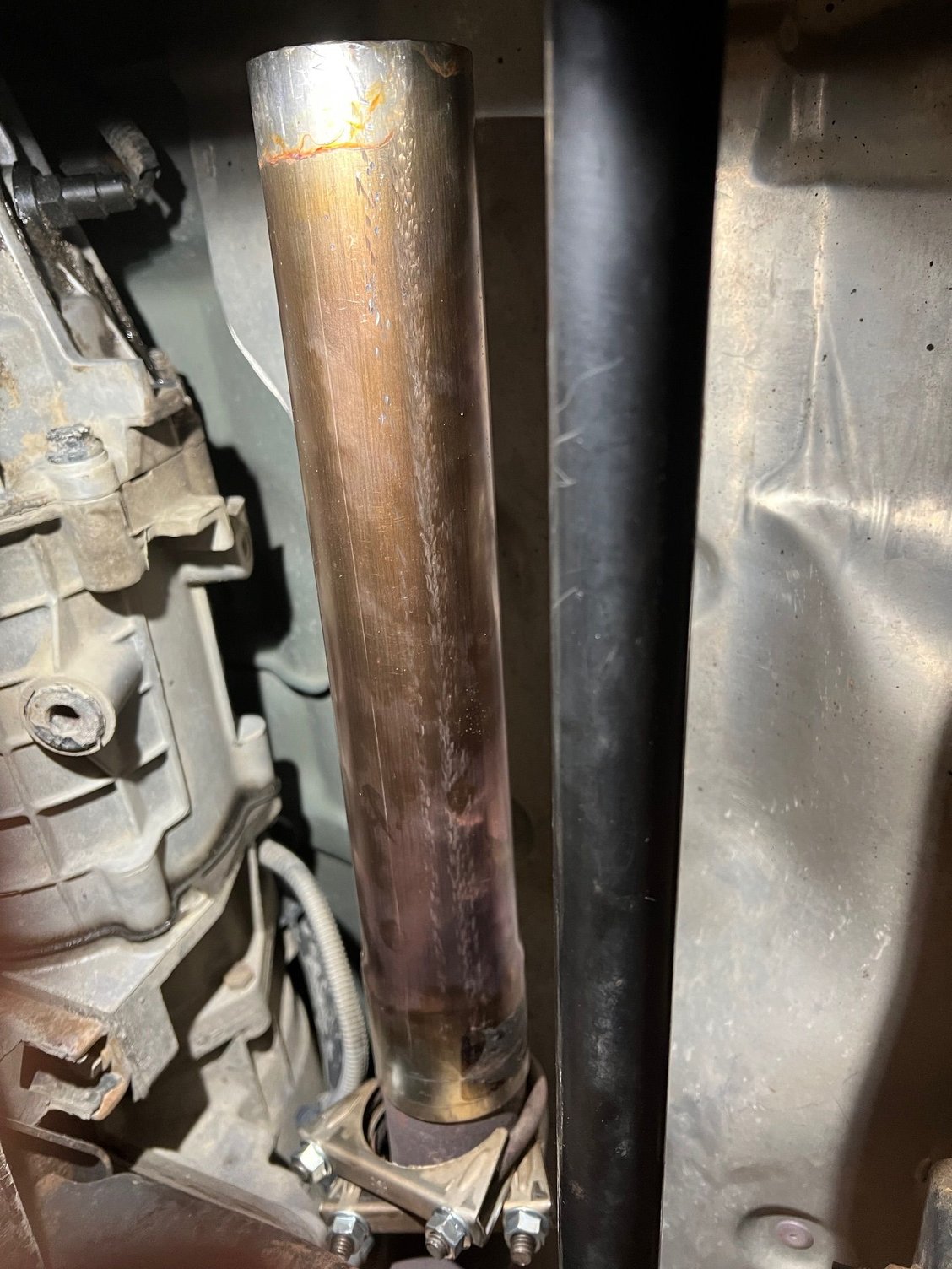

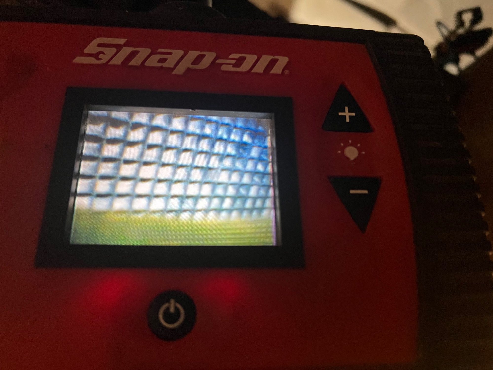

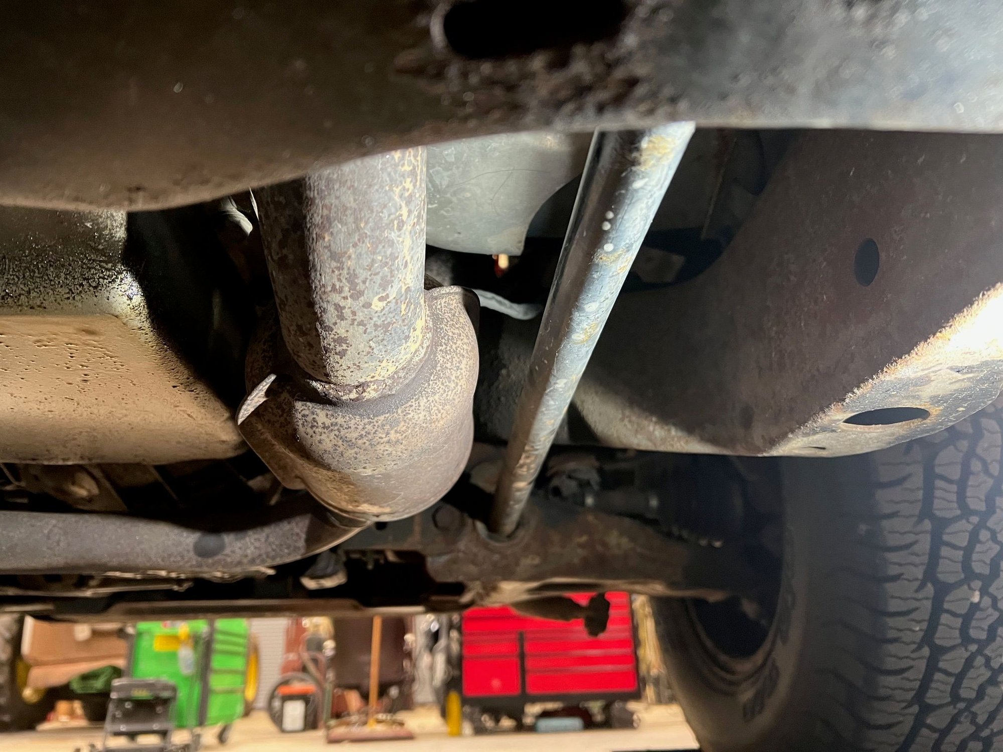

The first photo is the pipe replacing the 2nd cat. The 2nd photo is the upstream cat. and the third photo is the honeycomb inside the cat as seen through a bore scope. I gutted the cat like a fish and now it roars like a lion.
