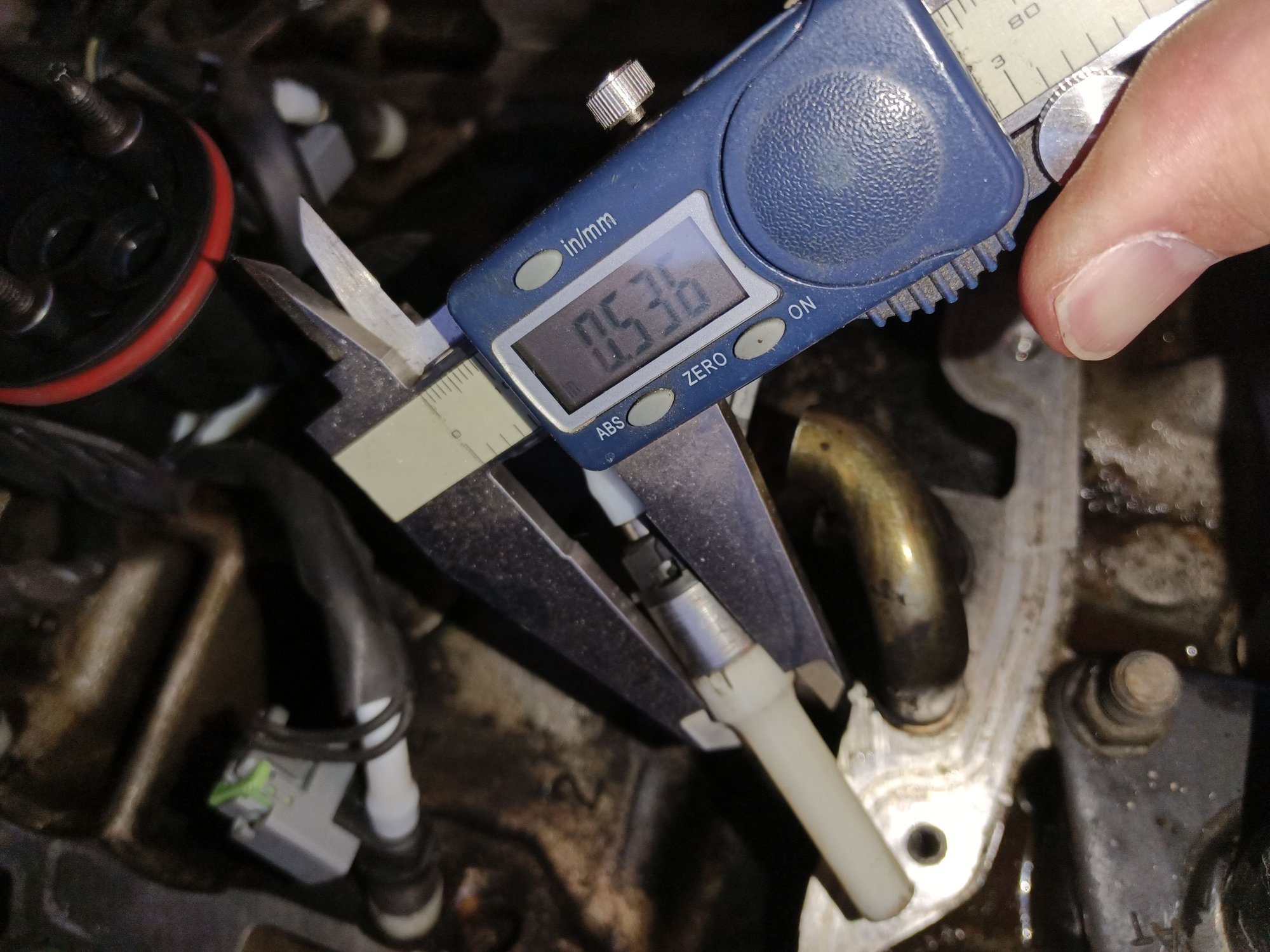

I ordered a CSFI to MPFI conversion spider for my 2000 blazer and ran into a problem installing it.
When I went to insert the injector cups into the injector boss in the intake manifold, they do not slide in at all.

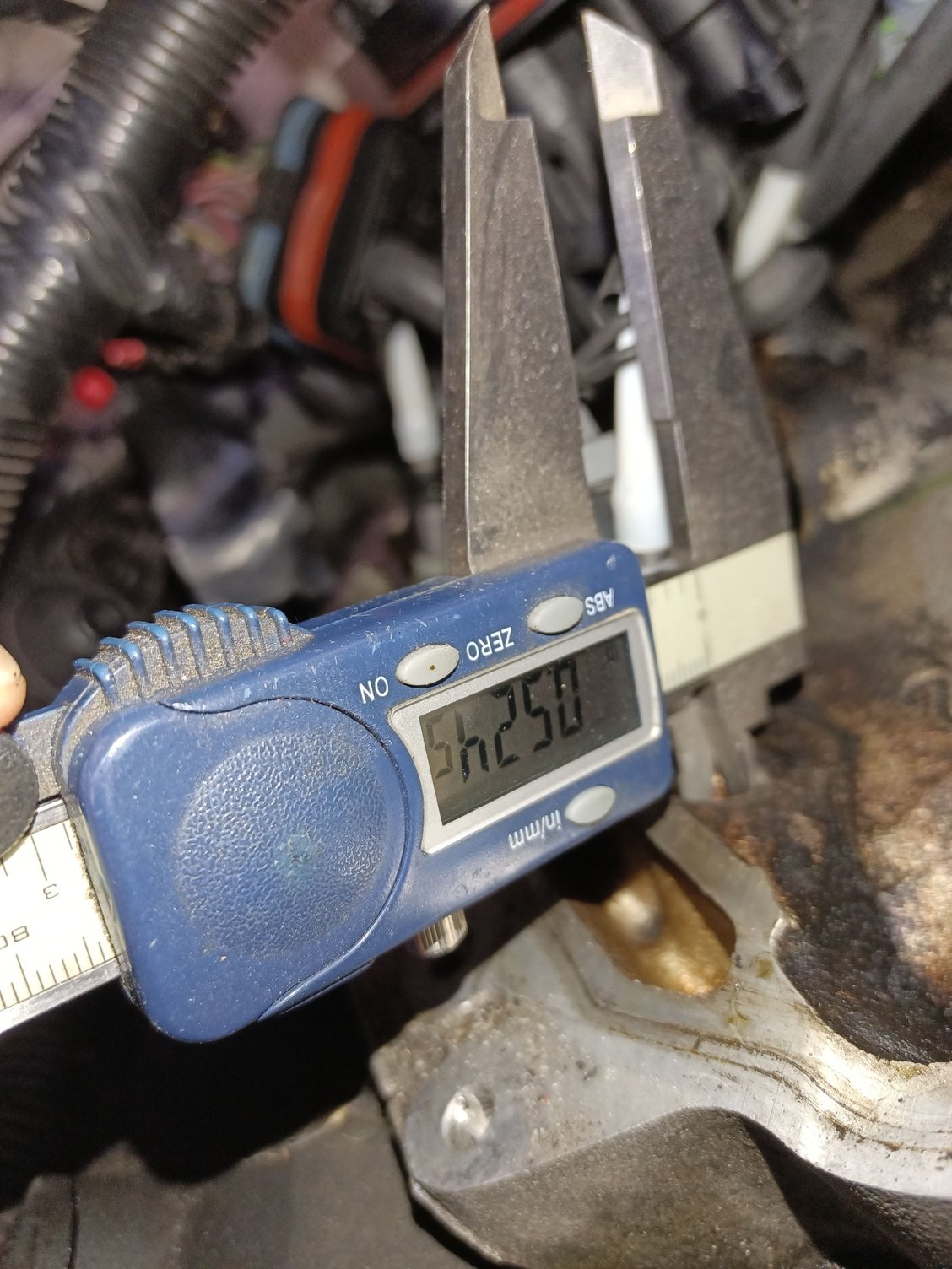

The ID of the injector bosses in my intake manifold measure .525" +/- .002" on all of the holes and the OD of the plastic cup that the injector sits in measures .535" to .536" on all of them. The injector cups are too big to lock into place on my manifold. I am a machinist by trade so I am measuring them correctly.
So this makes me wonder if there is a difference between a MPFI replacement kit and a MPFI upgrade kit? Or maybe the injector bungs in my manifold were machined too small? Or the injector cups on my MPFI conversion kit are just oversized from where they are supposed to be?
Has anyone ran into this problem before?
