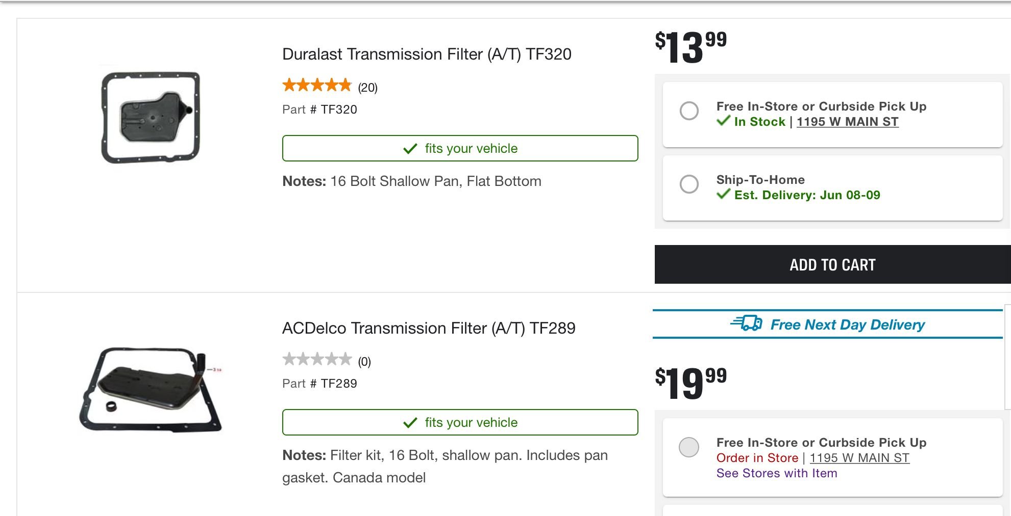

I've got a 1996 Chevy Blazer 4WD and I plan to drain + refill with Dexron VI after changing it's filter but Autozone has like 6 different filters that "Fit" my car. Any ideas?

The multi listings are for same filter just different manufacturers. You need a filter for shallow pan.

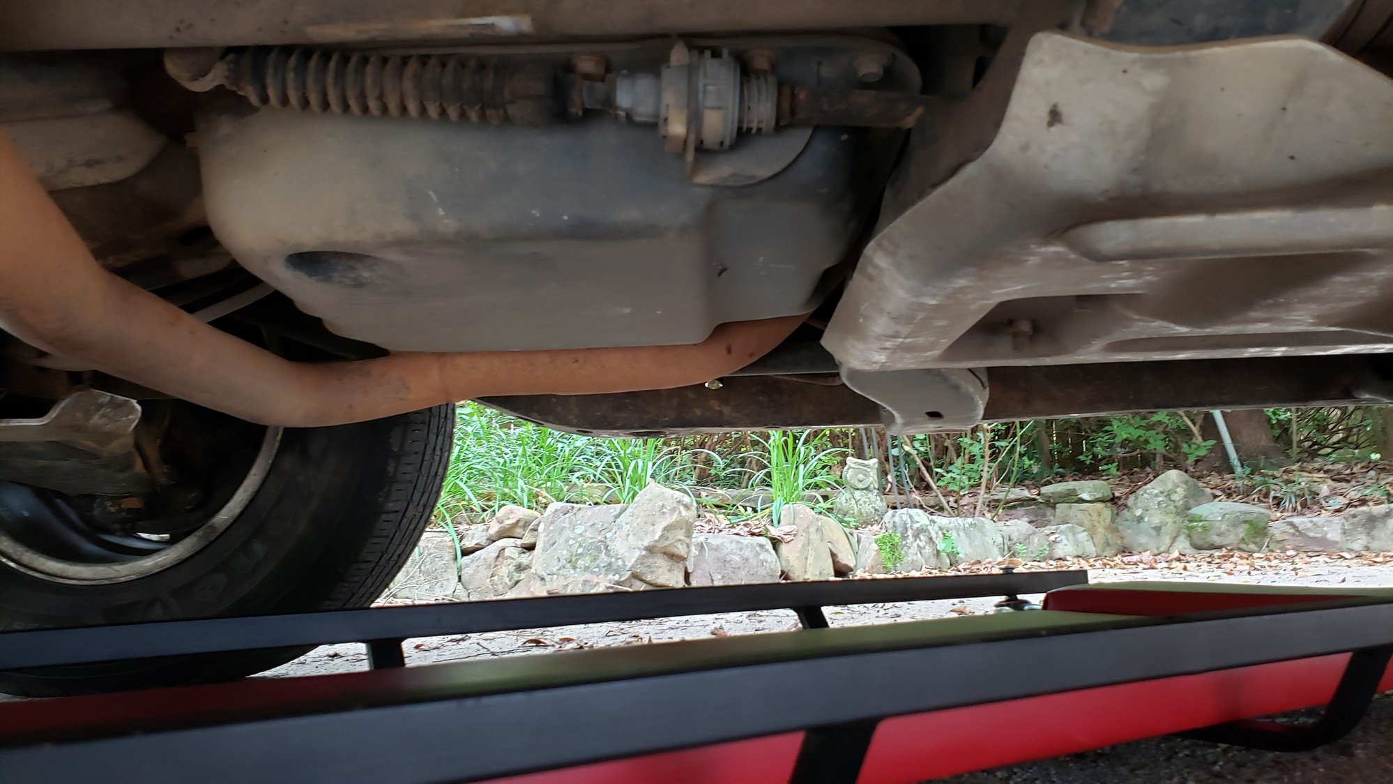

it would seem it has 16 bolts but the pan looks more deep rather than shallow let me get a picture of it.

What is it deep or shallow?

Deep pan didn't come out until the middle of 97.

the transmission was rebuilt once could it be possible that they installed a deep pan? I mean it looks like a deep pan correct?

That is the deep pan. Not used in 1996.
