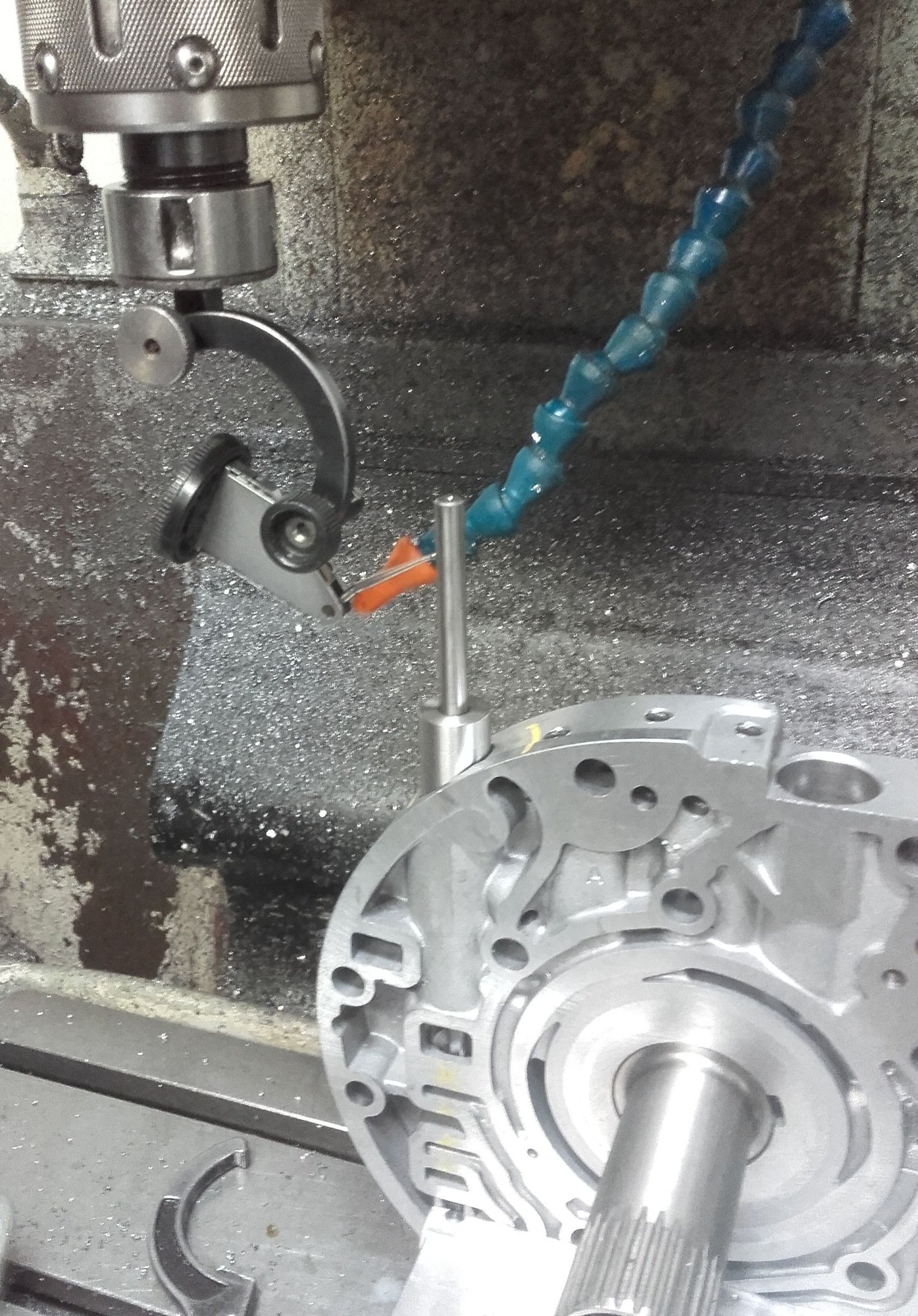

For those who are devoted to DIY here is a setup procedure.
1. Fit the tool into the pump bore.
2. Mount the pump body into the vice, do not tighten much.
3. Using a nylon hammer compensate the left-right tilt:
We managed to set the tilt at 0.01mm

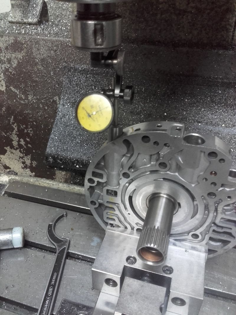

4. Check the front-back tilt:
In our case it was just perfect (within 0.01mm), so there was no need of correction.
5. Tightened the vice and check the tilts over again.

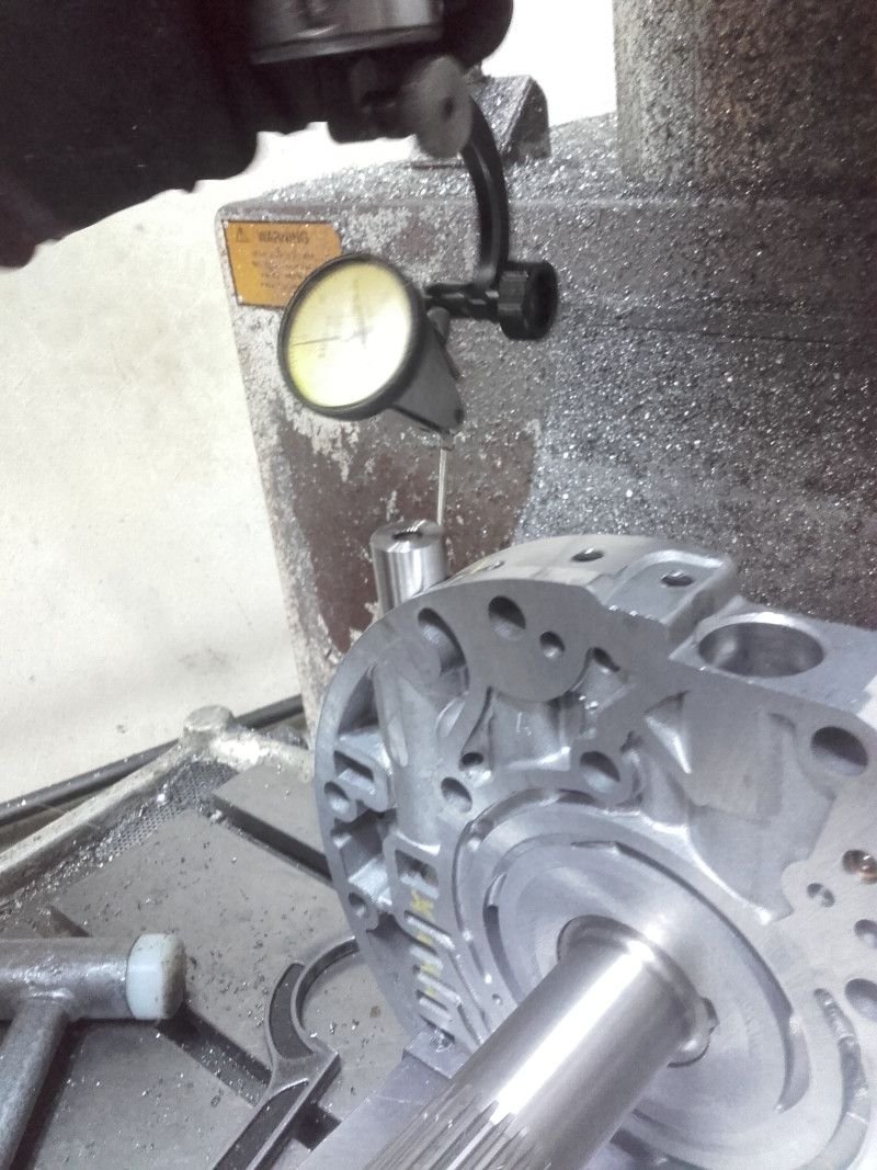

6. Center the tool over the bore, by jogging the CNC X-Y:
Again, we were in 0,.01mm.
7. Confirm with the bore. Surprisingly, we found the bore to be... oval
8. You may install the reamer. IMPORTANT NOTICE: If You have been changing the vice tightening while doing these steps, You have to re-check all over again. Otherwise, You're ready to rock and roll.
