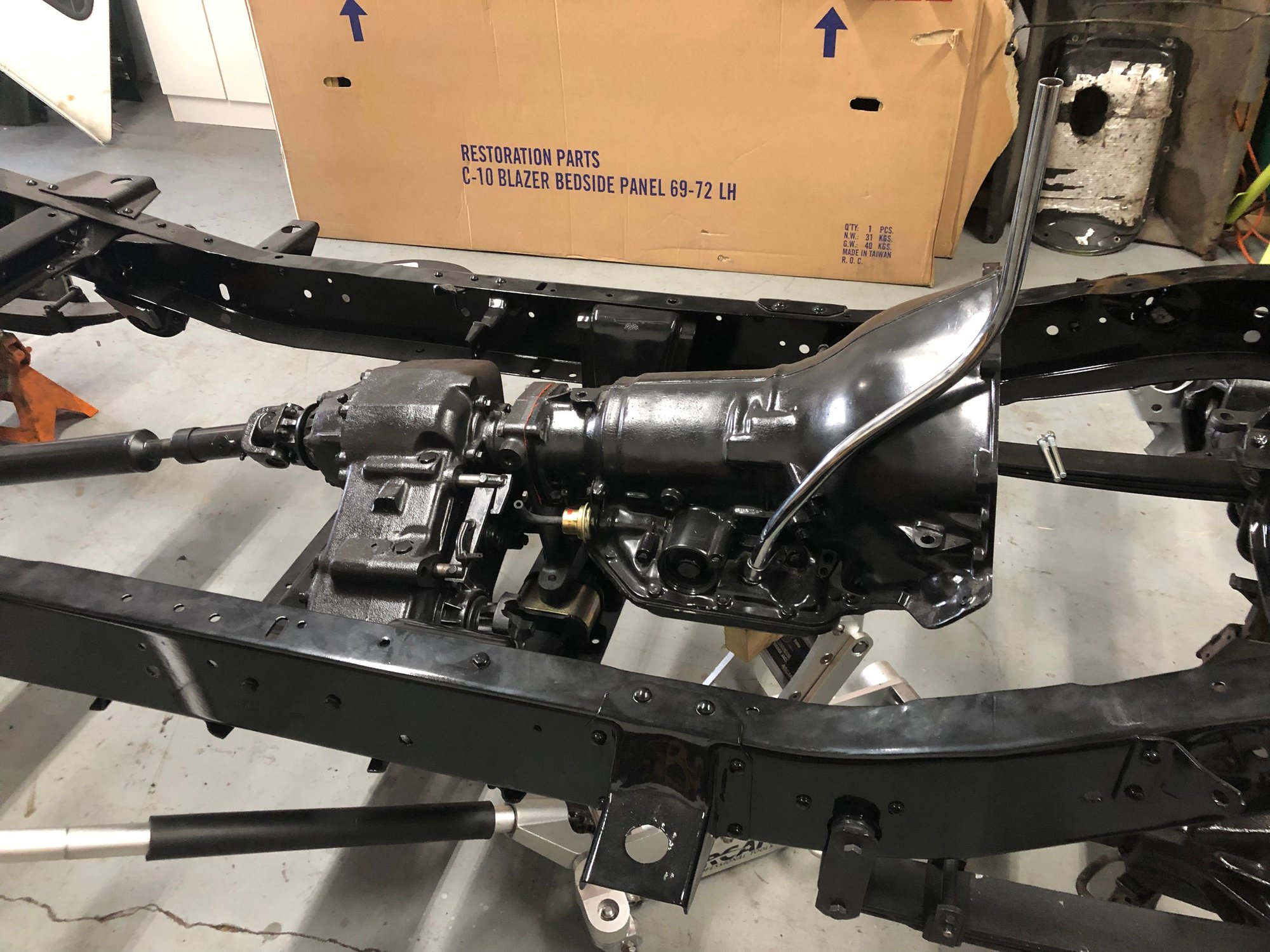

Here’s where I am today, looking for some help on sequencing on putting the body back on.

Have no idea about your question, but that's a nice looking frame! Gonna be a sweet truck!

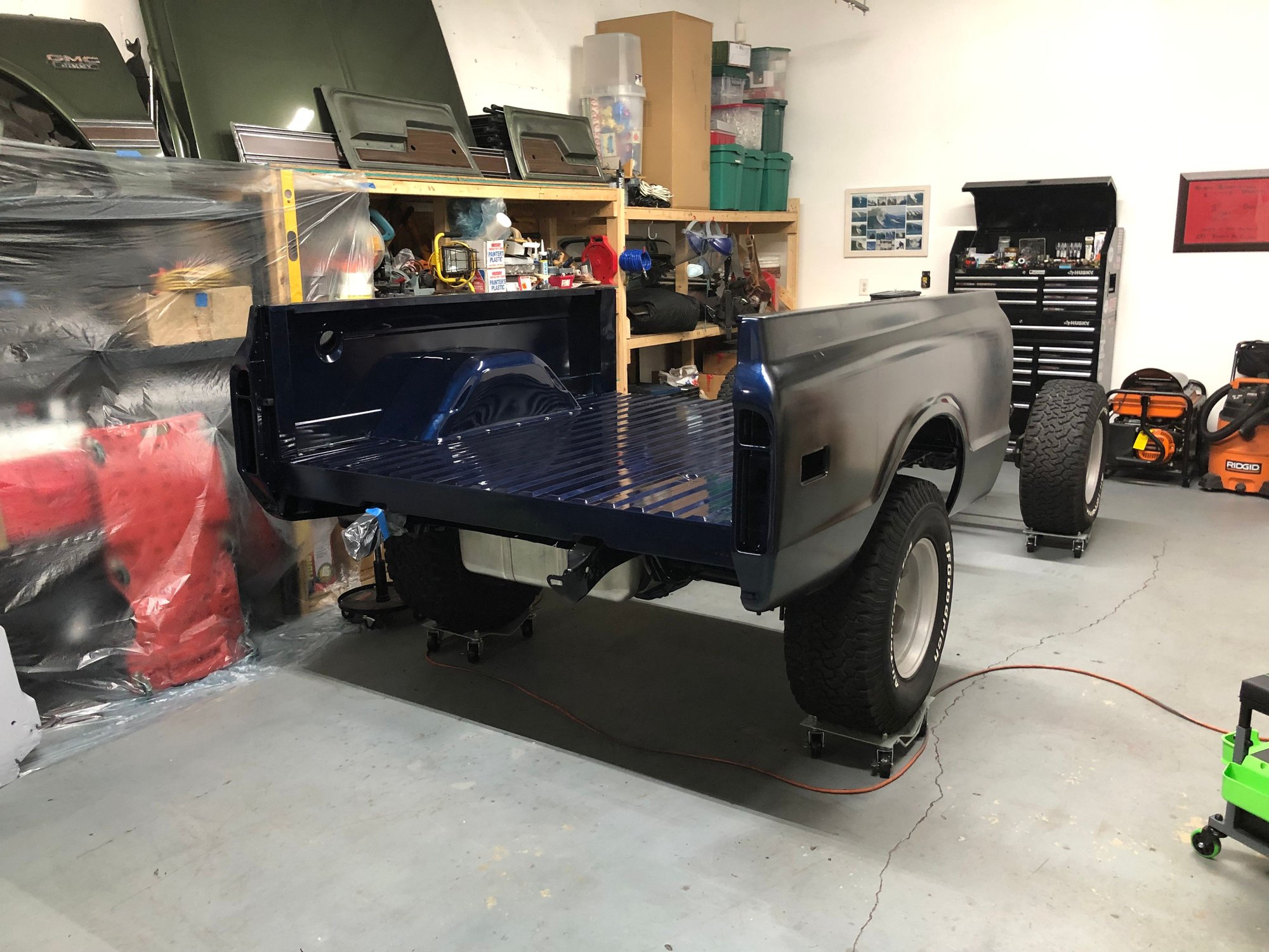

I’m having trouble finding A pillars and vent cowlings. So here’s where I am today
