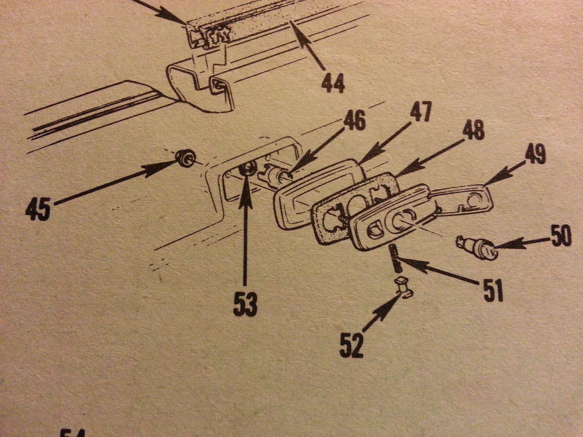

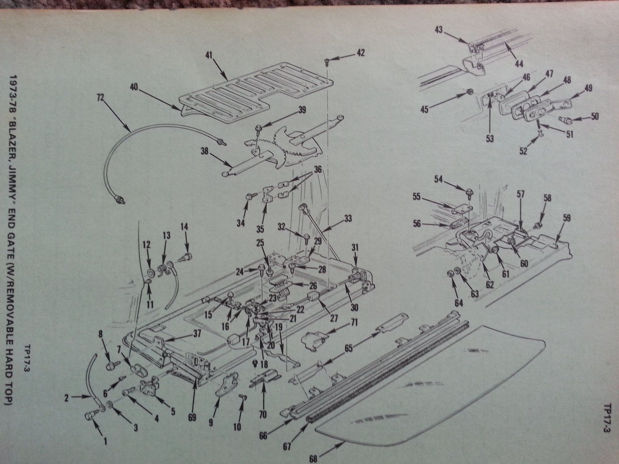

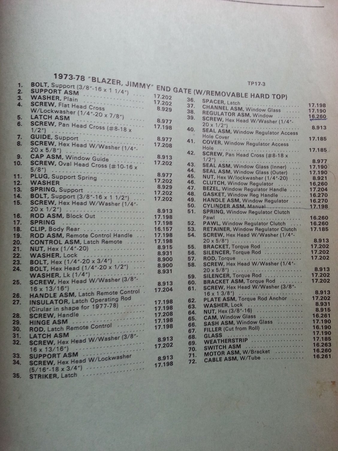

If you can see the bottom of the window, you should see two sets of bolts that hold the tracks (called 'cam' in the factory illustration/parts manual) on the bottom of the window sash These 4 bolts can be removed to disconnect the window from the regulator which should then give you access to remove the regulator & from there the crank assembly.
The two pictures above are for the power rear window option, but the parts I am talking about are shown as items #15 (bolts), #65 (cam or track), and the window assembly would be #66-#68.
The illustration above shows what goes into the factory crank handle. I do not have the part number listing for this illustration handy though.
