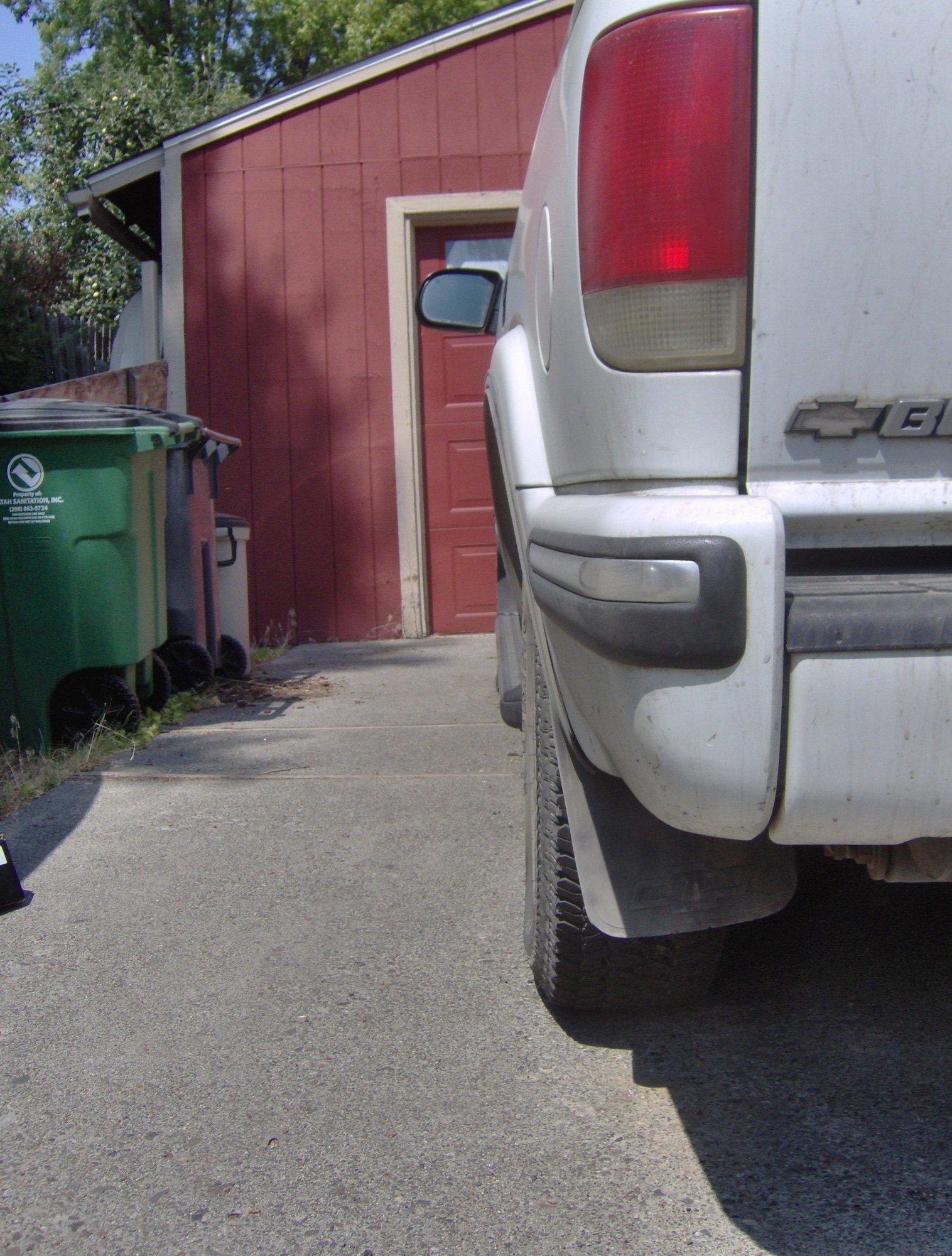

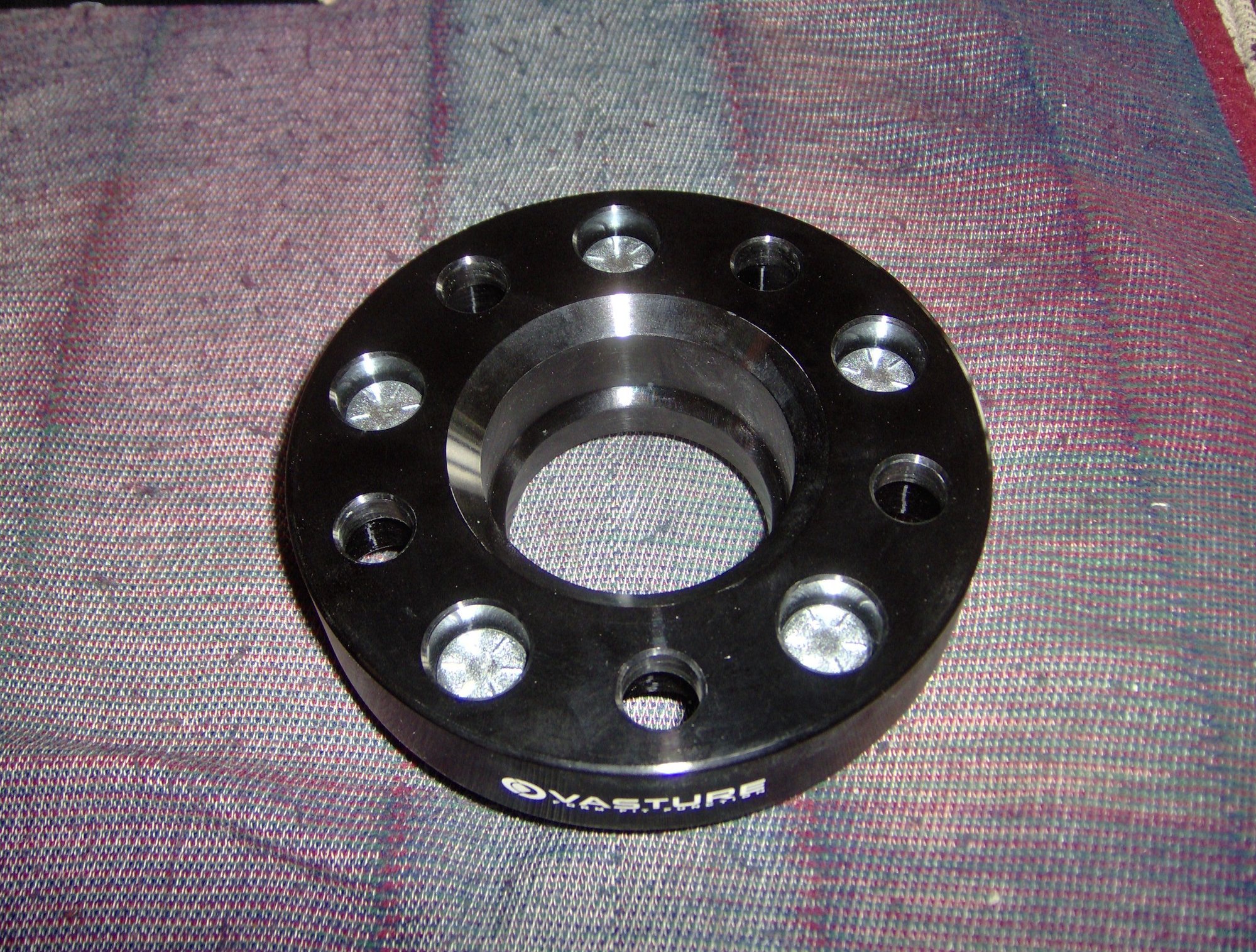

Here are the 1.25" spacers I got of of eBay that arrived today. There are ones that are a bit less expensive (~$30 vs. ~$40) but these are the only ones I found that indicated in the ad that they had an anodized finish. I'll be installing them this weekend when the temperatures are supposed to get down to the 80's instead of today's 105'F!
BTW, the website for this brand looks pretty but it did not take long to figure out the pictures are mostly stock images with gibberish descriptions. Either the person in charge is lazy or the site was never finished or they are just trying to look like a bigger company. However, I still went with them because I liked the idea of an anodized finish.
The stud lengths are 1 5/16" with metric threads (M12 1.5)

I took them for a 20 mile round-trip drive yesterday after my installation to see a friend who lives outside of town in the country. Most is paved with the last bit on gravel. I can't say for sure but I think I was able to feel a bit more stable in the curves. It is a road I've traveled several times at always about the same speed so my thoughts could be more than a "placebo effect." LOL
Here are the before/after pics. (It took several tries to get the after pic close to lined up like the before one.) I think the best reference would be that the rear tires are now flush with the outside of the running board whereas before they were recessed a bit.
Before
After
