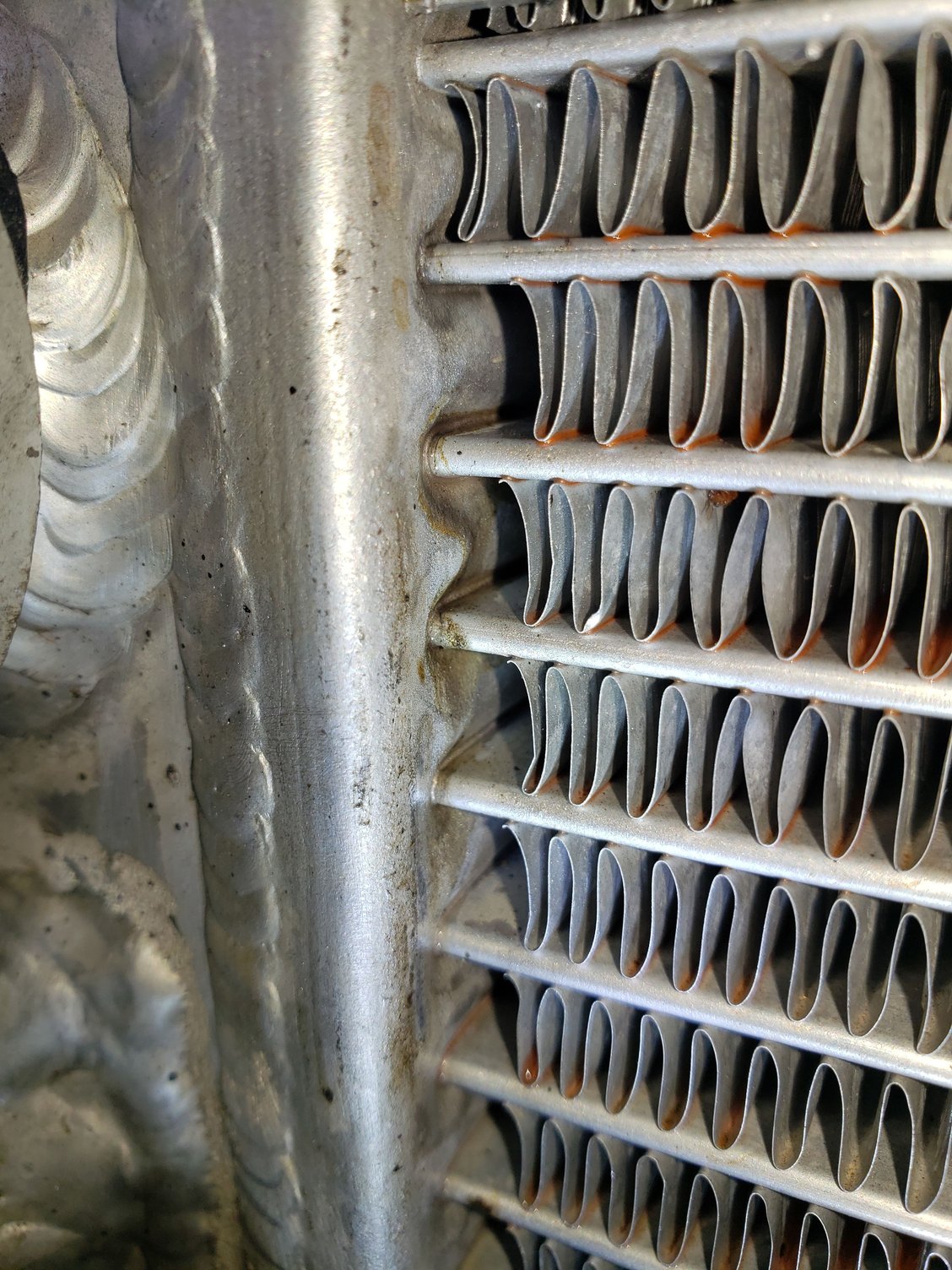

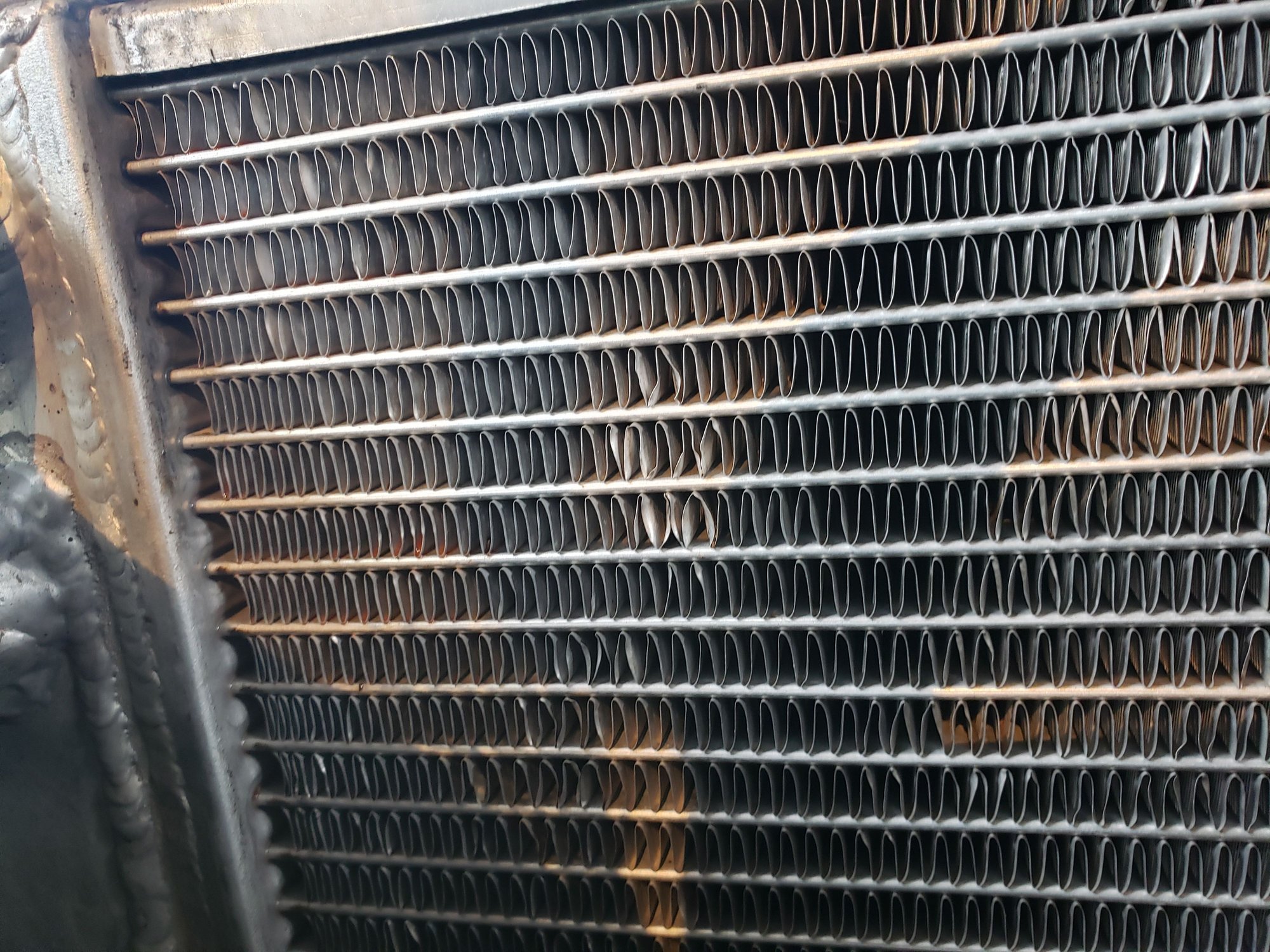

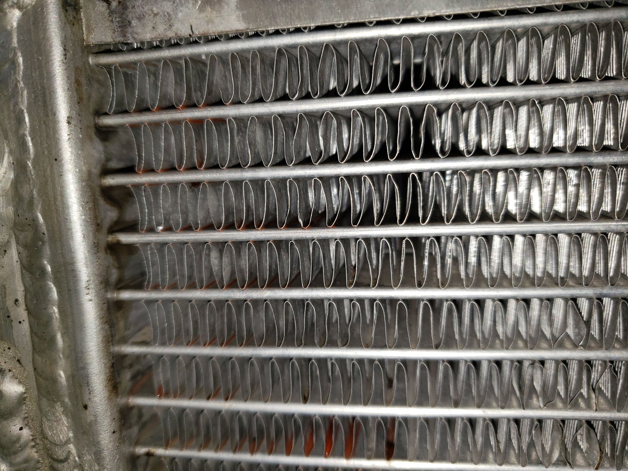

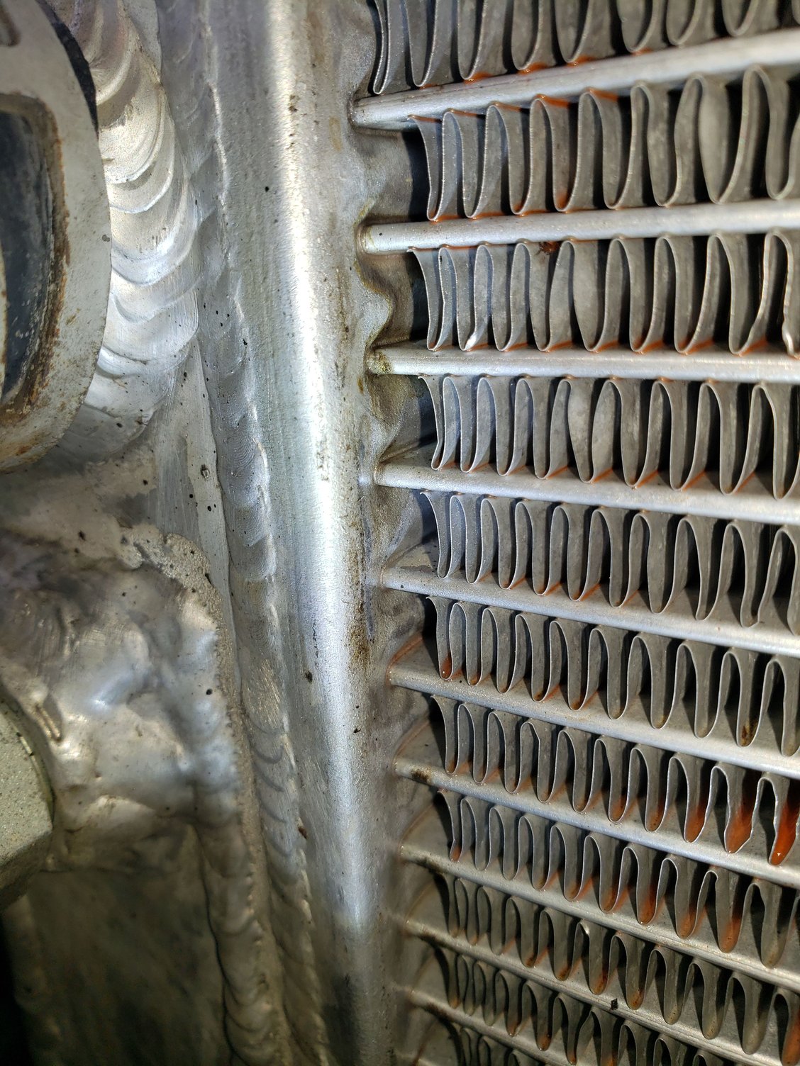

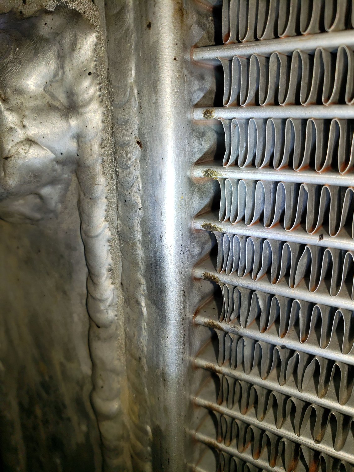

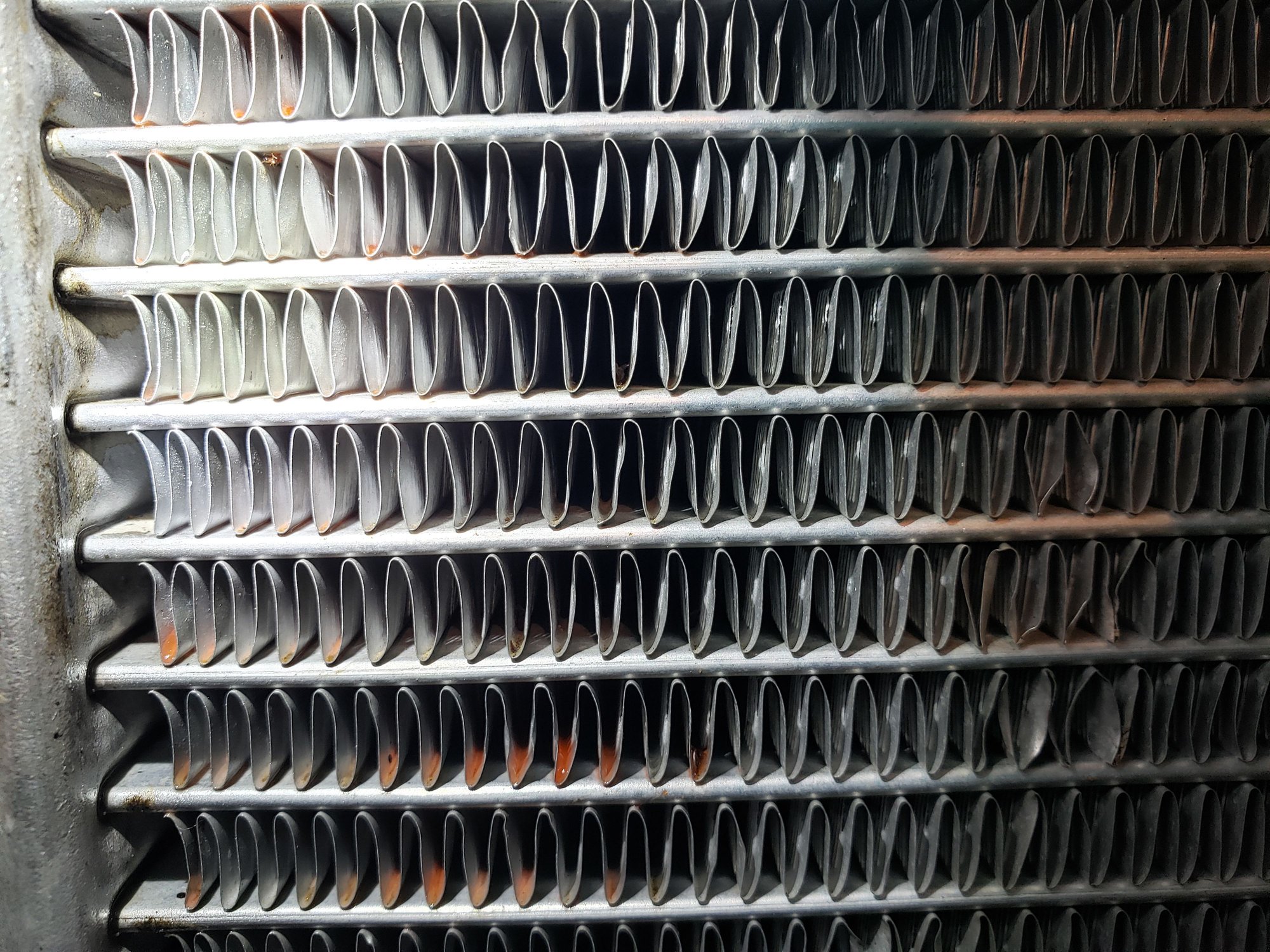

Well I had a dry (but cold) window today to check the radiator. I was not able to do a pressure test but that will be next. Below are pictures that show where the leak appears to be originating. It looks like it could be from where the horizontal flat cooling tubes enter the top of the drivers side side-tank of the radiator. In some of the pictures you can see the welds for where the internal oil cooler were installed that seem to be looking good. The only evidence for the leak to my eyes is the staining of the aluminum where the flat cooling tube enters the side of the side-tank.
Assuming my assessment is correct, I'm now thinking that JB Weld (or similar) is the way to go as I think I could get into the space with a small stainless steel brush and then force in the epoxy to seal where the tubes enter the side-tank.
Any other suggestions for the repair and/or the origin of the leak are welcome.
I will be trying to find the time to swap the cars in my one-car garage so I can do a proper pressure test to confirm the origin of the leak.
Looking down from top and a bit behind.
Looking from behind toward the left (outside). The radiator hose is just out of the picture in the upper left and the welds for the internal oil cooler are on the lower left.
You can see the coolant between some of the cooling fins. There is slight staining of the aluminum where the flat tubes enter the side-tank for the top 6 of them.
Closer view of the top several of the tubes.
Looking at the staining, especially around where the 3rd and 4th of the flat tubes enter the side-tank.
There is some rubbing on the surface of the side-tank between the 5th ad 7th flat tube that is due to the cut-down fan shroud. There doesn't seem to be any damage there but I'll be trimming the fan shroud there to prevent any more wear.
