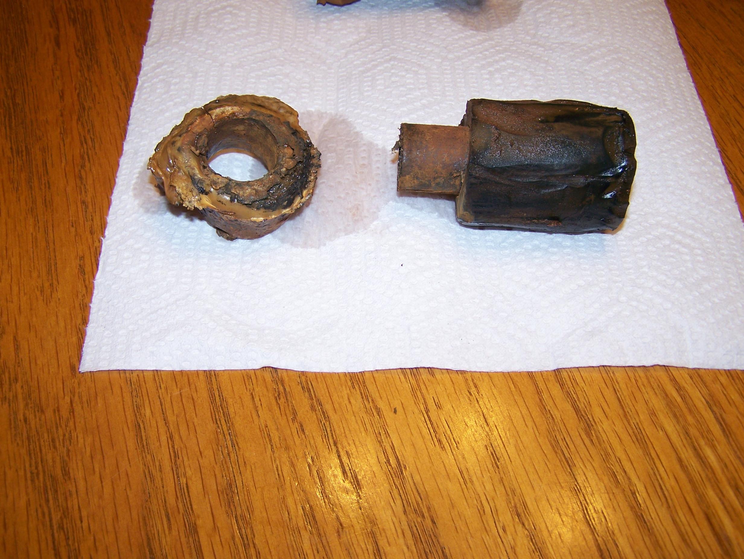

Well it was kind of a crappy day for weather so I didn't get much done. I managed to removed my "rigged" rear leafspring bushings and install the energy suspension set that I have had around for awhile. Then I fixed (read: ripped off) the driver side dust shield for the disc brakes because it kept grinding against the rotor on left hand turns. After that I helped my brother put a new wheel bearing in his cavalier to keep him happy.
I'll show you a few pics of what I had rigged up in the back of my leafsprings...now I know it was ghetto but I was in a rush last year and needed the truck/ the dealer gave me the wrong bushings(I think for the front because they were much larger) so I did what I had to do. I took the larger bushings they gave me and cut off the metal outer casing, then went to town on the rubber with an angle grinder lol. In the end the rubber sucked in on the inner metal sleeve leaving about a half inch gap on one end so I took some super strong urethane and squeezed it in to fill that gap on the one side. Honestly it looks worse then it was and it got the job done and didn't ride that bad, and I don't think it could have harmed anything because it was all sandwiched in the leafspring between each side of the shackle. Fixed now so flame on haha.
