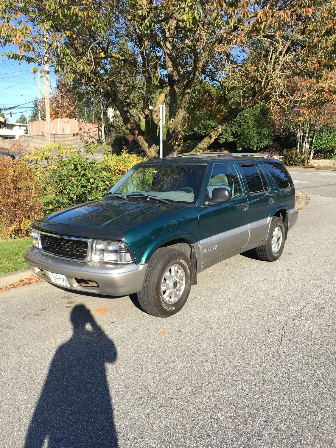

Well it is up and running. I still have to sort the backup switch out on the side of the tranny. But I’m going to get it into MY YARD to sort the small stuff out.
A little heads up, GM does not want to(or can’t) flash the PCM for the auto. I do have the PCM from the manual truck but it would start but not run. So I found out that there is security built into it and there is a ‘relearn’ procedure to perform.
i did this and all is good now. Relearn procedure is easily found on the net.

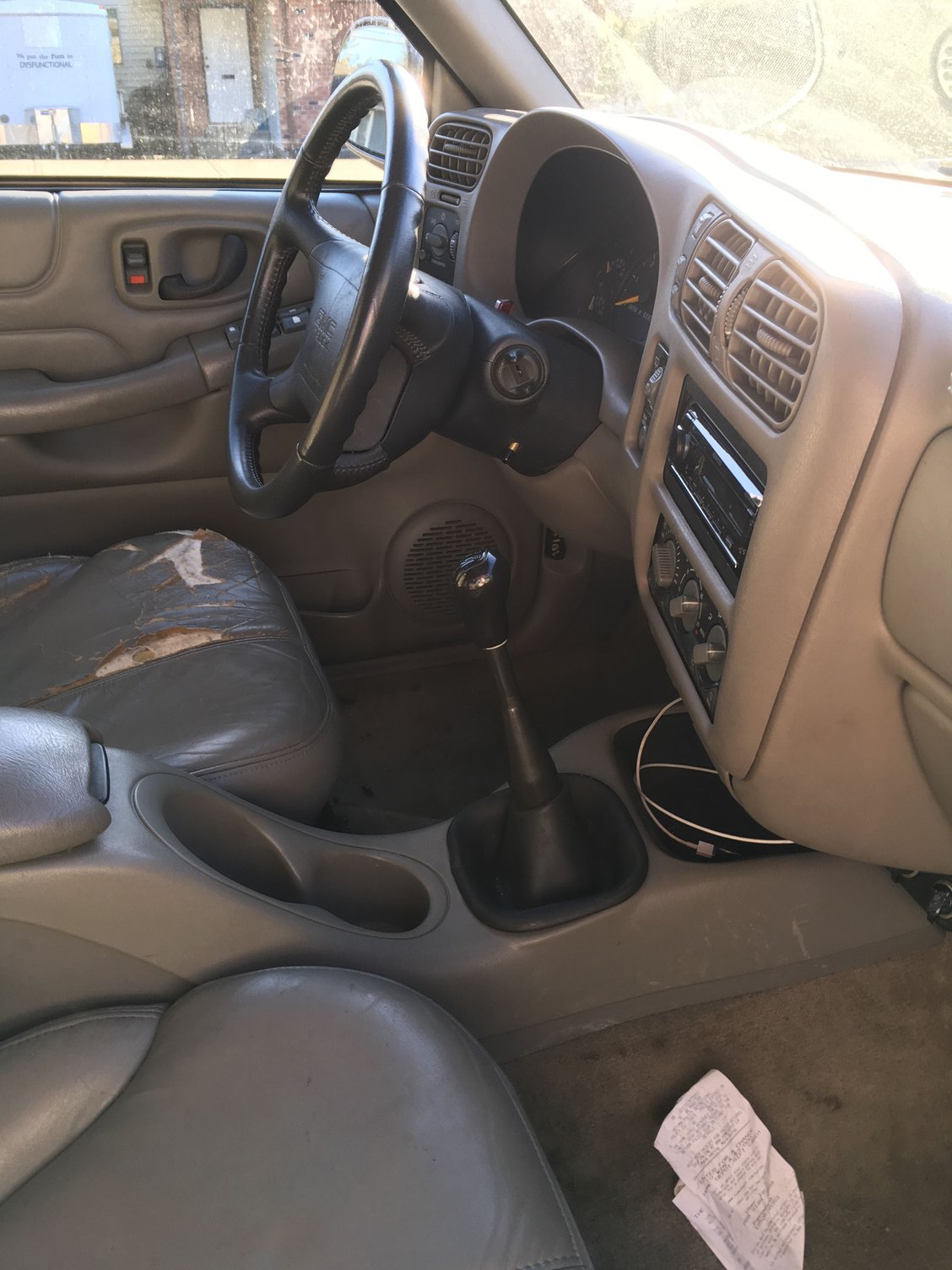

Well there is the interior. It had a console so instead of messing with the key release wires down at the old console I rigged a button release with a tube JB Welded to the backup key release within the steering column.
Just the backup lights for completion but I found the diagrams under ‘Lighting’.

Looks good. I would like to have a standard in my jimmy.
Old Oct 29, 2019 | 06:24 AM
  #35
DonL's Avatar
Joined: Nov 2016
Posts: 3,989
From: Ontario canada
Looks good! I miss my s10 zr2 for the manual shift... I shouldve kept that truck
Old Oct 29, 2019 | 07:50 AM
  #36
Tom A's Avatar
Posts: 2,422
Looks like it came from the factory like that.
