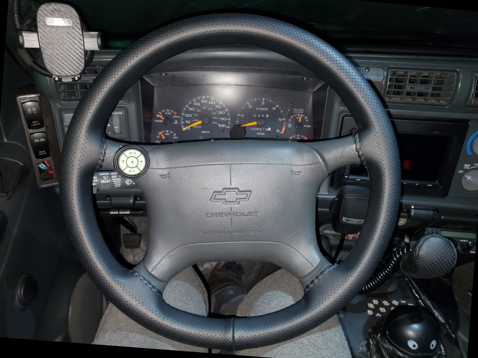

New intrument cluster "calibrated" and put the lens back on. Pretty sure my gas gauge works now, but I'll put miles on him to make sure.
Also put a leather wrap on the steering wheel. I think I ordered a size slightly too big, but it works for me. Now my steering wheel matched my leather shift ****.

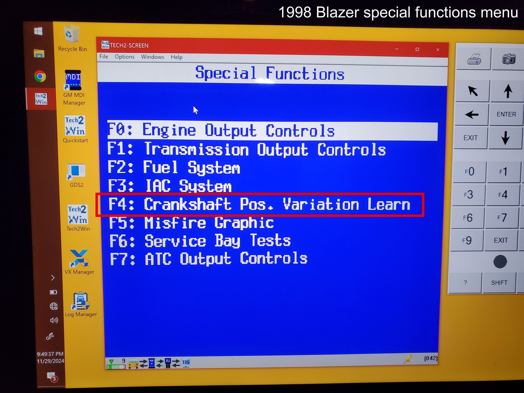

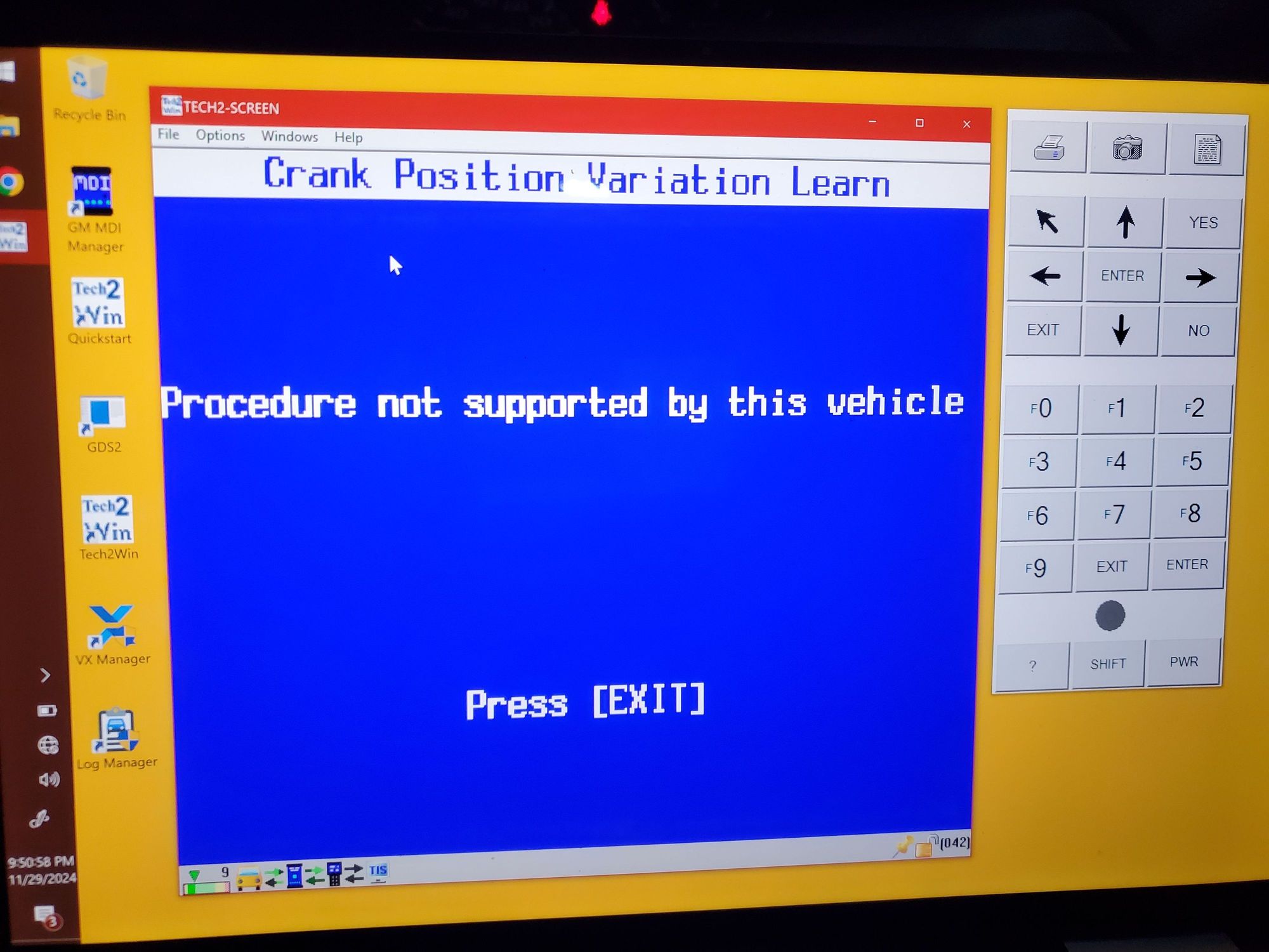

I went to do a crank position variation relearn, but turns out that procedure isn't even supported on the 1997; only 1998 and newer. I wasted a lot of time figuring out what scanners would do that and tried several that said they would. I got annoyed when that option didn't even come up under the 'special functions' list. So using the VCX Nano with Tech2Win, I was curious and entered 1998 instead and the crank relearn option was there. I thought I'd be smart and try to do that procedure, but the program just stated my 1997 doesn't support this procedure. Luckily I got everything on Amazon and I'll just get my money back.
Here's some live data for you all, and proof there's no crank relearn function: https://www.dropbox.com/scl/fi/gx5dt...=78o0q7xm&dl=0
Cam sensor off a little, but shouldn't have to adjust it too much to get it to zero.
1997 Not supported
1997 Not supported

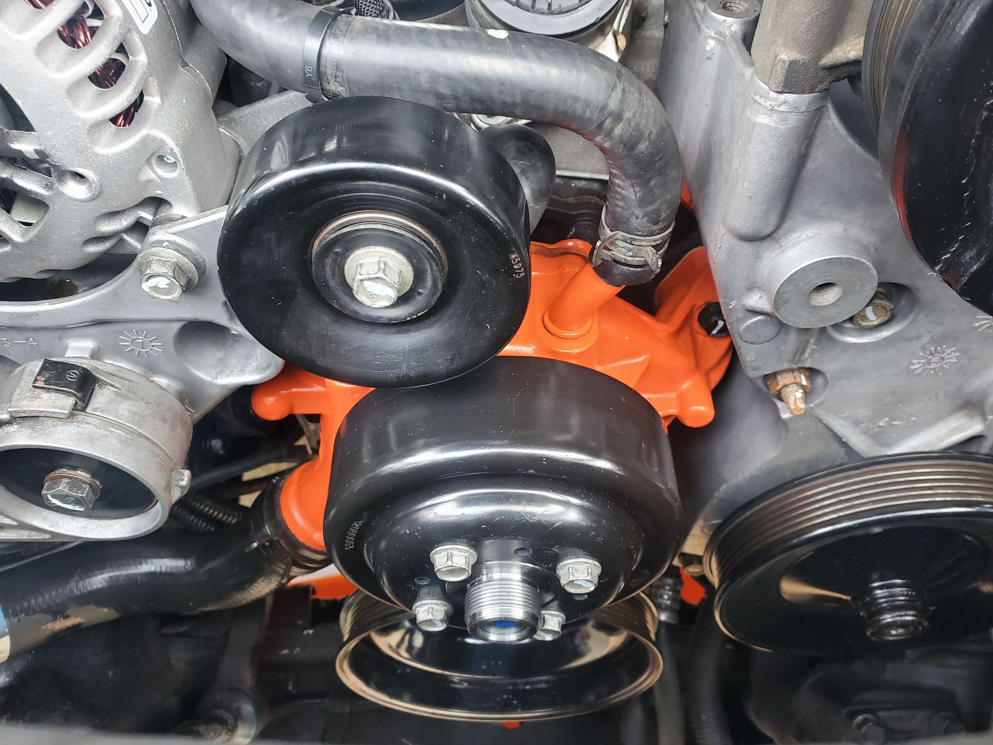

Installed new ACDelco water pump yesterday. Letting the new RTV cure before I add coolant and bleed the system. Will be doing that later today. Hopefully won't be leaking coolant anymore. Then it'll be onto the next project.

New water pump is good to go, no leaks anywhere now.
Adjusted "CKP Retard" as close to 0° as I could without having to remove distributor and making the hole in the mounting bracket bigger to allow for more adjustment. I got it to 1°. That's pretty great. Going for a drive now.
