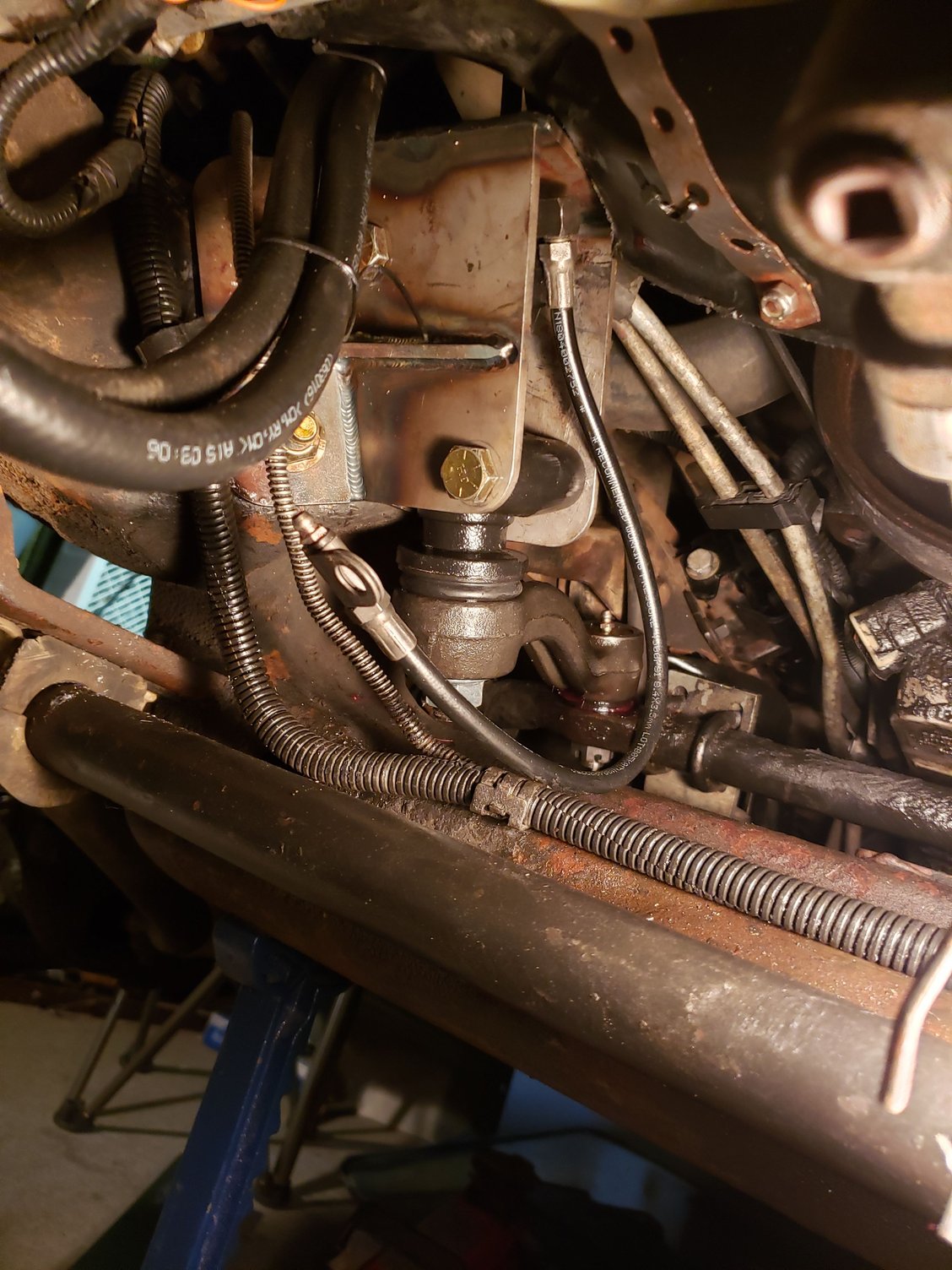

Finished installing a left side motor mount. What a chore. I had to unbolt the transmission mount so I could pivot the engine just a bit more while also lifting the engine with a jack in order to get enough room to finally get the mounting bolts into the engine block.
i had to lift the engine to where the bottom of the exhaust manifold was about equal to the upper shock stud.
I also had to buy a set of ratcheting box-end combination wrenches with fkex heads to be able to get to the lower bolt on the engine mount and the two transmission to transmission mount bolts. I got the GearWrench 90 tooth ones. The 15mm was indispensable!
I take pride in being able to do things myself, but I think I'd pay a shop if it needed to be done again!
i also drained the rear diff only to discover I had the wrong gasket!
I wish there was a diff cover with a drain I could install that didn't cost over $125!
