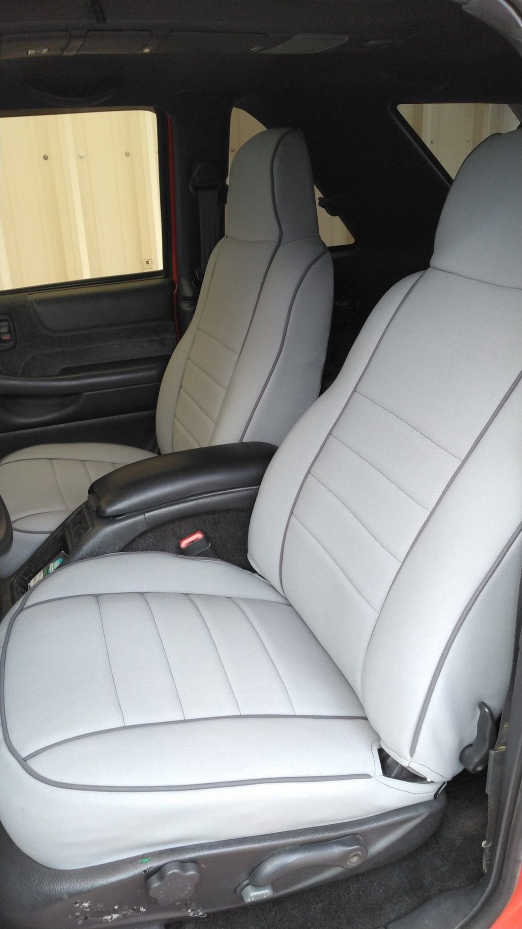

Finished the seat rebuild and cover - they turned out really nice!

They look much lighter in the photo - but they are a nice light gray.

That's really great!

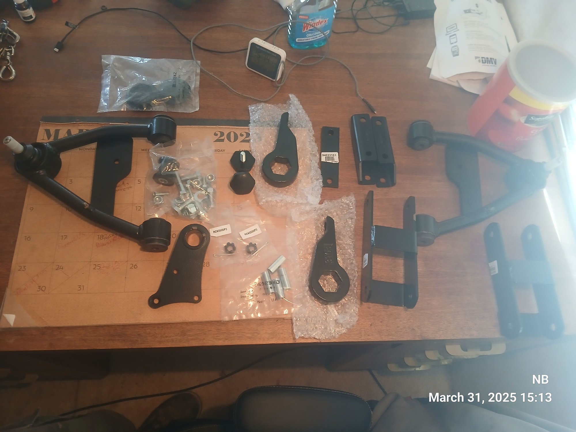

Getting my RC 2.5" lift ready for install.
I think wednesdays the day i finally break down and do it. Have to make my grocery trip tomorrow so that restricts my scheduling.

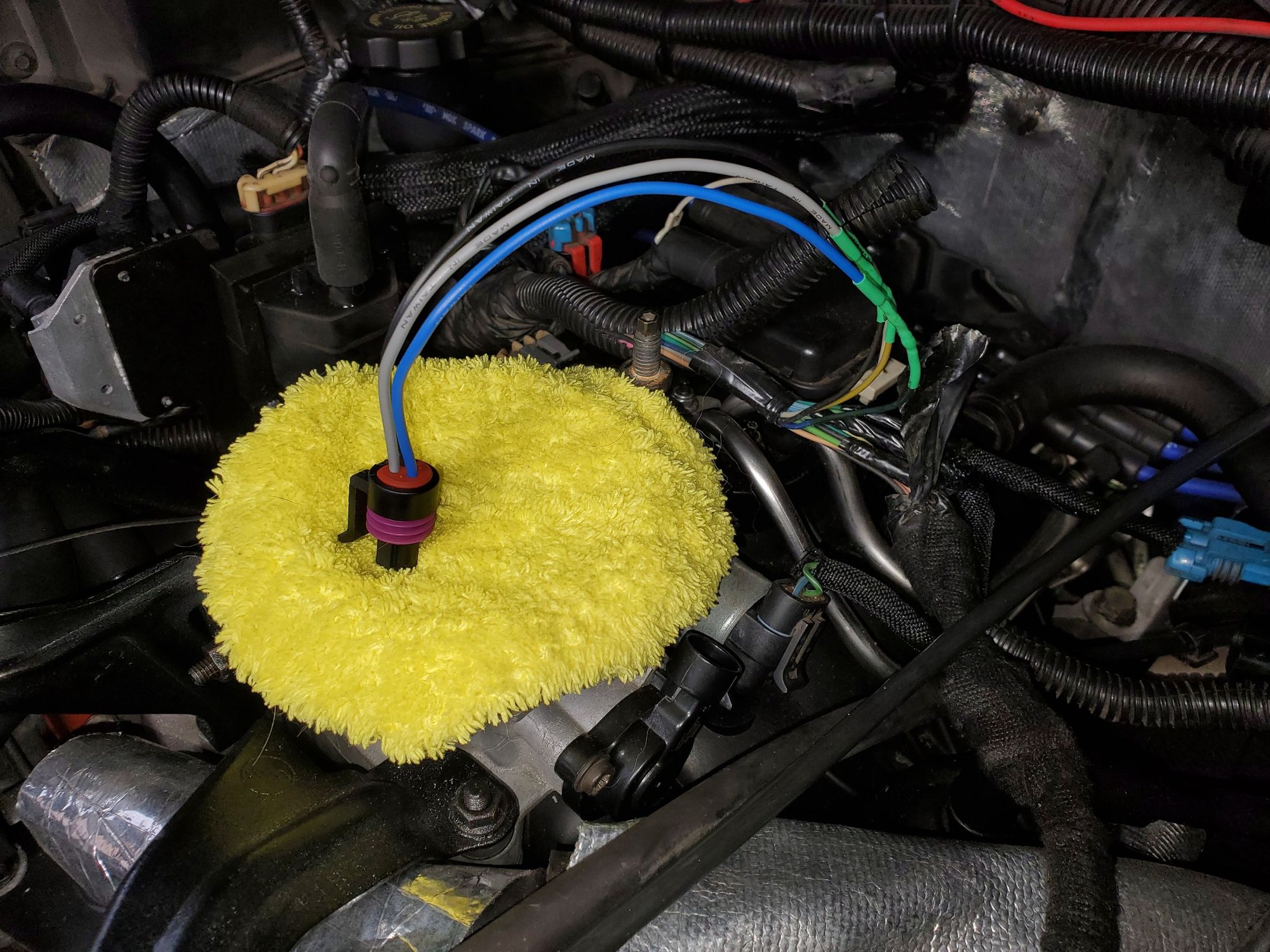

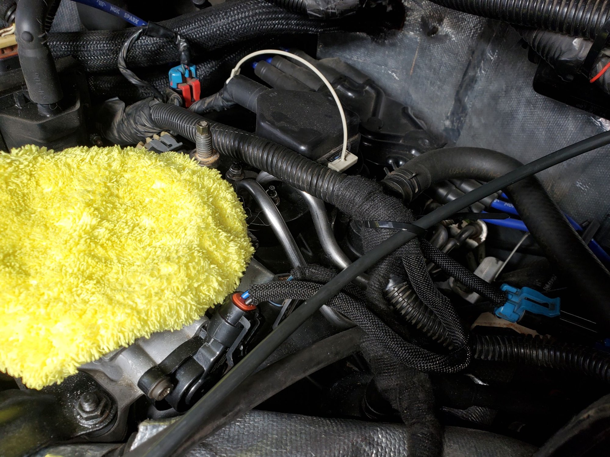

Replaced TPS connector with a new one; figuring that was the issue with getting a P0123 code. Already replaced the sensor with a Delphi one, and the code went away, but then came back after 132 miles. Thought it was the connector because when I wiggled it while plugged into the sensor, the live data showed it was working. I guess the new sensor is bad somehow too. These don't cost a lot, but if the replacement sensor doesn't work then I'll just have to figure it out.
