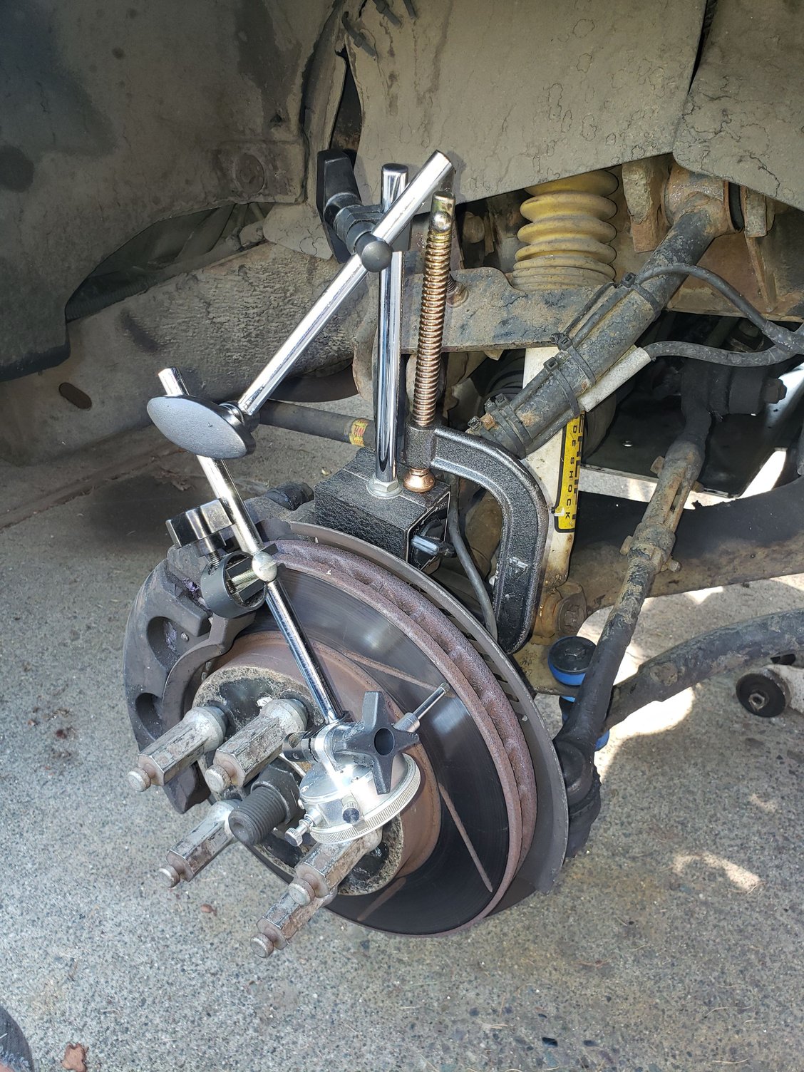

Today in quest of finding the source of vibration at highway speeds I measured the lateral runout of my front brake rotors. One measured 0.0010" and the other 0.0015". These were well within the 0.005" tolerance.
Tomorrow I wiil do the rears.
I also installed new lower control arm bump stops.
Fortunately I found the beginnings of a crack in the inner CV boot on the driver side. It sucks that it is damaged, but at least I know about it
