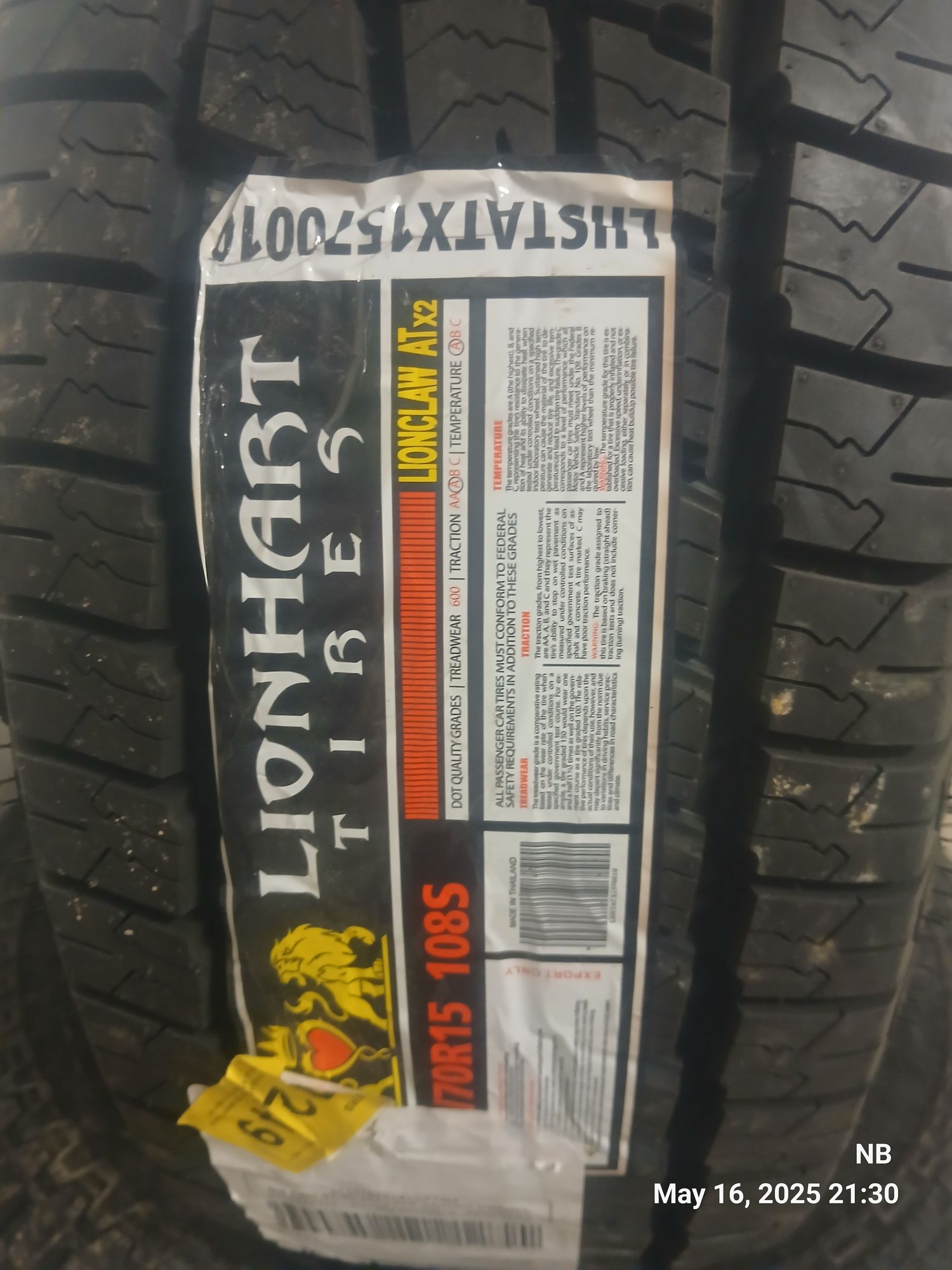

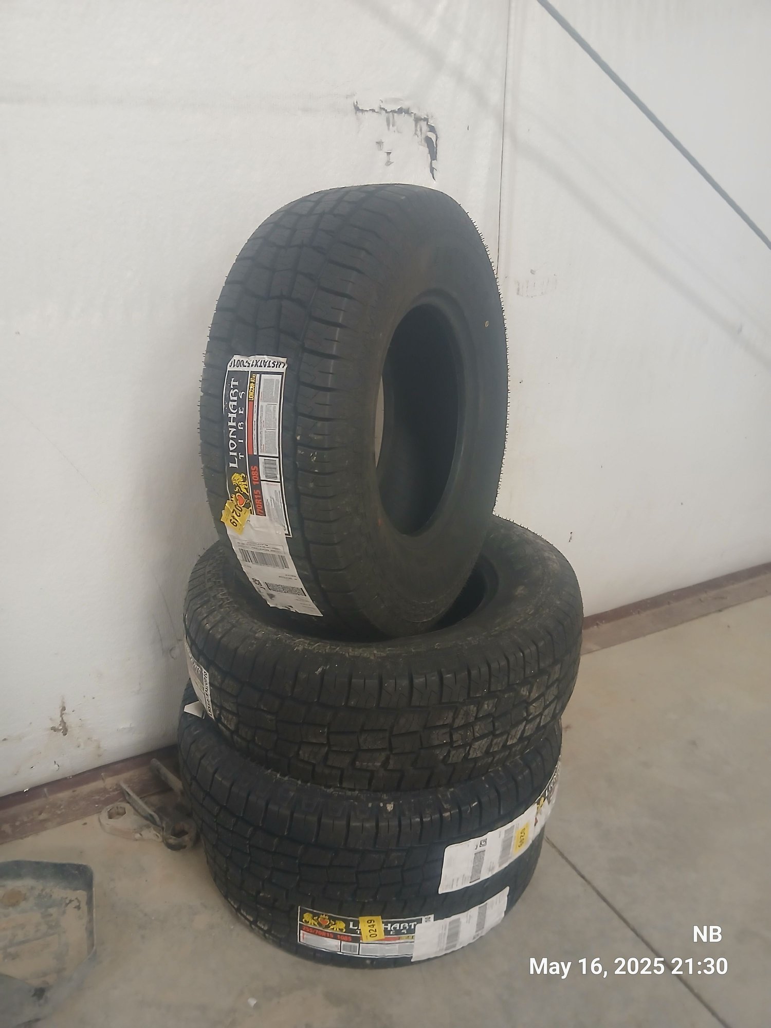

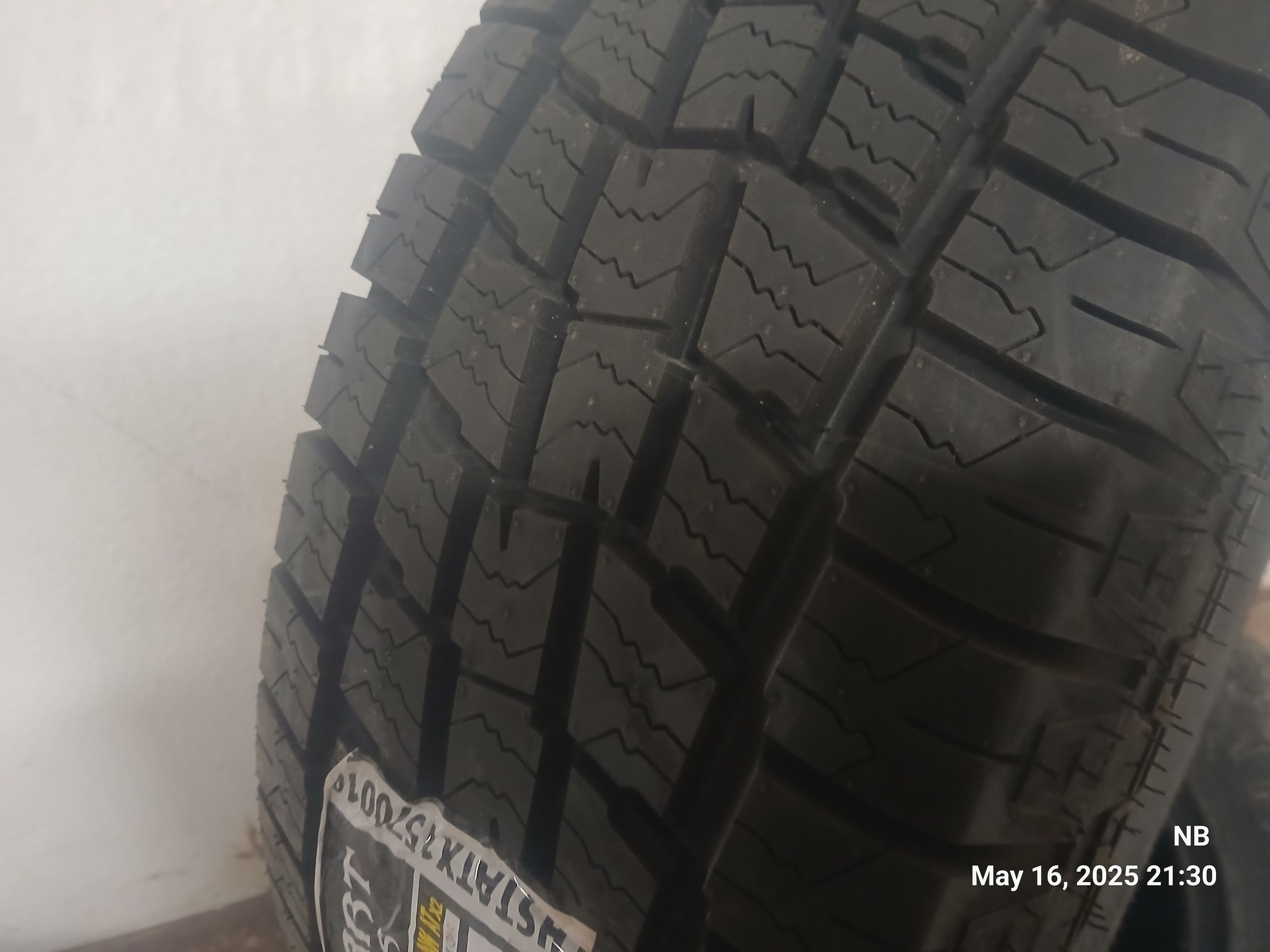

Default New tires ordered
talked my boss into a mounter and balancer for the shop.
So just waiting for it to show.

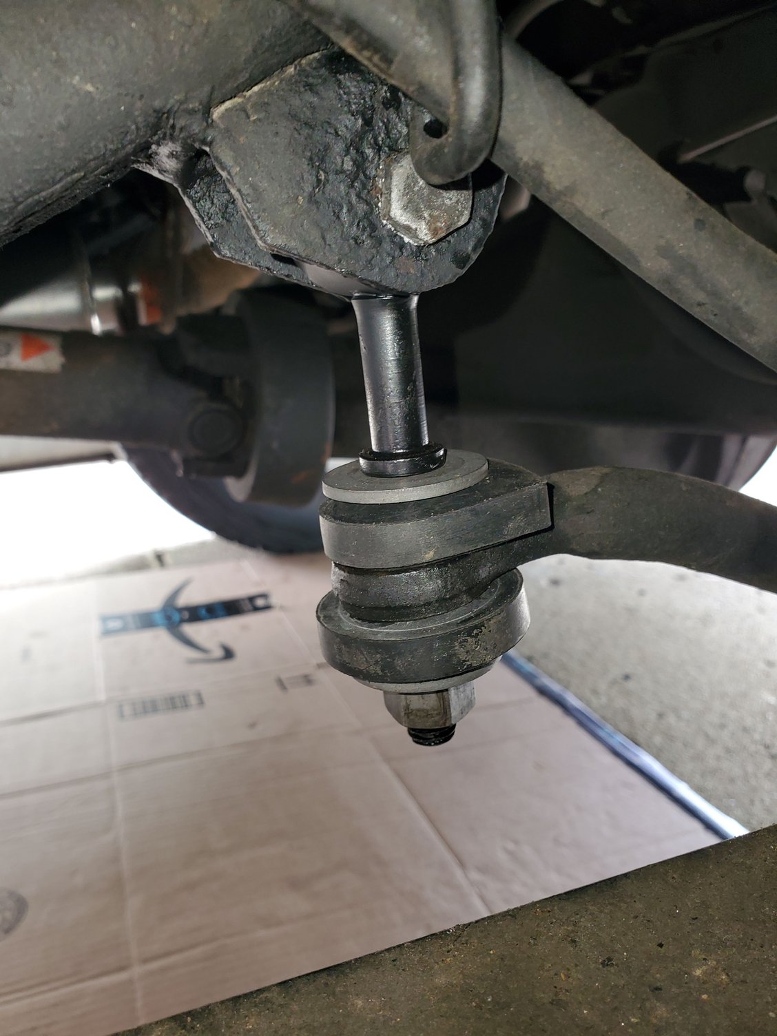

Installed the steering stabilizer, rear sway bar links, front polyurethane sway bar links. Need to upgrade the shocks now and he'll feel like a whole different vehicle.
MOOG K700526 Polyurethane Bushings

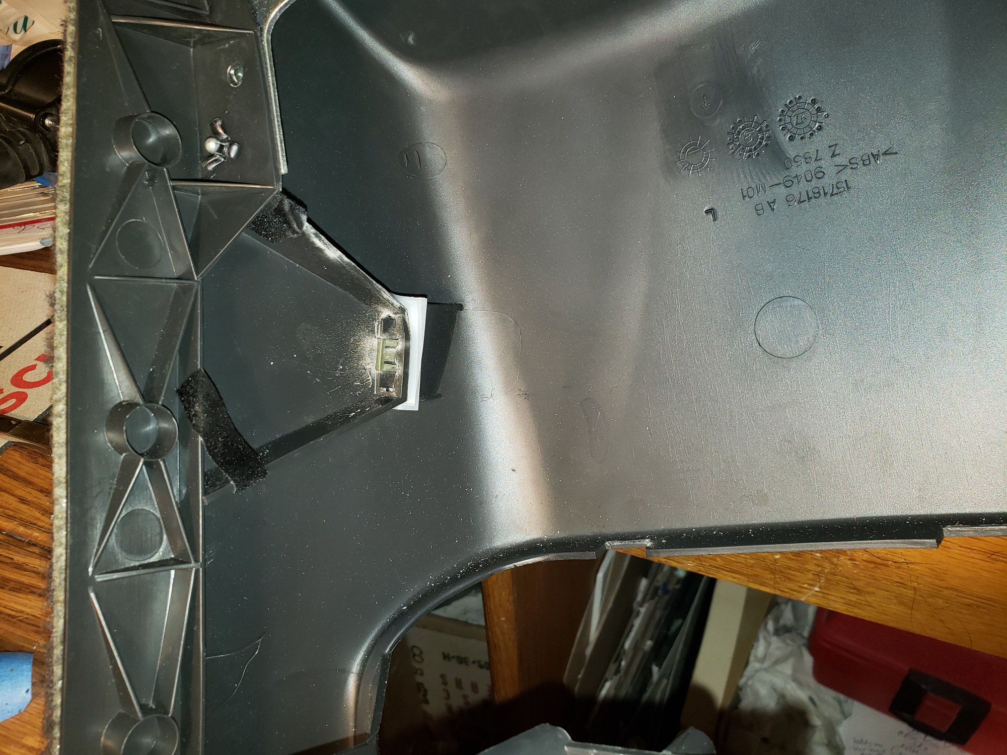

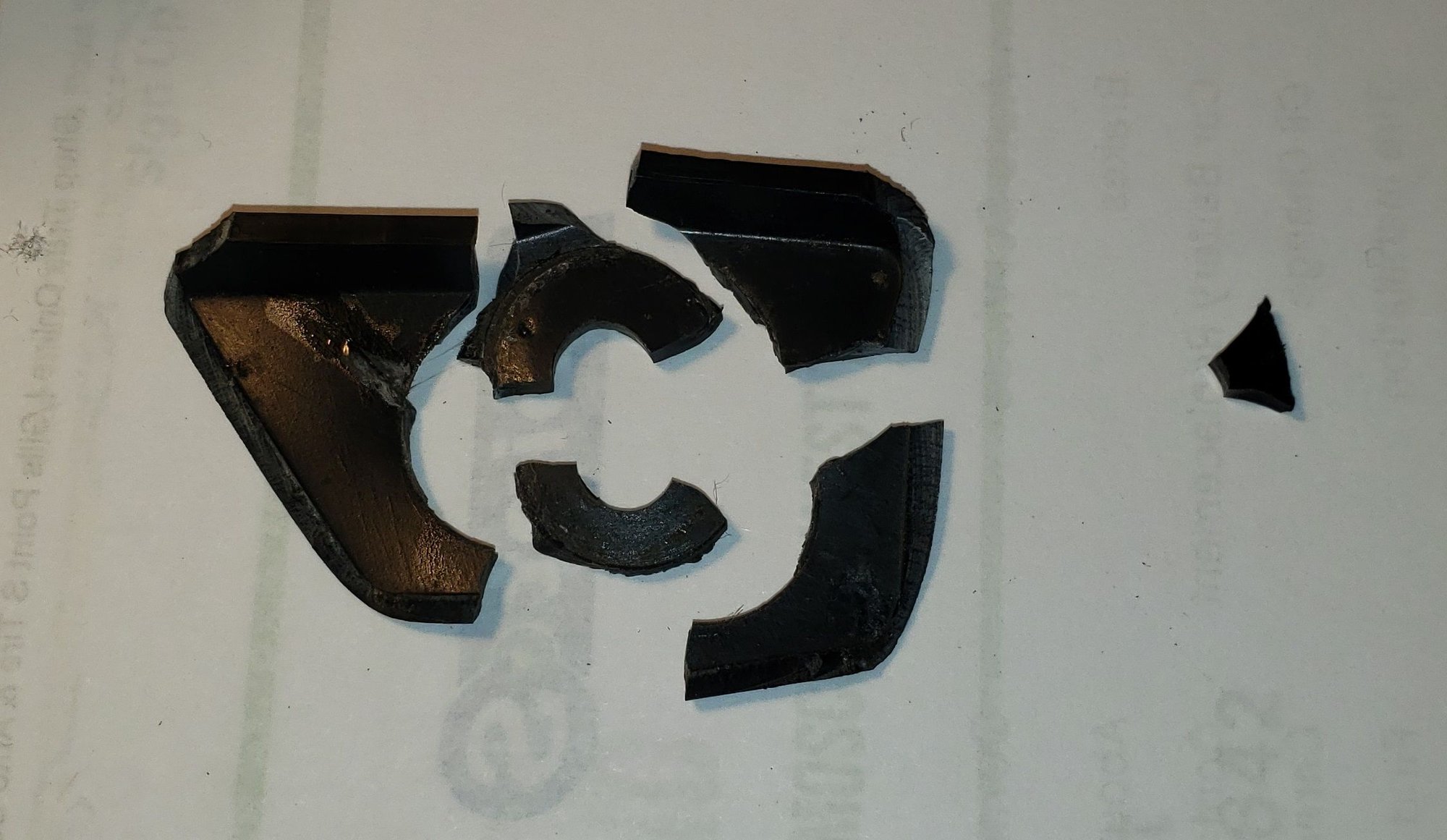

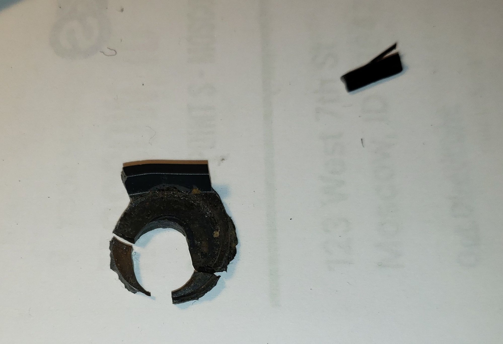

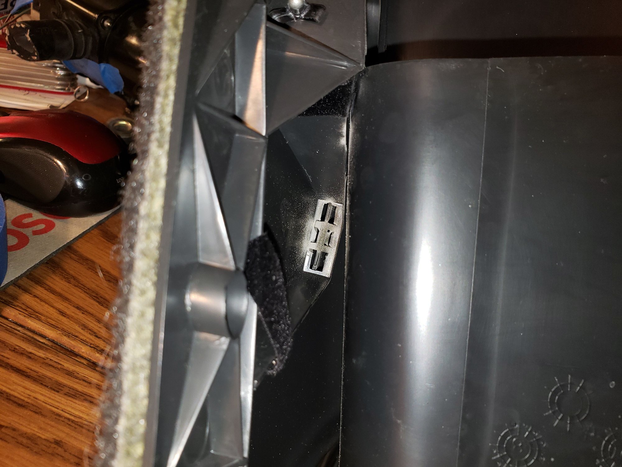

Today I hope I fixed a squeak and rattle in the center console. I found the plastic at the front mounting bolts had shattered. I repaired it using acetone to weld it back together and then added an extra layer of ABS to each of the locations. I also added some polyethylene shims at the attachment points for the skirt on the console.
The broken front foot of the console.
The other broken foot.

The shims that are easier to see  between the skirt and the main part of the console
The other shims (white rectangle) between the skirt and the console.

Good fix. When I had my interior out I was also sick of the rattles, squeaks and creaks from random places of the panels and trims; so I have felt tape and Dual Lock everywhere.

Thanks! I used the same technique to repair the abs of the console lid.
It can also help to make a slury of acetone and plastic shavings to fill gaps.
These repairs are reminders that GM products are not always designed to last 25 years. LOL
