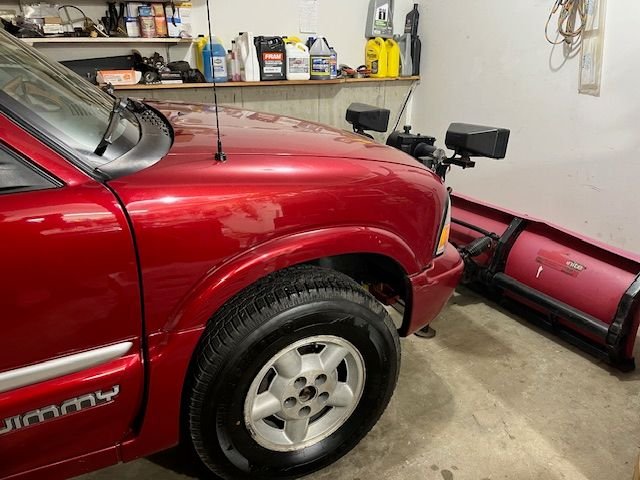

Default put on winter tires and plow
we MIGHT get some snow in ct.

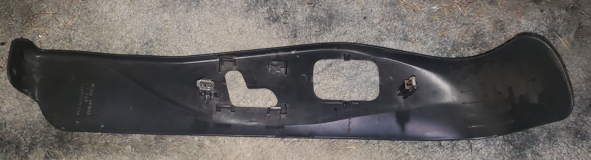

Today I installed a repaired side valance for my drivers side front seat. The tab that held it in place had broken. I had tried to repair it before by welding it with acetone but it was not strong enough. This time after welding the tip back on I created a slurry of shavings of ABS in acetone and added a later of fiberglass. I also added a couple small pieces to the sides to reinforce it. I suspect this was a problem because the service replacement part that GM had for this used screws to hold it in place.
The inside of the whole valance. The repaired tab is the one on the left.
The repaired tab right after I reattached the part that had broken off. The circled area shows where it had broken.
The fully repaired tap with the clip on it. I had also applied a layer of fiberglass over the top of the end and attached/welded it in place with a slurry of ABS dissolved in acetone. You can see on the sides where I also welded on a small strip of more ABS to reinforce the tab.
The fully repaired tab with the clip on it. I had also applied a layer of fiberglass over the top of the end and attached/welded it in place with a slurry of ABS dissolved in acetone. You can see on the sides where I also welded on a small strip of more ABS to reinforce the tab.
