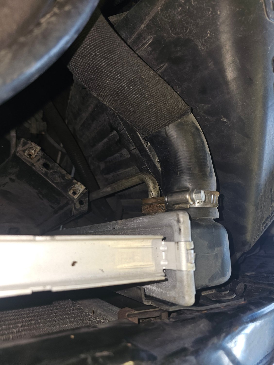

Almost finished installing a new radiator. It is a Champion 4-row one. Still need to install the battery, battery tray, and air inlet box. My one concern is if the air box will fit since the new radiator is about 3/8" thicker front/back than the previous one I had from Engineered Cooling Products.

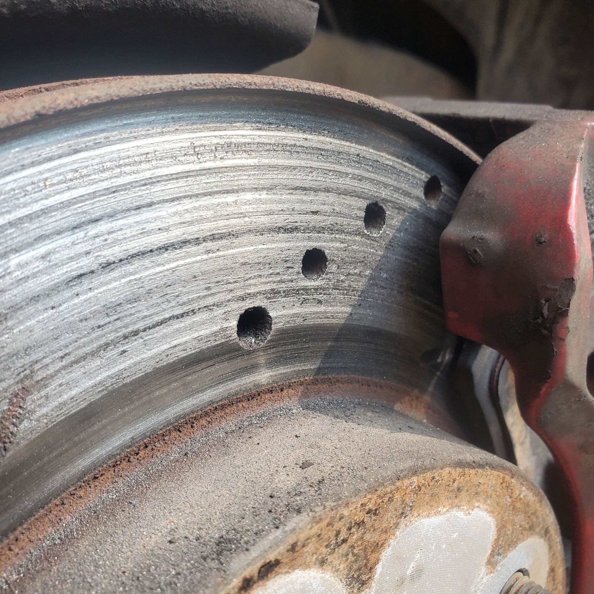

Did the front brakes on my ZR2.
Guess it was about time..lol didn't hear the brakes grinding except at low speed...ABS was firing and locking thrm up. Should have looked sooner.

Today I finished the installation of a Champion 4-row radiator. I also drained and refilled the front dif.
For the radiator, it was a replacement of an Engineered Cooling Products one. The Champion one is 3 1/8" thick front/back at the side tanks, about 3/8" thicker than the ECP one which was thicker than the OEM style.
I kept the original fan and fan shroud that I had previously modified for the ECP radiator. So, this can be done but it is a tight squeeze! I had to do some mods to the air inlet box. The major issue is that with the thicker radiator, the radiator hose and the upper oil-cooler line start to have interference with the box. I was able to make room for the oil-cooler box by using a heat gun to soften the plastic. For the radiator hose and a metal bracket on the other side I had to do some trimming of the lid.
While Im not a fan of cutting on perfectly good parts... if you think you need it, you could probably get away with trimming down the hose. Actually, since I have everything apart replacing a water pump (235k miles so a pretty good run IMO), I dont think its the airbox that will be the biggest issue, its going to be the transmission cooler line. It is RIGHT up on the box. I think its going to come down to if the TANK is 3/8" thicker or just the core. Looks like our core doesnt come close to using all the available depth the end tanks use.
Funny you should mention cutting the hose because I did.
And you are correct about the oil cooler line being an issue. I used a heat gun to soften the plastic of the box to add a dimple for clearance.
I posted pictures of the final installation at my build thread.
The OEM style radiators sure are thin, aren't they?

I'm just glad you were able to use a heat gun and clearance the box enough for the hard line, the radiator hose had enough wiggle room that I was pretty sure a half inch chop would probably improve things clearance-wise. As fast as the stock radiator... yeah, I was looking at how thin it was while I dribbled sweat all over everything in this Texas heat! If I hadn't already replaced it a little over a year ago, I'd be looking at a multi core myself! The current overheating is certainly related to the water pump (leaking almost as bad as my forehead) and I'm crossing my fingers that the new pump (O.E. new and not one of the rebuilds) is the final piece. Well, I guess it should be since it really is! New heater core several years ago, all heater and radiator hoses replaced, thermostat and radiator replaced, the pump itself was the last thing except the fan clutch (which I verified the mfg date code on the fan blades of sept 1998 today!) is the last of the original cooling system. Now that I've said it out loud, the overflow tank will probably crack! 😂
