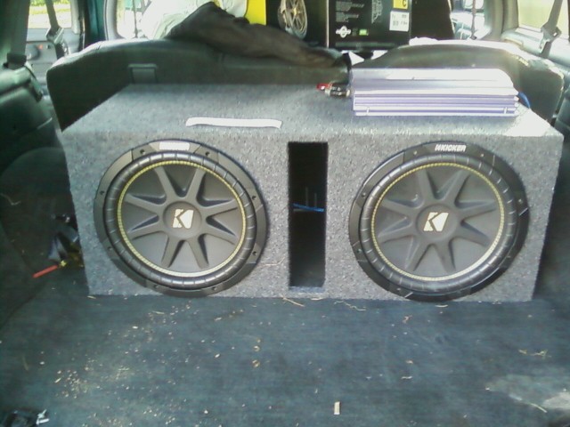

put in new RCA wires and my subs also hooked up an old amp....then cooked my old amp...now im looking for something newer ...think a 1500 watt kicker amp lol
yes my trucks alittle dirty lol
