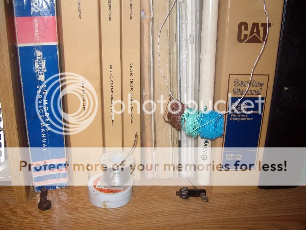

lol if you look by my s10 service manual you see one of the manifold bolts

something that i do when i break bolts off in cast metal is weld a washer to the broken bolt and than weld a nut to the washer and inside the nut. the heat generated from welding usualy is enough to break it free works about 85% of the time something to keep in mind for next time.
