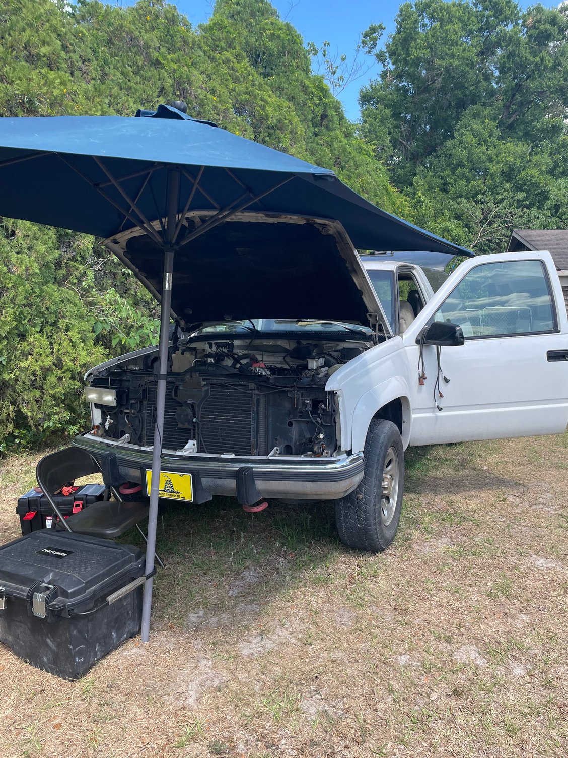

I have a 1994 Blazer 4x4, one day a couple months ago out of nowhere the ECM ignition fuse just started blowing so I kept changing it out with a new one the fuse I’m speaking on and it kept doing it so I started going through things under the hood and noticed that there was somewhere in tow where why is where actually showing on the ignition connectors so I replace those. It was good for about a week maybe a week and a half and then it started blowing again luckily, I was not far from a relatives house so I got it now, and I’ve been working on it cents. And to make it worse now it has a no crank, no start. So from now on a stone, checking other wires checked the ignition distributor and then went under the driver side dash and the wires were a gaggle. **** I’m in the process of fixing that mess and now I feel all that the key is stuck in the ignition, and it won’t go back to off! If there’s anyone that can give me some pointers one thing I didn’t check was the ignition control module. I still have to do some research on where it exactly is on this truck. As for the pictures that I’m going to attach to this, this is what I mean by gaggle **** people just wing it the hell up then what they had to and left it so now after I’ve bought the thing 2 1/half three years ago it’s starting to have issues, and some of this is the reason why and it’s like really Simons pretty easy, I mean shoot if you don’t know how to do it, YouTube it.
