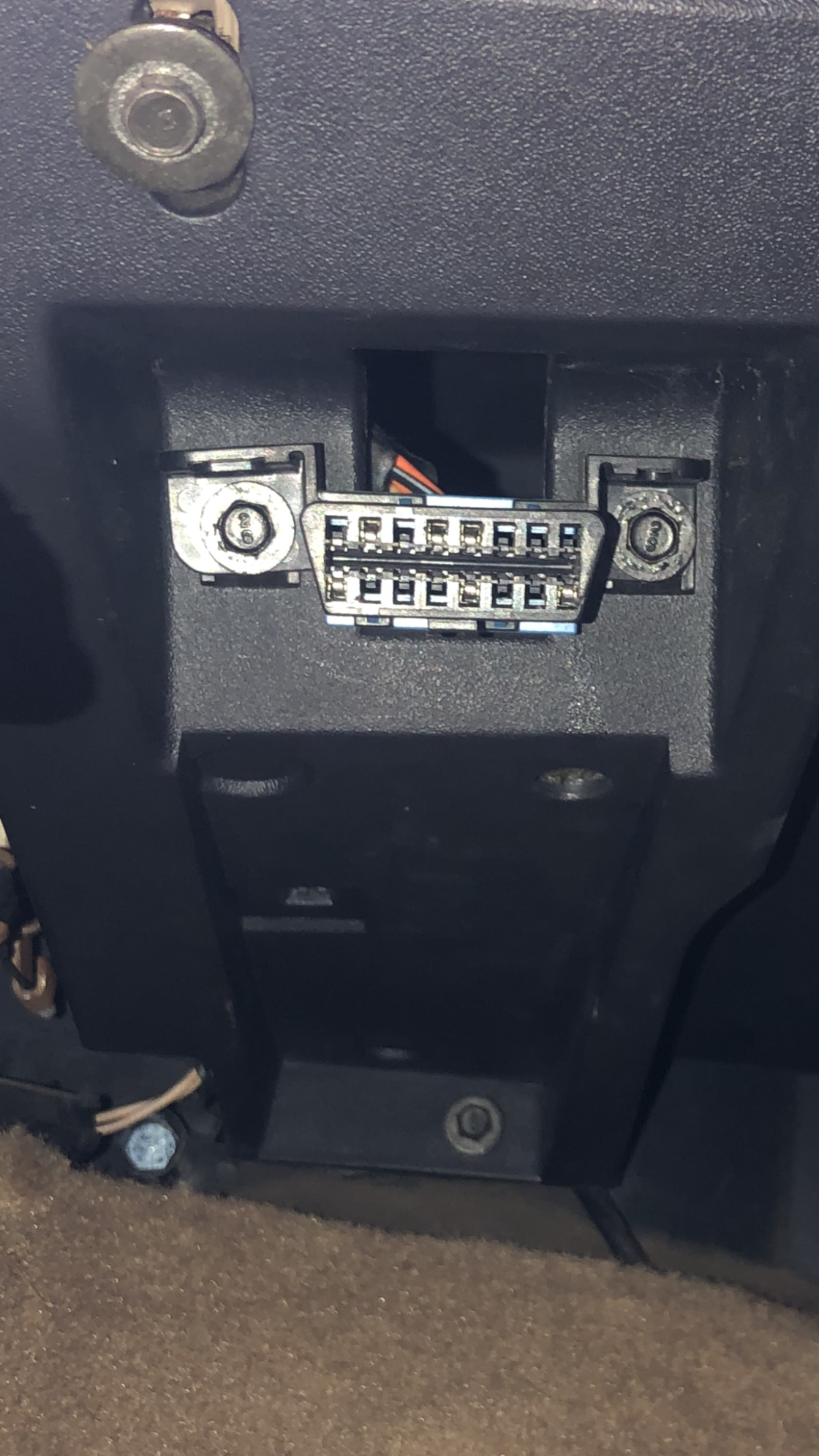

my connector does NOT have a pin in slot 4.
my Innova 3020b scanner won’t read the codes it says error, so I assume it’s OBD 1.5, ....
without a pin in slot 4, and no keyed power to slot 2, how do I read the codes?
10/94 build date, computer under hood on passenger fender, obd2 connector under left side of dash.
help??

Pin 5 is a gnd along with pin 4 so you can use pin 5 instead. Pin 2 is a data line, not power.

Place the jumper wire in pin 2 and 4
Hello Rusty, I have the same issue. Doing this won't cause any circuit on the computer or something? I have a 93 S10 and i scan it with a jumper wire in pin 4 and 6, but this other Chevy I've got doesn't have a 6th pin. Only 2-4-5-9-13 and 16.
