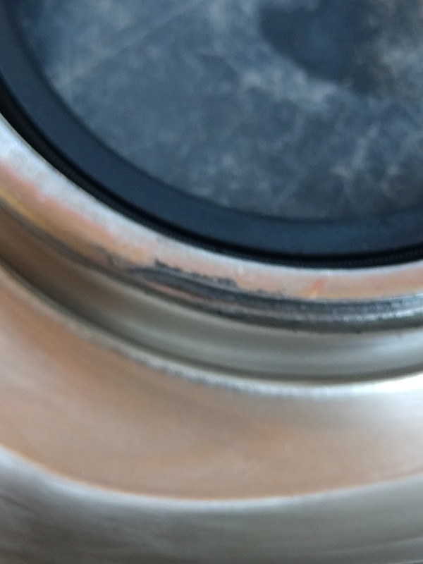

So this project has taken way to much of my time! I built the engine over the winter, 383 stroker with summit aluminum heads. The engine build went smoothly other than putting straight plug headers on angle plug heads. The install kicked my butt. I used to pull a motor and install the new one and have it running in a day. This one one took me almost 2 full weekends. Once we had it in and fired up there was a mystery noise that I could not find! I spent the next week chasing this noise. We finally figured it had to be coming from the timing chain cover. Tore the front of the engine down and sure enough it was the cheep chrome cover. The chain was touching every so often.
Swapped covers and all is well. So now my brother has his truck back and I can put more time towards my Jimmy.
