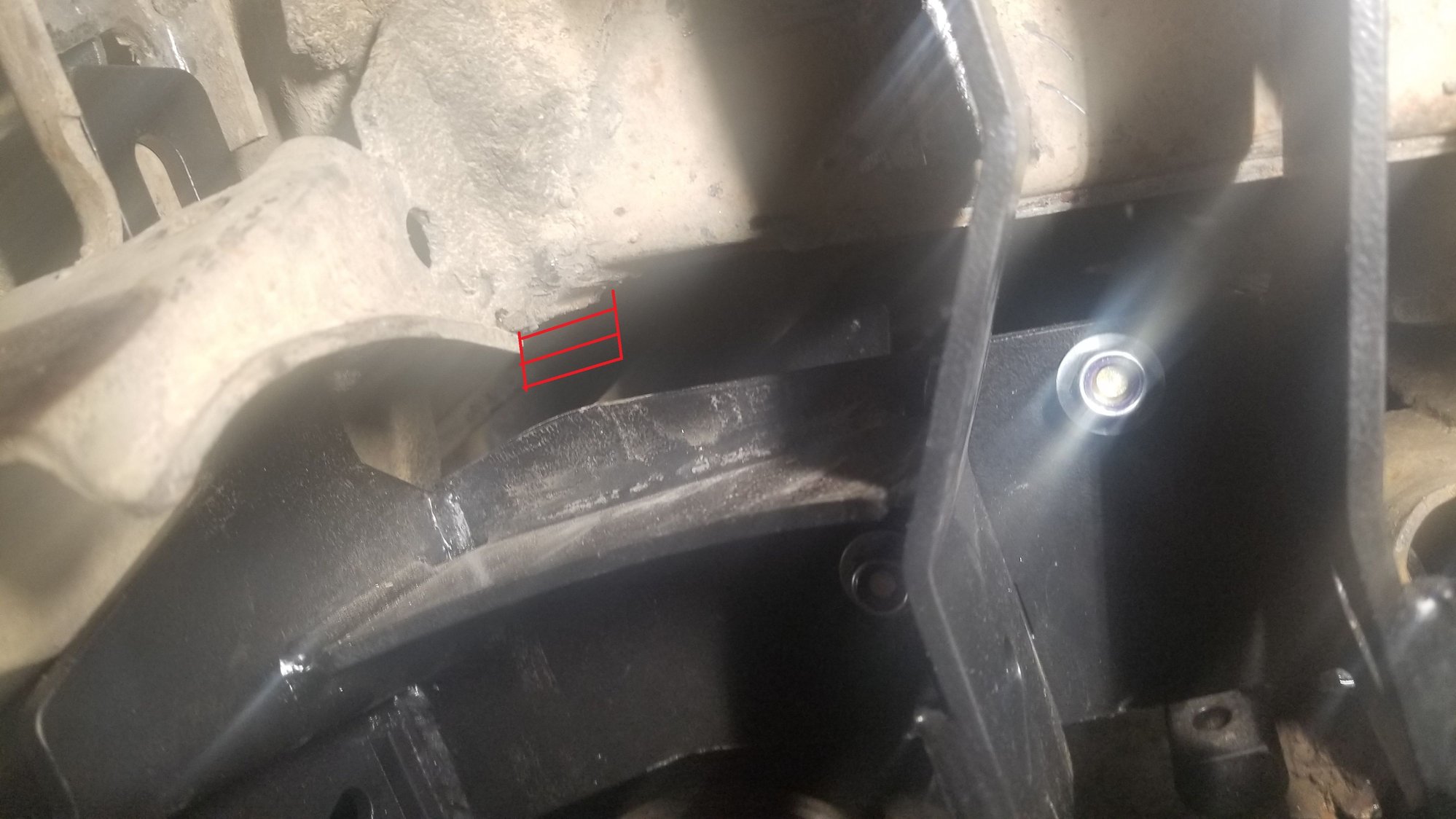

Before installing the rear lower control arm cross member, you have to cut on the driver side "pocket." Basically, your're cutting off the old lower diff bracket. Here's the cross member installed:
It's hard to tell from the pic, but that drop bracket is super tight to the diff. That's the reason the fins need to be cut. If anyone reading this installs a kit themselves, be very careful cutting those fins! Get a stack of aluminum grinding wheels, and go slow. It'll take longer, but do you want a jb weld differential houising?

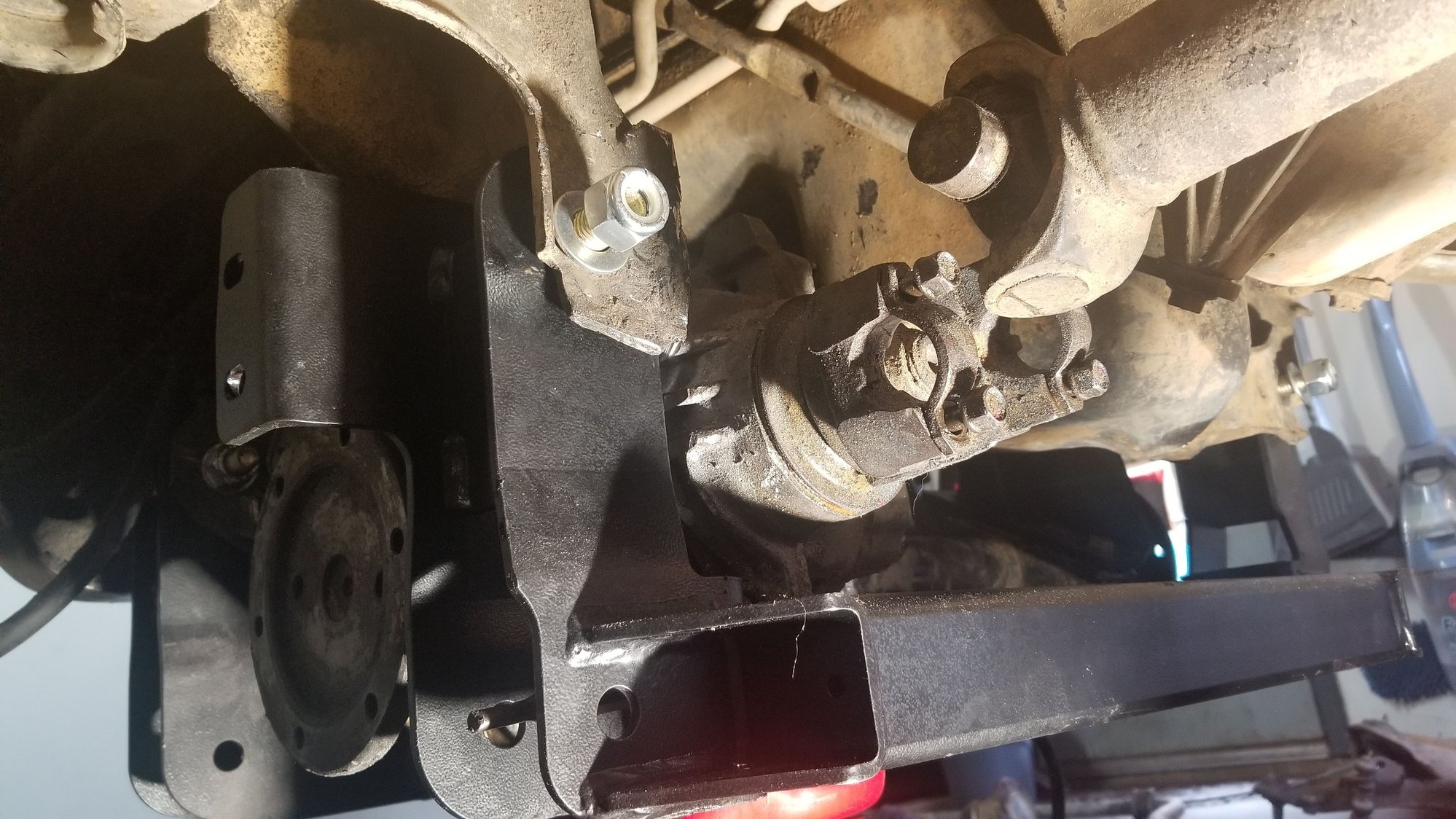

Here's a pic of the diff installed:
Anyone who has this kit has zero excuses to have leaking oil lines! They're very easy to get to with the diff dropped 6". You could probably remove the adapter and lines altogether, and just run a filter on the block, if you wanted to. You would lose the oil cooler, though.

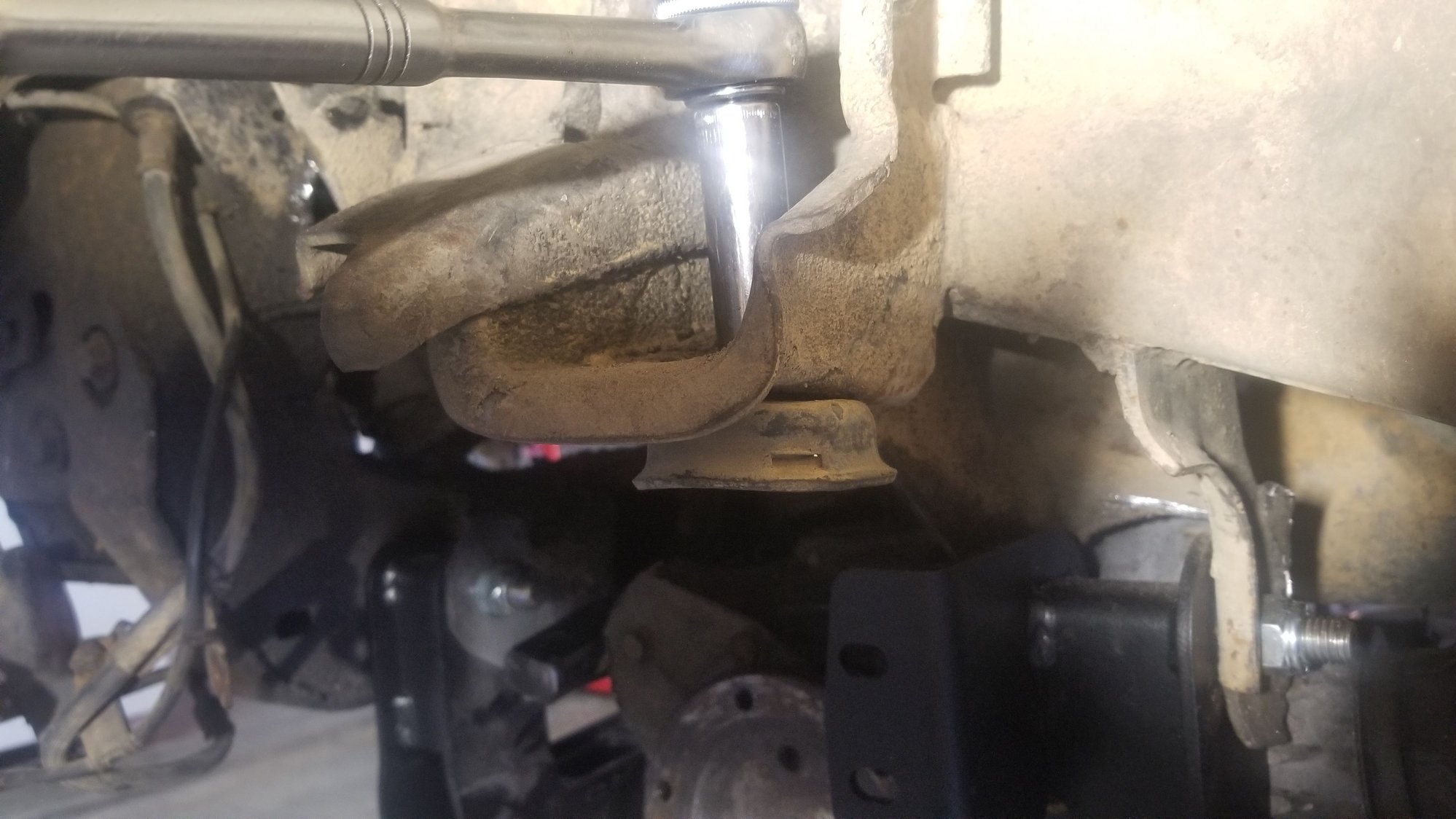

The other spot was from the steering center link to the diff. From center turning left, it would rub. I ended up grinding some off the new center link, and as much as I felt comfortable on the diff:
This pic shows the clearance I was able to get. I didn't want to grind more on the diff, as I was getting into a gasket surface. I could honestly have probably gone deeper on the diff, but I'm now leery of leaks lol. There's always daylight visible between them, so I'm going to leave it like is.
