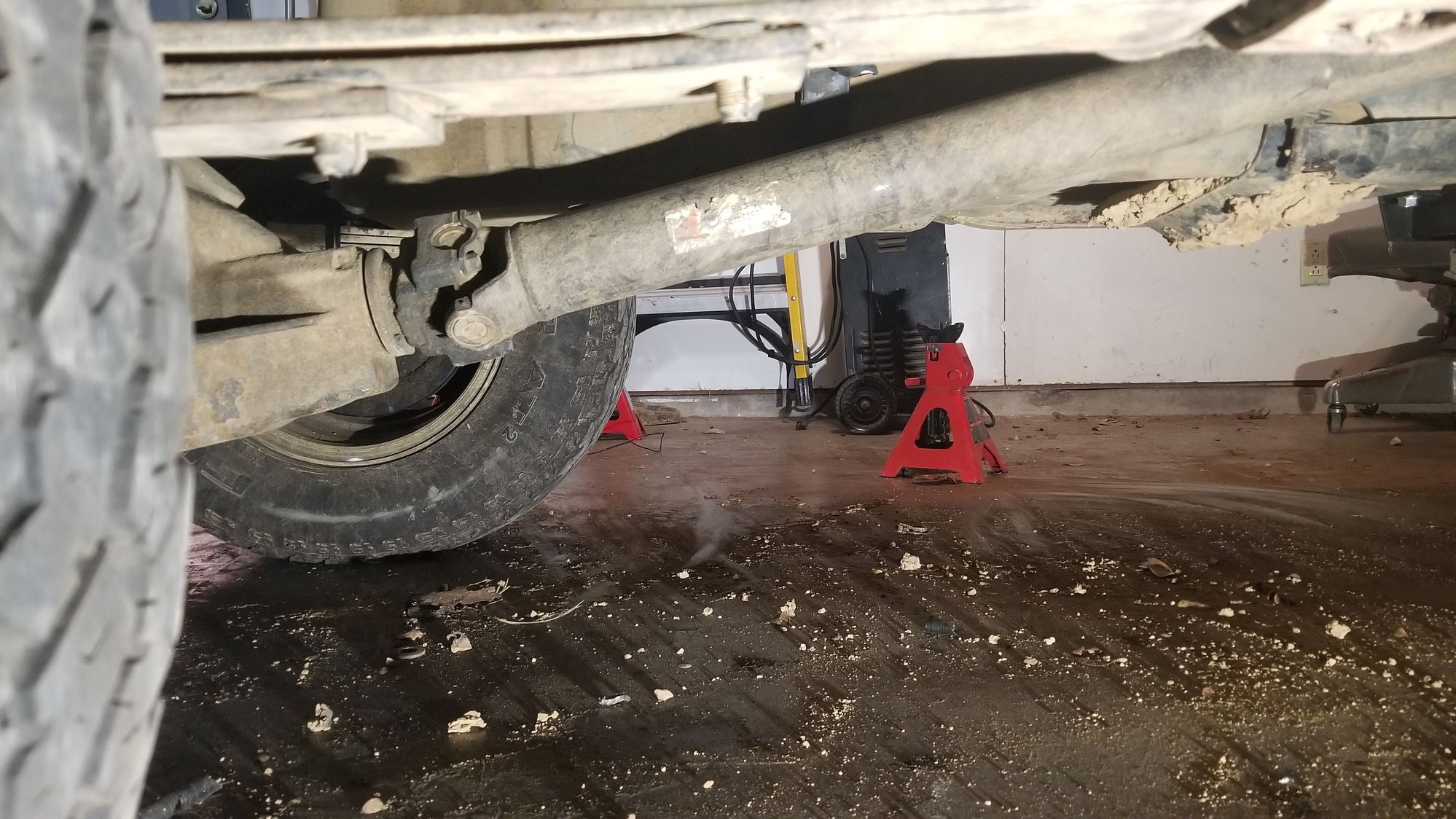

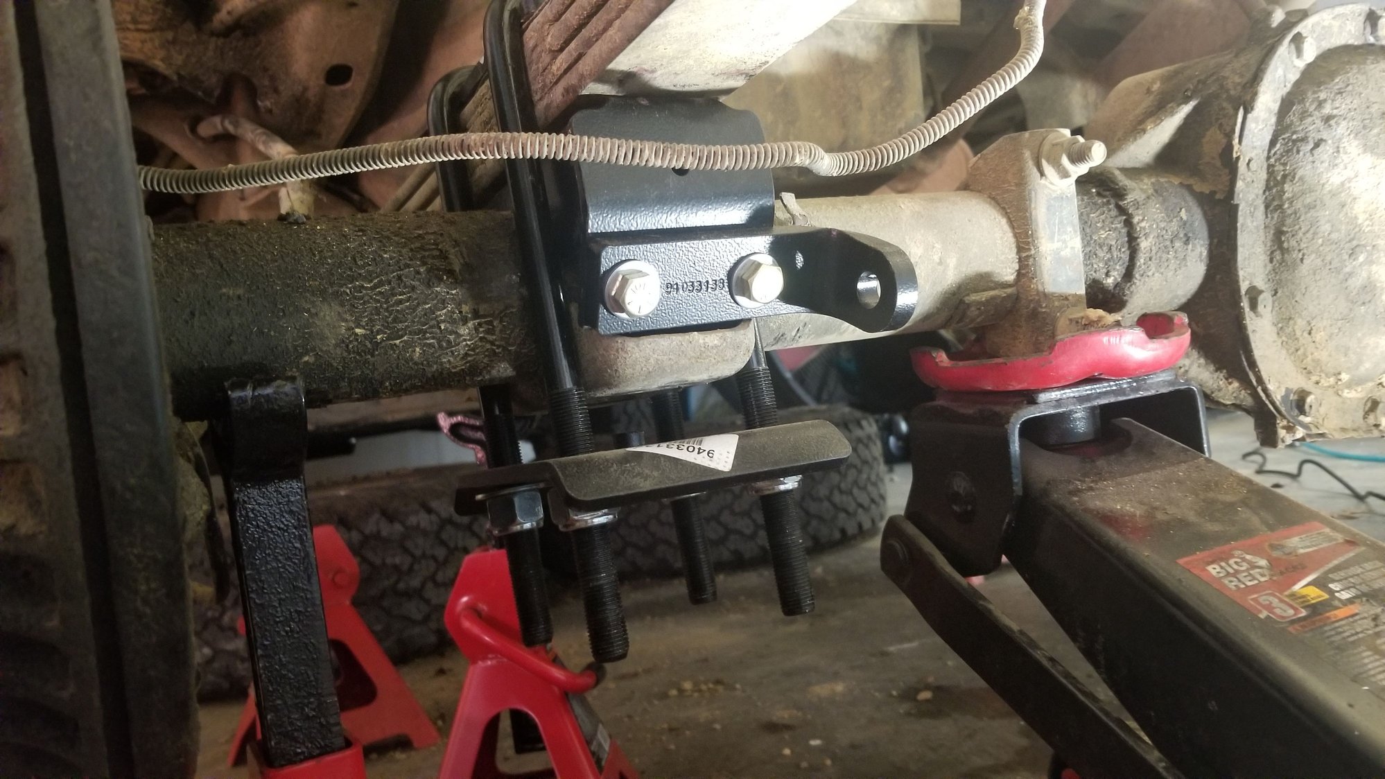

Support the diff, before dropping the leafs. I went ahead and put a jackstand under the driveshaft as well, since the diff wanted to roll forward:

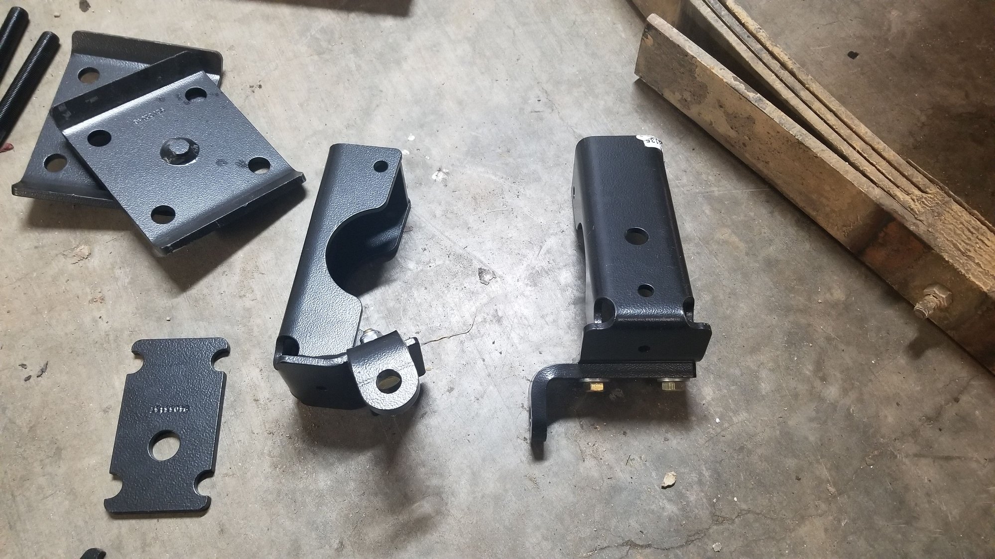

Assemble the spring perches/shock mounts like so:

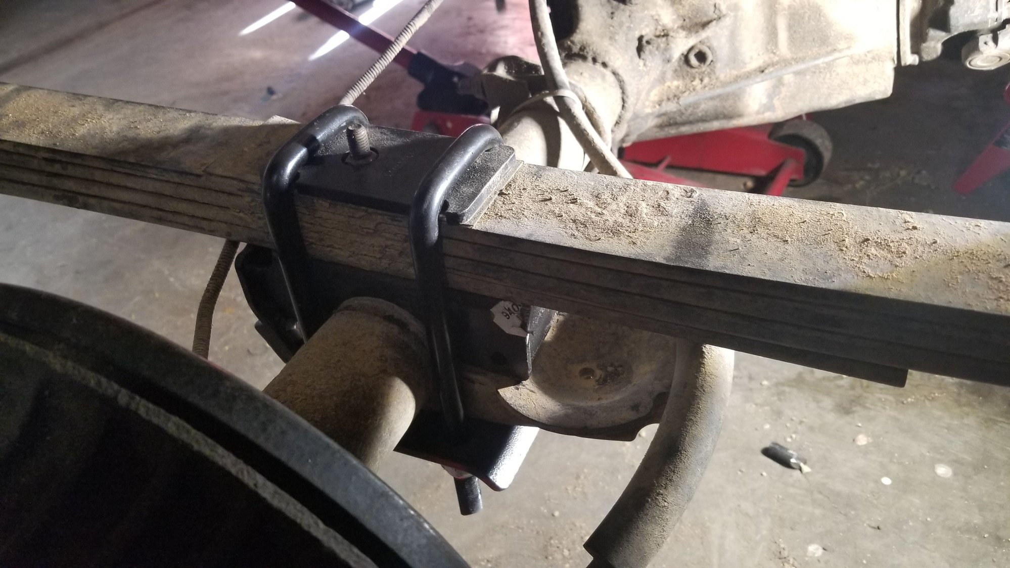

You will have to remove the leaf spring center pin, and install it upside down, since the leaf pack will now be on top of the axle. I had some janky C clamps lying around, they did the trick just fine:
I reamed out the u bolt plate a little since I was having trouble getting the new u bolts in it:
I had to cut this bracket to give me enough slack in the park brake cable:
Why? Why make the u bolts this long? Even with a deep socket, I ran out of socket. And with lock nuts, they have to be wrenched all the way on:
Screw that. I got a brand new Ingersoll-Rand reversible air cutoff tool for Christmas, and I ain't afraid to use it. I cut all eight u bolts short, and ran them in with my impact!
Fully installed:
Driveshaft angle doesn't seem too bad at the diff, but it's steeper at the front u joint. Hopefully it doesn't let go once I get the big tires on:
