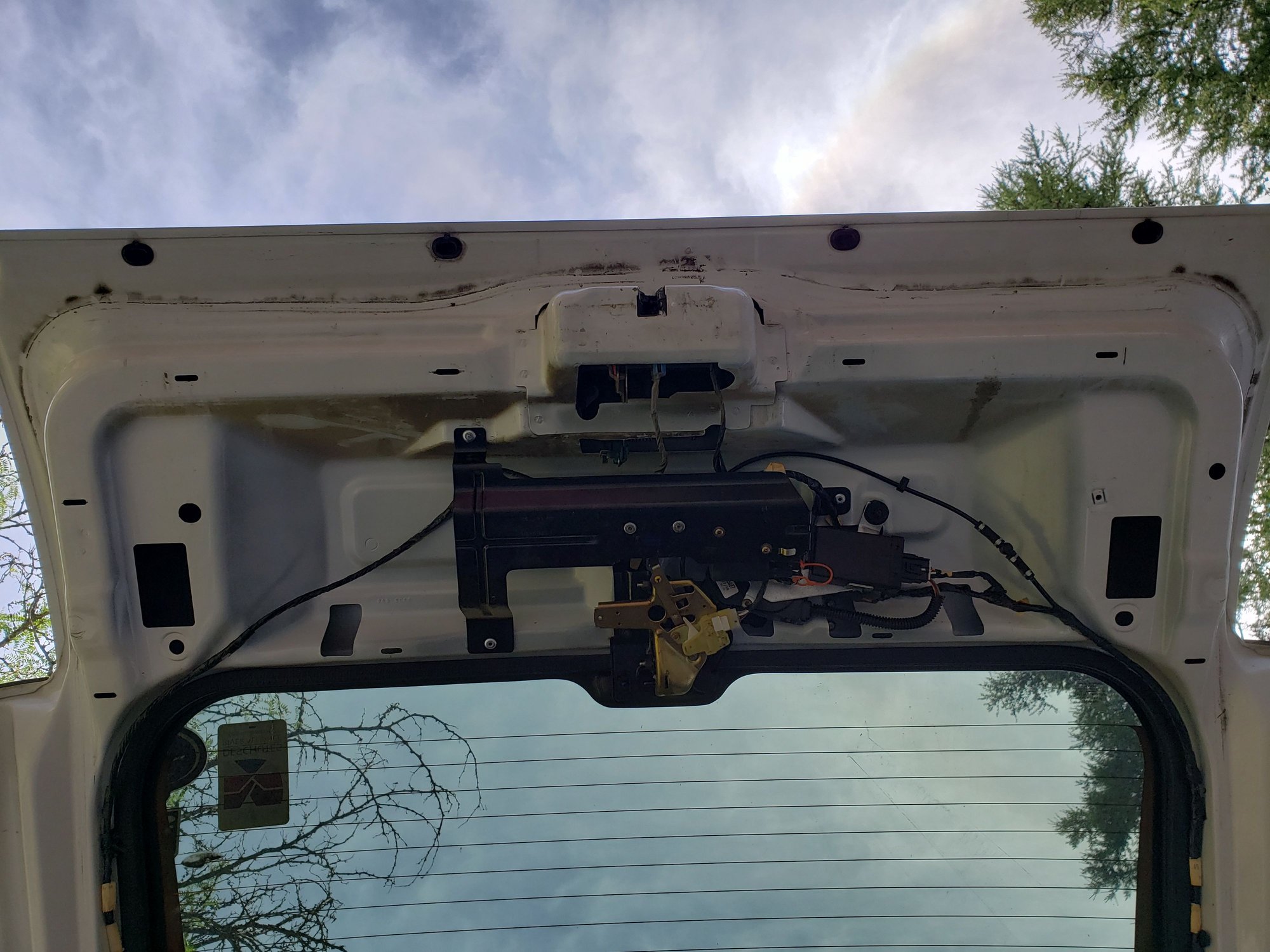

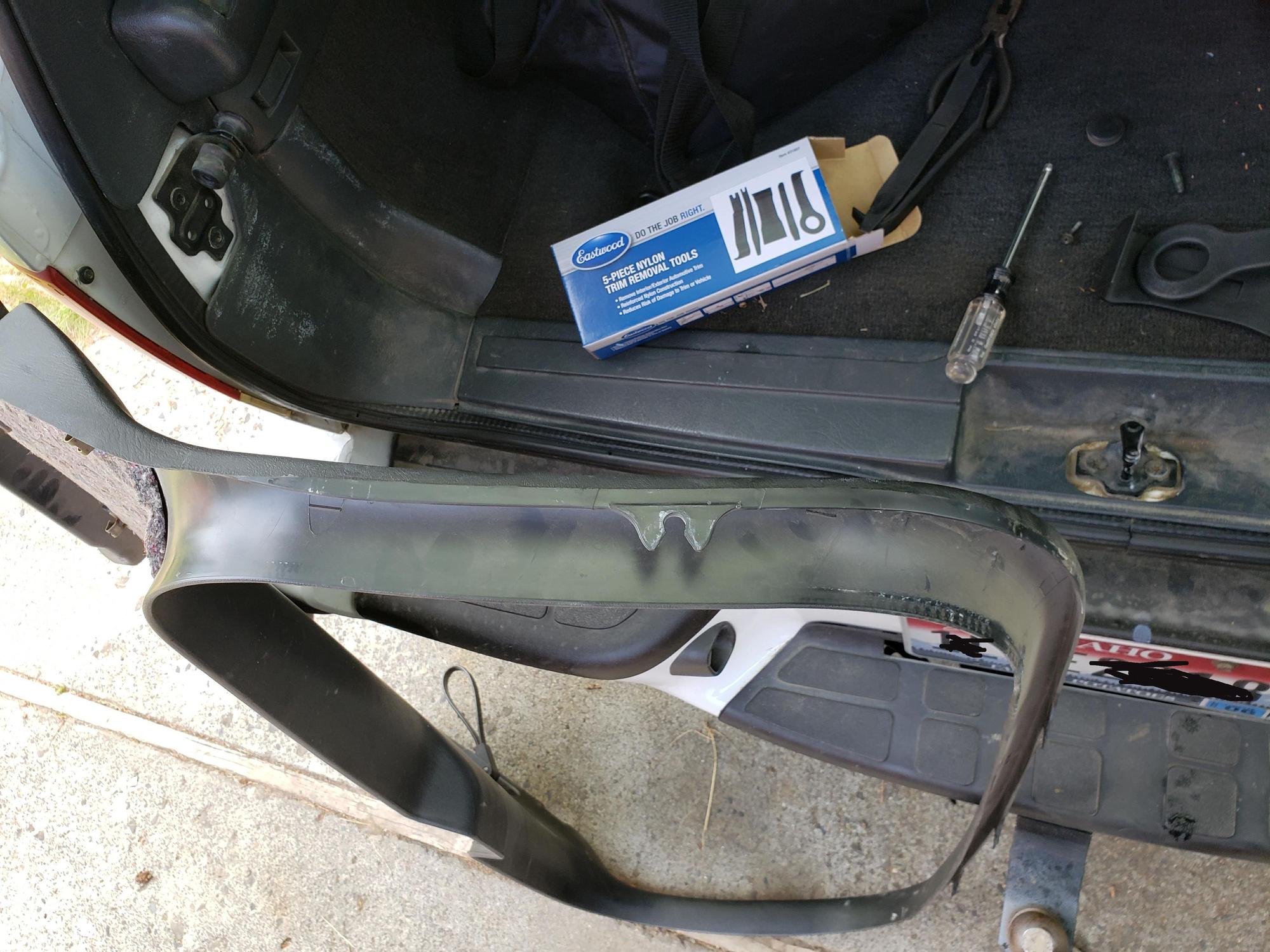

If you have a liftgate, then these pictures should help.
A few things to keep in mind:
  • There are two screws to be removed
    • one is for the pull handle on the lower passenger side
    • the other is at the locking mechanism at the center of the lower part of the opening for the glass
  • Standard trim removal tools will work fine on this.
  • The lower part has metal spring clips that go into slots in the metal.
  • Around the window, there are slots that engage plastic buttons by sliding laterally on to them.
  • It is easy to crack the plastic at the lower part of the side of the window when the lower part of the cover is unsupported.
Notice the metal clips for the lower part.
One of the openings for the buttons for the top part.
The openings for the buttons on the top
The little black dots are the buttons that secure the top part of the cover.
The lower panel. The slot openings are for the metal clips.
