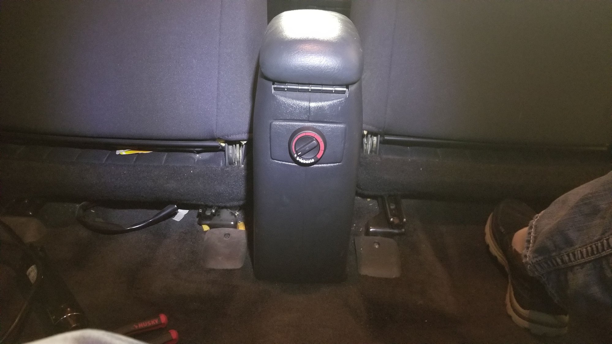

Hey I came across this and I thought I'd show my install of a webasto last winter. This is a 2000 Watt 12v gasoline heater, max electrical consumption is just less than 30 watts.
So far I've had it out at -15°C, was only running it at about 30%.
See pics, ask away.
