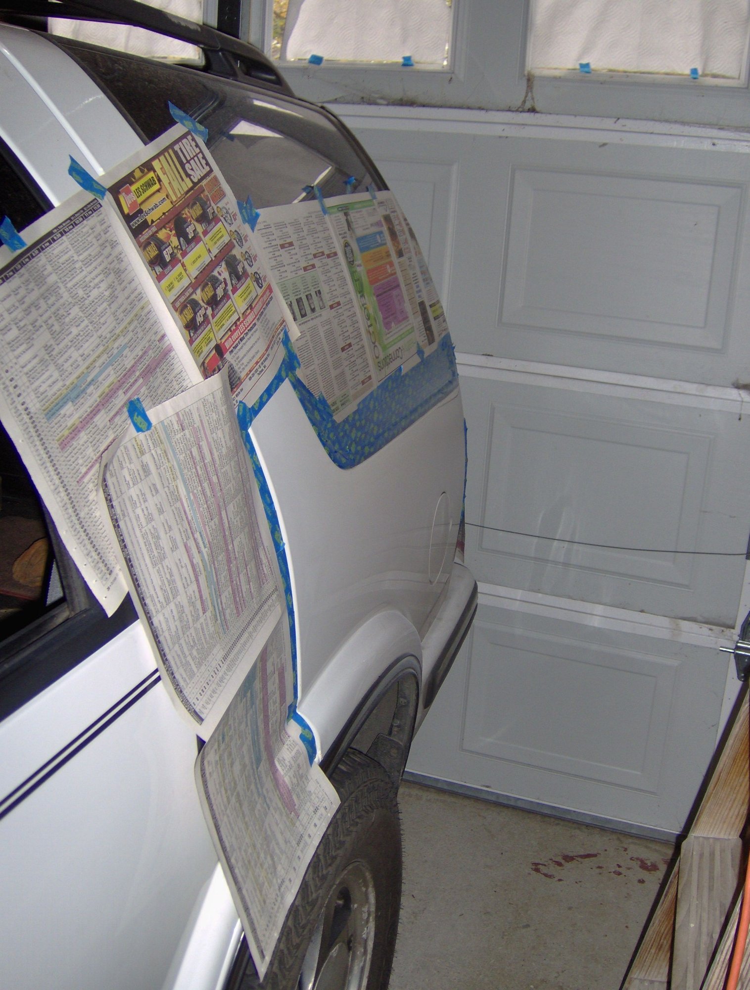

Is there still a layer of clear-coat between the over-spray and the original paint? If so, you can try what AJBert suggested and if you do go through the clear-coat, you could respray the clear-coat just where you need it.
I sprayed clear-coat on a panel to fix the clear-coat that was starting to peel at the base of a rear window. I was able to mask off most of the area but thought I could blend it using the spray can. Nope. But, where there was the clear-coat over-spray I was able to sand it down smooth again starting with 400 or 600 grit and finishing with 3000 or 5000 grit. I wet sanded and it got so smooth the water started to bead up!
It was a good lesson in fine sanding. Once I got things sanded just enough with the 400 or 600, it didn't take much sanding of each of the subsequent grits before I could move on to the next.
