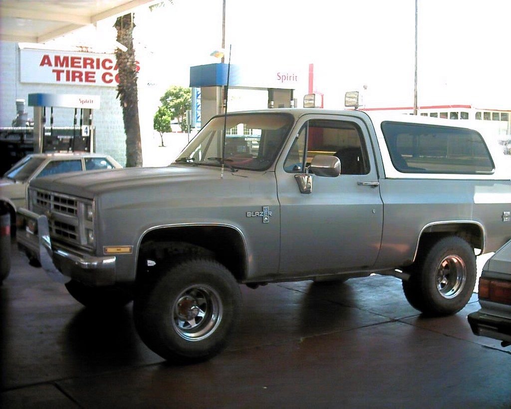

Here's the way I got this '86 K5 in 1997 - no rust
though - so that's good.
This is wearing the factory original tri-colored K5
235/75R15s on it and those are Chevy Rally
stock wheels - which I still have.
Sadly it had a trashed transmission and a busted
400 engine in it. I got rid of that stuff pretty fast.

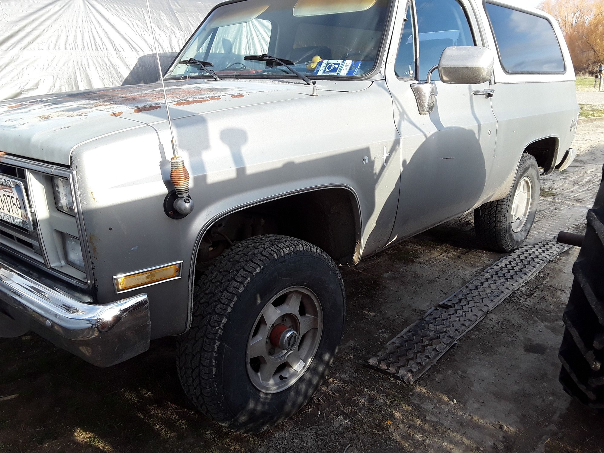

This is the second color that I shot it - but I didn't use enough hardener and it turned somewhat chalky - I lived with it until I fell in love with Case Tractor Orange....
.... and NO! That's not surface rust on it - it's a product of having this pix stored in the cloud and it got to looking bad.
I do have some serious tire-slinging-dirt-under the rocker problems though.
Those are 33x12.50R15s on it there.
Notice the hood ---> I didn't have time to prime it correctly and after living in Montana salted-snows and ice, you could see sunshine through the hood. This engine is a stroker 350 out to 383 - and frankly - it ain't worth it I feel.

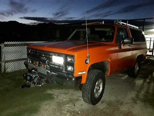

This pix was when the paint was 6 years old... and it had been keyed in WalMart, Hemet, SoCal.
I put a snowplow set of springs in the front and added stock dual shocks to all 4 corners.
A little blackout on the grill.... added LEDs in the side markers and tail lights.
The tires here are 265/75R16s here
If you look ---> you can see the texture on the body.
Those are 2001 Chevy 4WD pickup rims..... I use this K5 as a work vehicle and although I'm retired, I still get into some interesting
recovery/winching work and logging for my wood stove.
I tow over 10K lbs on my wood hauling trailer - most times in 4-Low and sometimes it takes all I got to get back outta the deep woods.
Oh yeah - I put straight cut gears in my transfer case. Noisy but powerful and a whole lot easier on the thrust bearings and the case too.
FUN FACT: You can use a new paint roller to apply this paint with the bed liner mixture. I did.
It flows out pretty good if you keep it from getting too hot for the first 24 hours or so, but I think the bumpy texture's great!
Oh yeah ..... it's orange.
