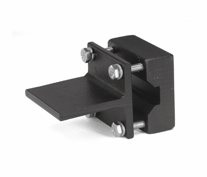

As for removing them, the instructions didn't mention any special too. However, I have a vague recollection of a tool that I saw in an old Dodge service manual for removing torsion bars. I think it consisted of two plates of metal with long troughs with semi-circular cross-sections so that when mated and bolted together would sandwich the torsion bar around its almost full circumference for about 8" of length. Then there was a 1" or larger diameter rod that was used for a handle that was mounted at the center of one of these plates coming out perpendicular to the surface of the plate. A hammer could be tapped against the end of the plates or perhaps the base of the rod/handle to nudge the torsion bar forward.
I've tried to draw what I'm talking about.
And of course just after I drew this, I found this tool: https://www.manciniracing.com/tobarreabceb.html

I beat on the end of the bars a little with a maul and a chisel and hit it with my air chisel for a while and it went nowhere. I was able to replace the mounts without removing the bars so I just put 'er all back together and called it another day in paradise. For reference on the mounts...the one on the left was easy to R&R but the one on the right needed to have the top stud cut down to get it in. It came out without any modification because it was in two pieces. I did have to pry up on the bracket with a crow bar to get it in there though.
