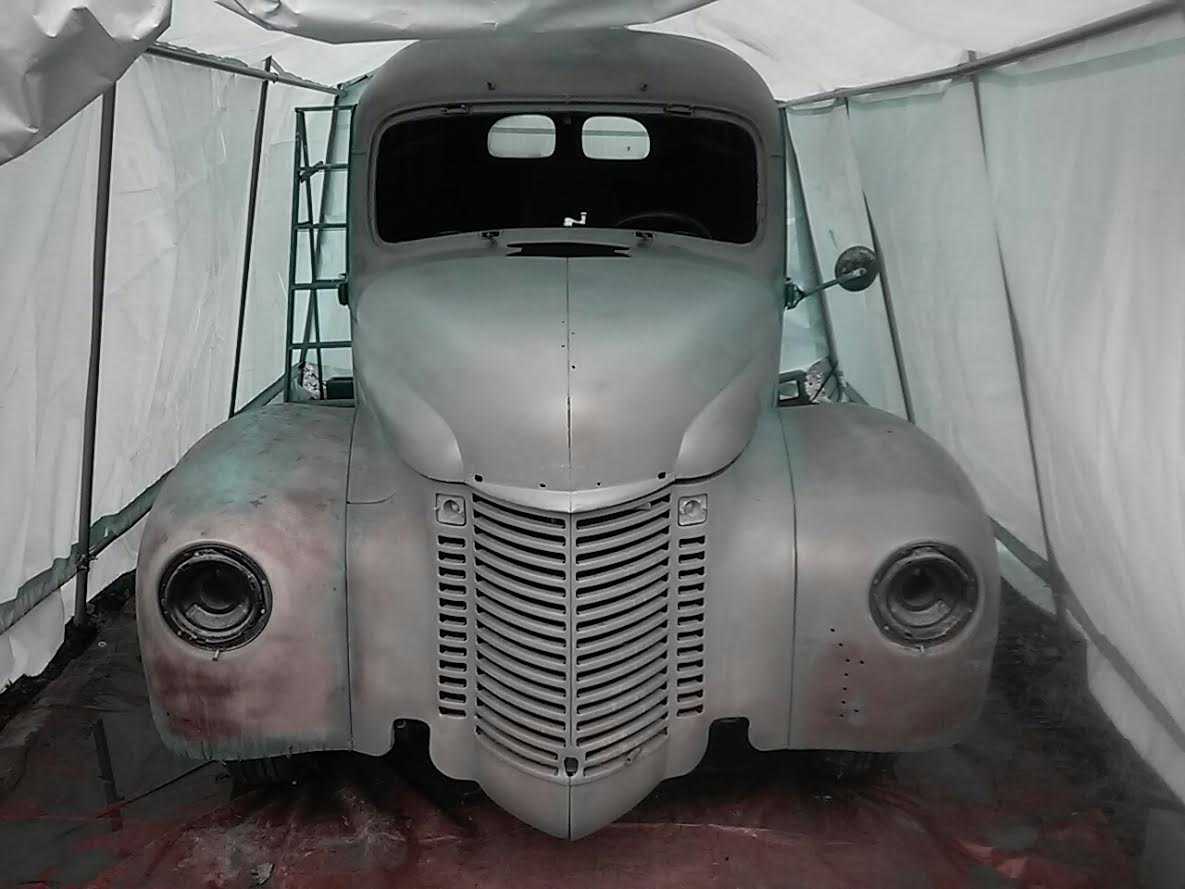

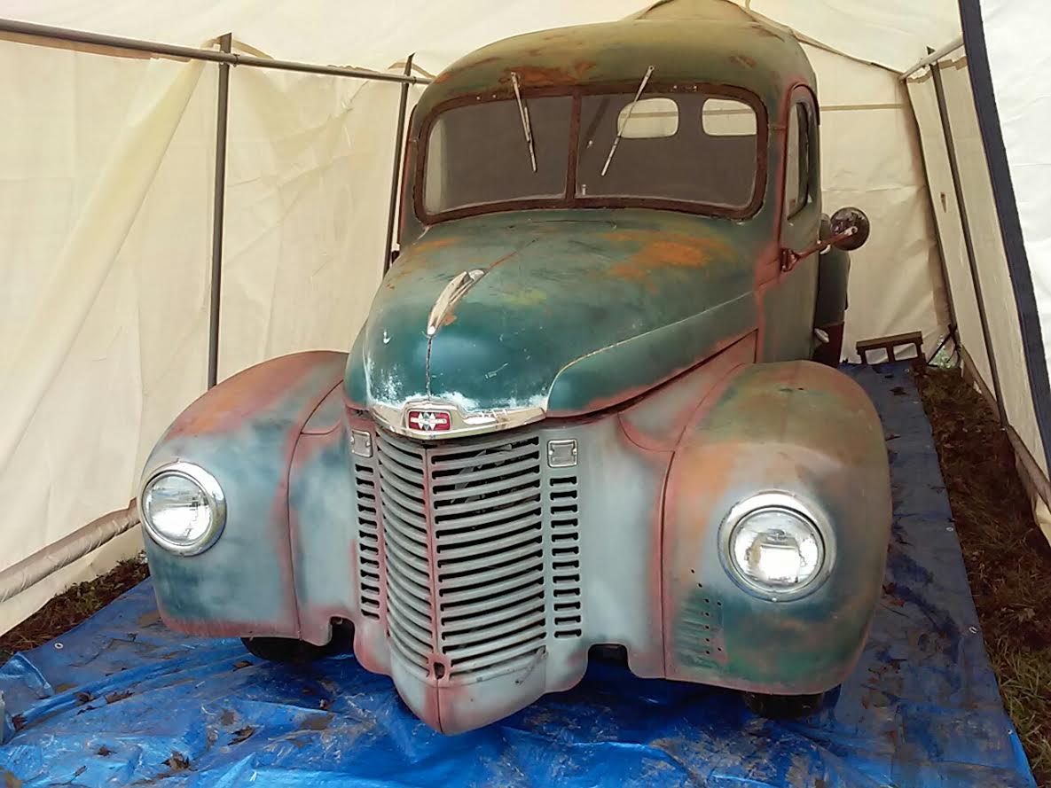

Old Apr 1, 2017 | 12:13 AM
I'd like to see photos of this creation
Old Apr 1, 2017 | 11:09 AM
VintageIron's Avatar
Joined: Mar 2017
Posts: 15
VintageIron is on a distinguished road
So far...
Attached Thumbnails Donor Interchangability-kbingarage1.jpg   Donor Interchangability-kbingarage3.jpg   Donor Interchangability-frame1.jpg   Donor Interchangability-frame5.jpg
