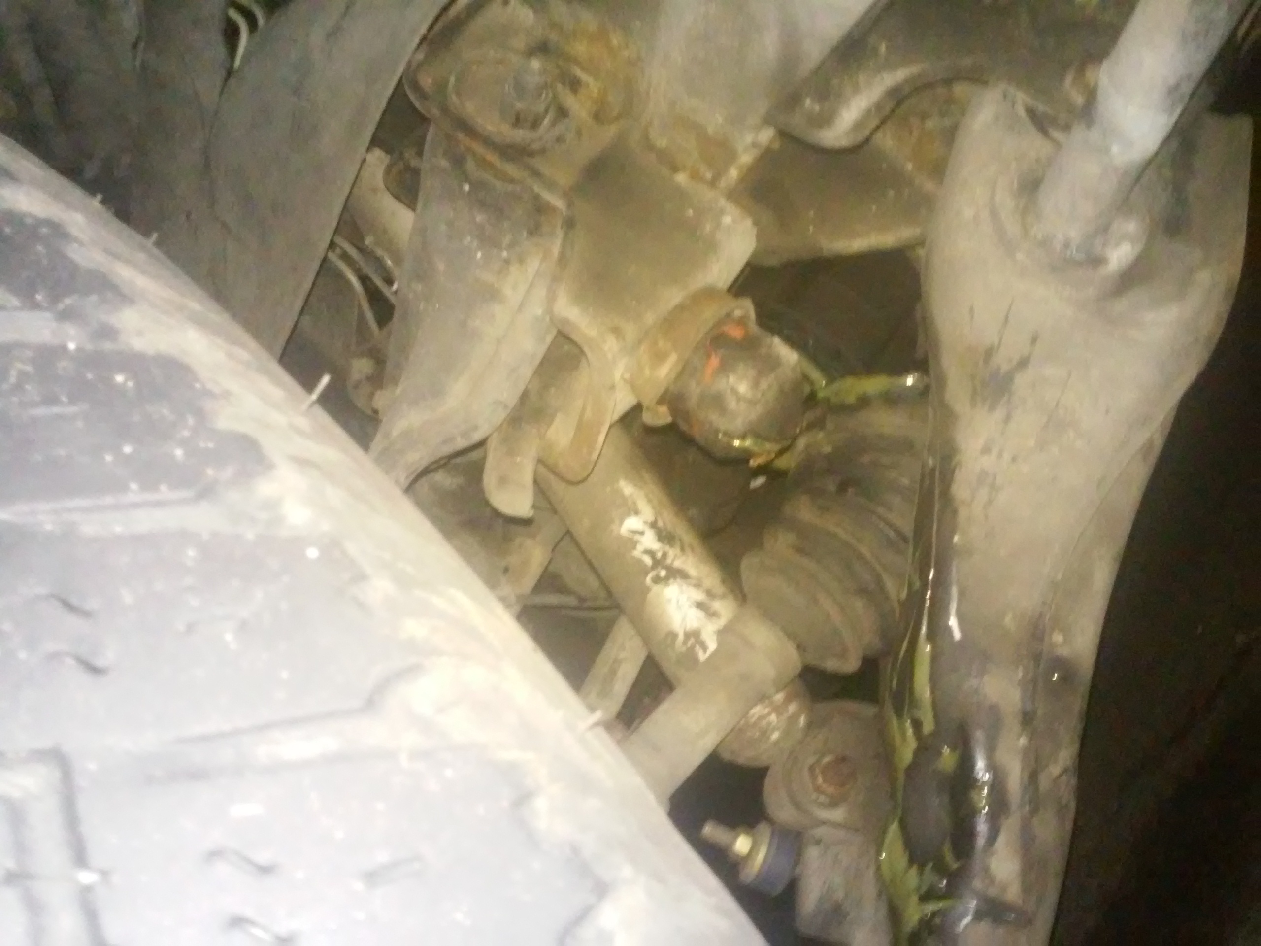

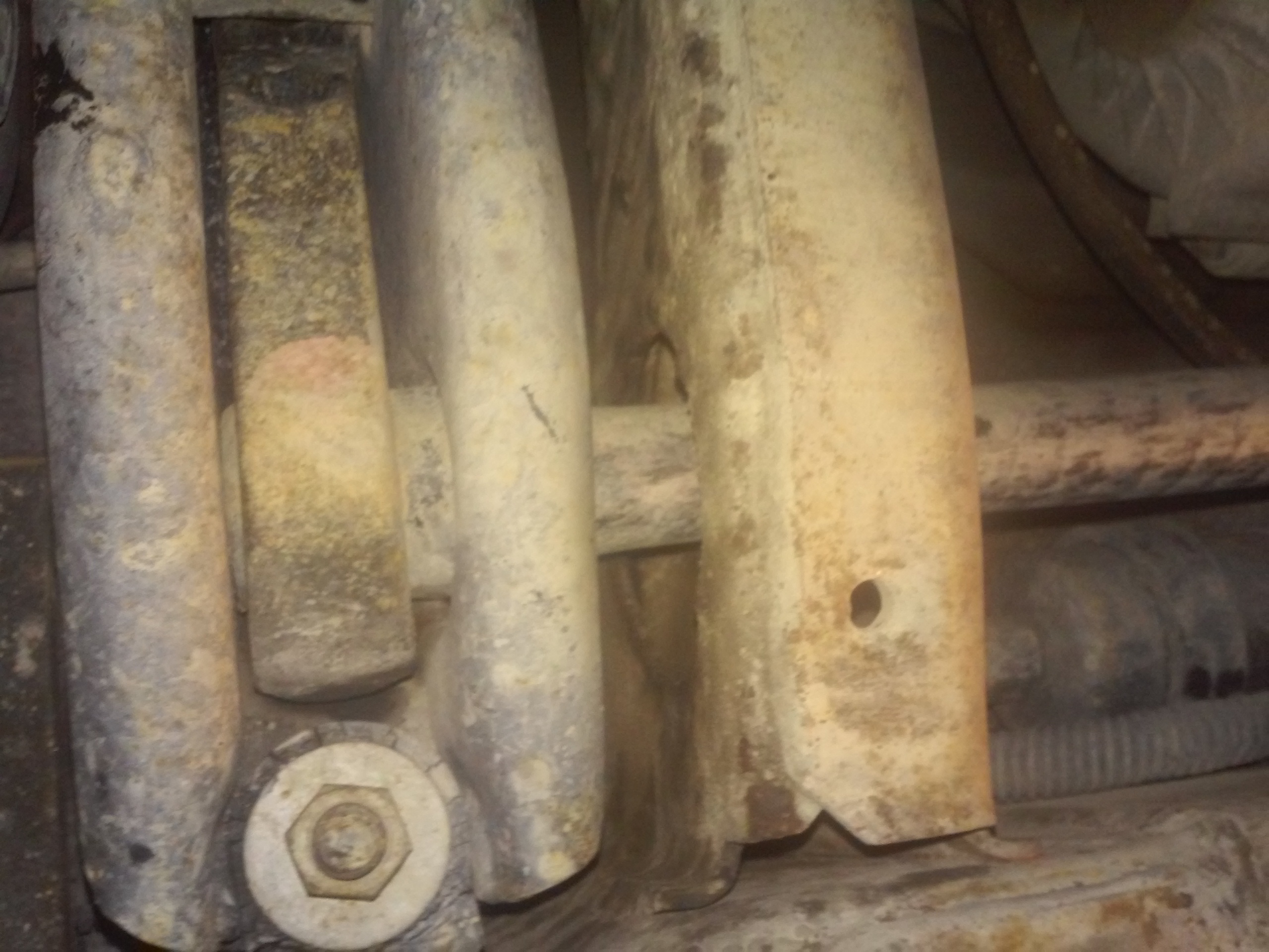

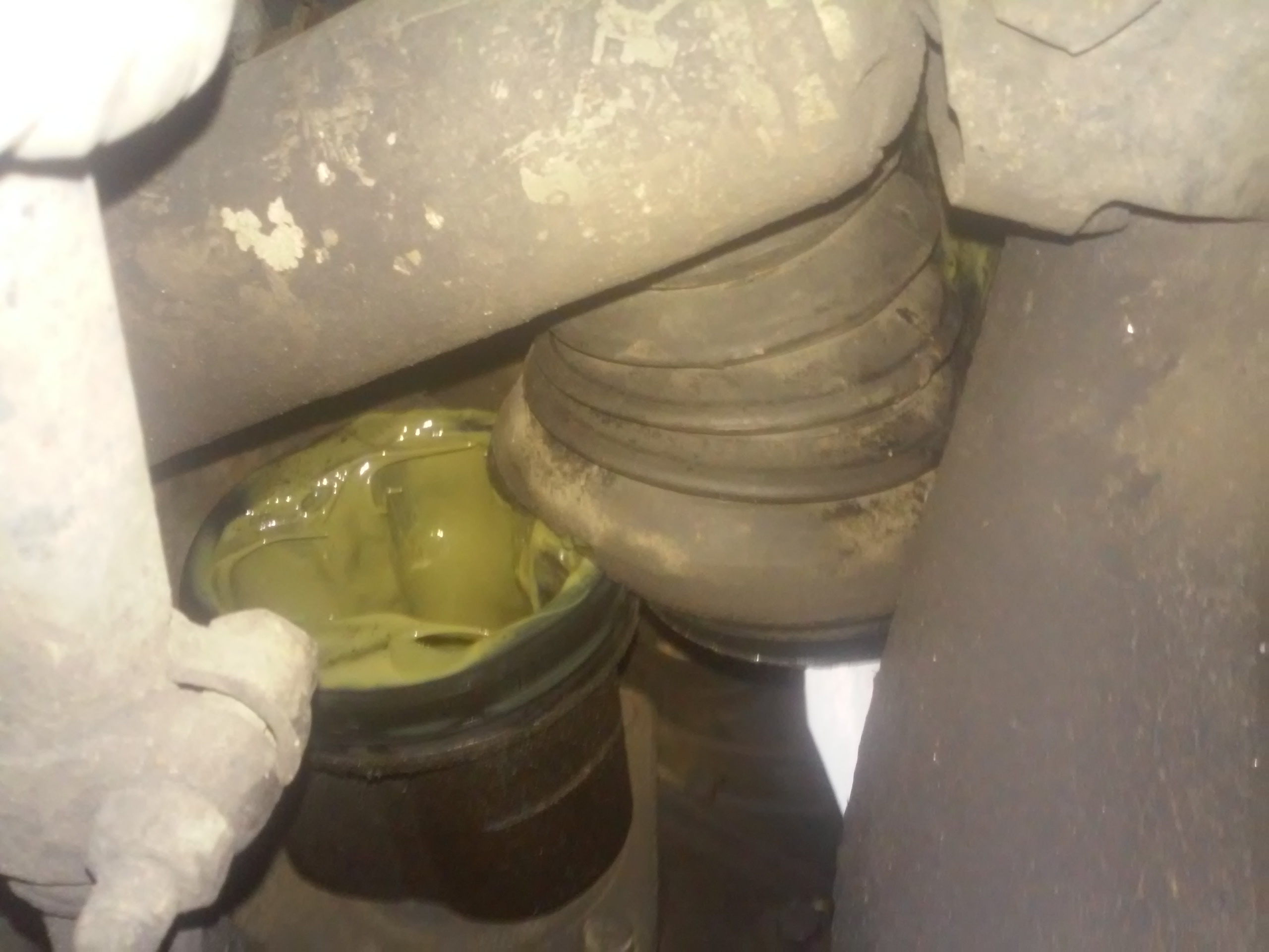

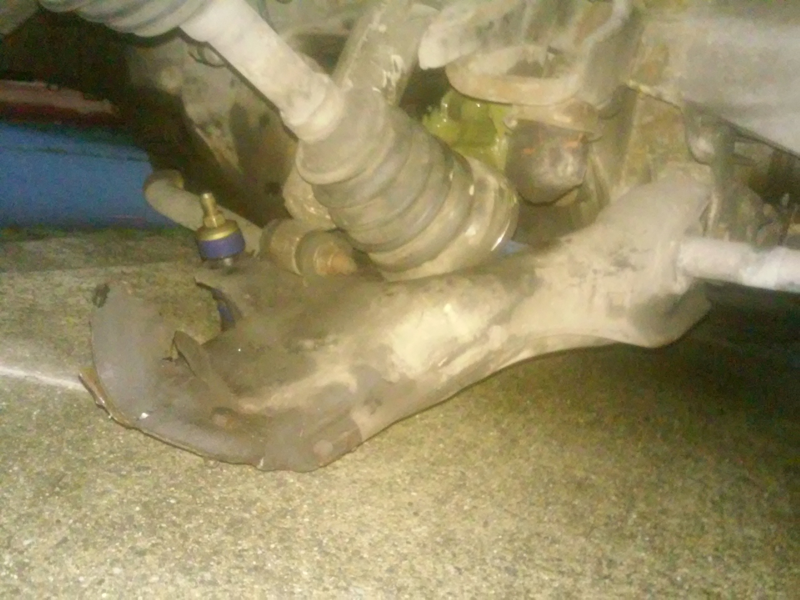

Can someone help me wit tha procedure, a step by step on how to change lower control arms for a 4WD 2000 chevy blazer. I got a Jack and two Jack stands. I'll post pictures of tha damage, that I'm happy it happened in a drive way and not on tha freeway.

Torsion bar unload tool. You can loan it from Autozone. Unload torsion bars and remove lower arm bolts (2x). Think they are a 21mm. New arms are available from amazon for a great price last I looked. Sway bar has to be removed to access front lower arm nuts

I was reversing out my drive way and tha front driver side control arm just snapped like a twig.
