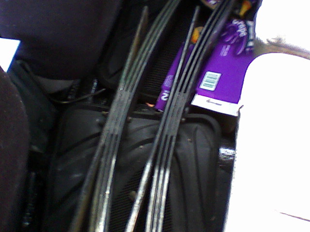

ok those are different than mine. but from what i see mine are stock. what i meant by not attached is demonstrated in the pic you provided. look at the very bottom leaf how it doesnt have anything on the ends of it attaching it to the other leafs. but the top 4 in your picture have a thing holding them together.

the lowest leaf in the pack IS attached via a central bolt, but it sits flat instead of curving with the other 2 pack springs and the main spring
pics to follow... hang on one
And here you go...
these are 2 Z85 srpings on the floor of the blazer
VVVVV
