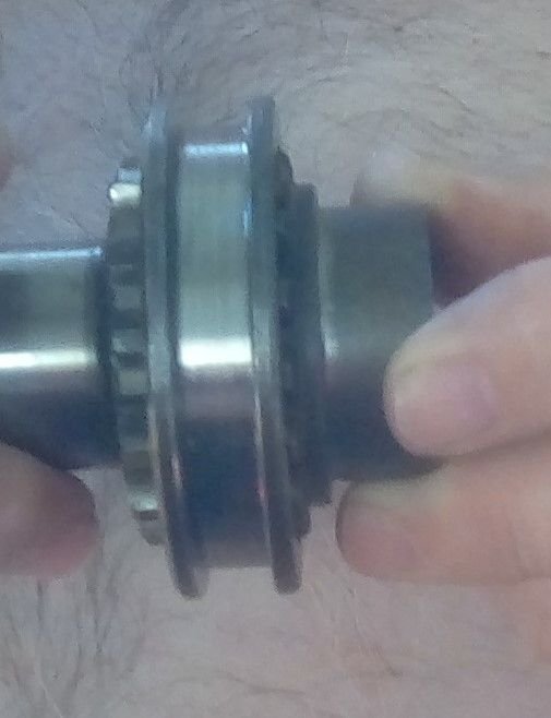

Here are the pics of my gear:
How much of the slide collar is supposed to fit over the gear when it slides over it?????
Is it all the way or just part way like the way it is worn down??
