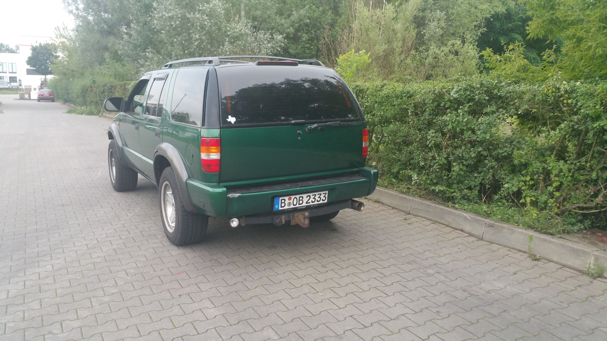

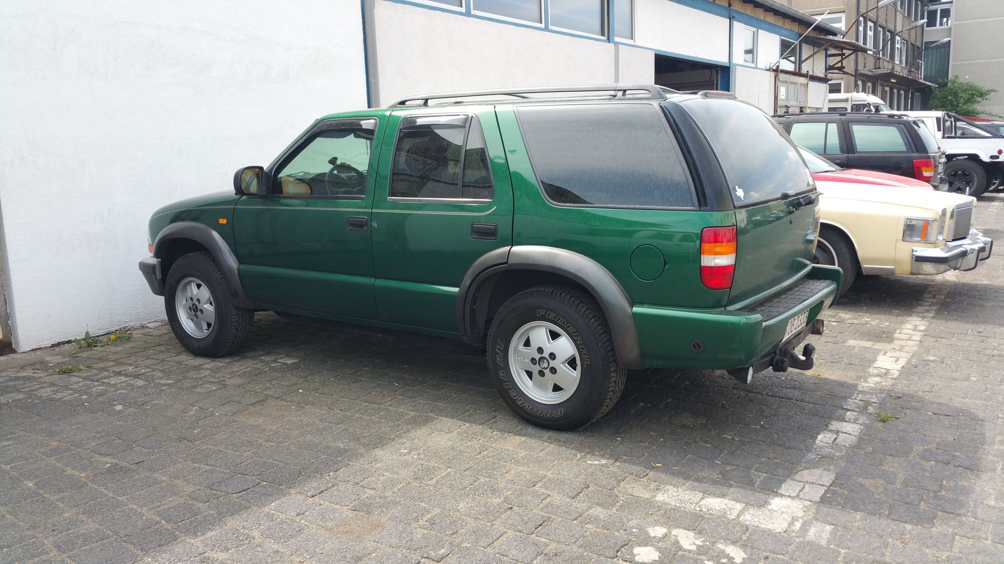

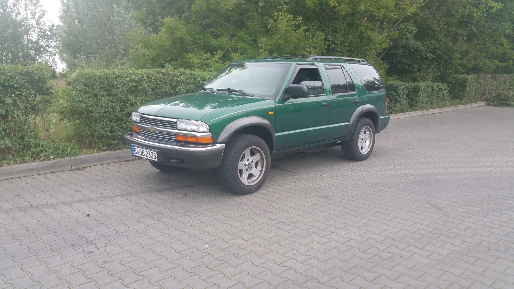

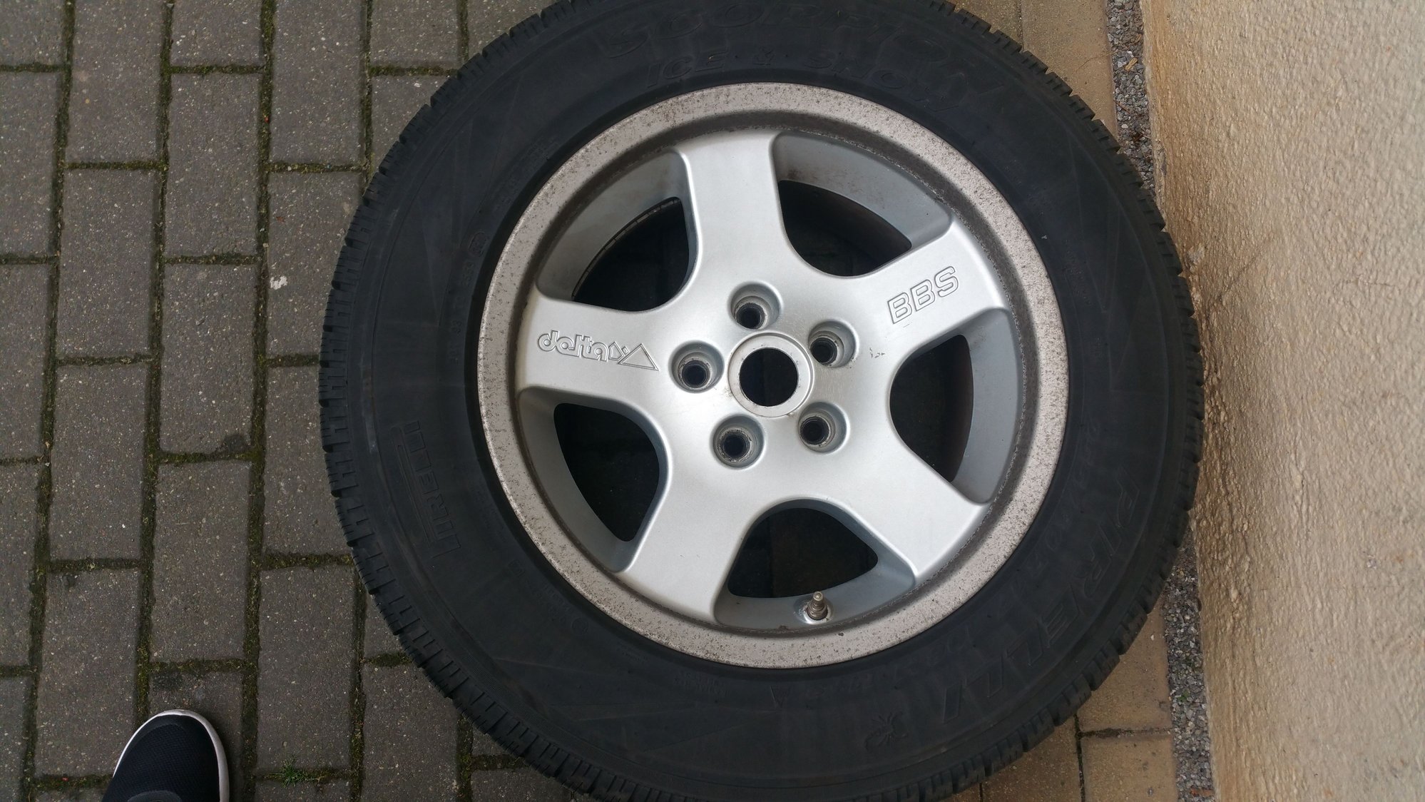

Work done!
The rims fit, but I had to replace the glue sticked balance weights on the rims with clamped ones. Otherwise the brake would have scratched the sticked weights from the rims.
Next step will be wheel spacers (10mm on each front wheel and 30mm on each rear wheel).
And now some pics.
Custom rims are BBS Delta, usually produced for BMW with 9 1/2×17H2. Have had severe problems with steering, traction, etc. And no certificate for my Blazer. So I had to remove them. Now with the Federal Couragia A/T on these factory/OEM rims I can go much further. And I will have less fuel consumption and less problems with steering, worn out bushings and so on.

Looks good! I also like the turn signal markers on the sides. Had thought about doing something similar to mine.

I noticed your bumper is a 1995-'97 styled bumper, in the US at least. Might be a European thing? Like the taillights. Those are awesome! I've only seen that style in pictures.
Those Beemer rims are sharp, too.
Nice rig all around.

Due to many "senseless" laws , Blazers made for Europe have these front and rear bumpers and rear lamps. Turn signal on the rear needs to be orange, only a few exceptions drive around with red ones. Same with orange sidemarkers (need to illuminate clear/white). So, there are a few differences.
Would like to add a lot of aftermarket accessoires, but I always need to check, if there are any regulations/restrictions here in Germany.
