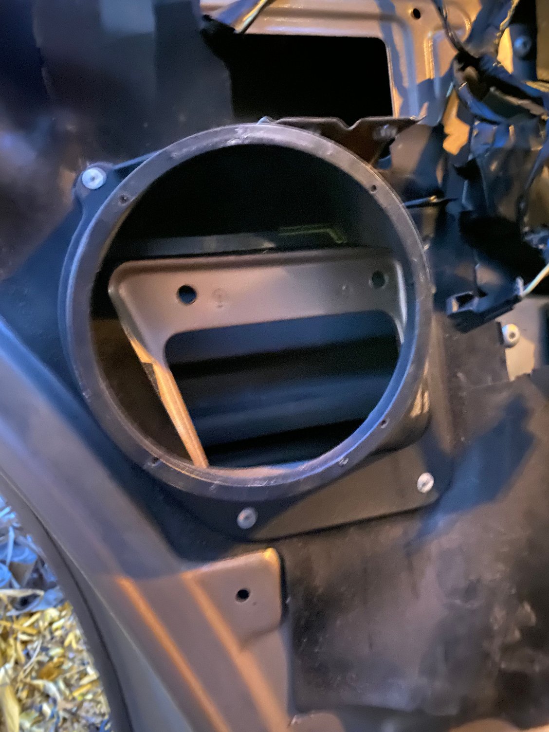

Hey y’all I’m upgrading the audio in my 4D blazer and I can’t find the right set for the rear. I have the
Boss RAGE BE654 in the front and I’m trying to find similar for the rears, but the BE654 doesn’t fit the rears and I tried the Boss RAGE BE524 and they’re too small.
here’s a photo of rear speaker Cavity.
